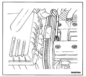

Mu check engine light is on, so I got it tested to find out it was my camshaft. How bad of a problem is this and what is the least expensive solution?
Jan 29, 2010 at 2:59 PM
  • 75,992 POSTS

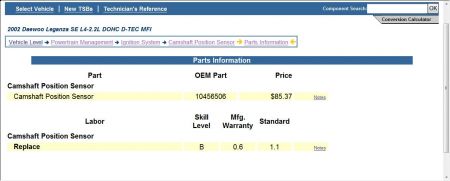

Hi mo1229, Welcome to 2carpros and TY for the donation I believe they refering to the camshaft sensor not the camshaft itself bcuz of the CEL-you might want to check the wiring if okay replace it-See quotes
https://images.2carpros.com/forum/automotive_pictures/12900_cam_12.jpg
Notes Removal Procedure
https://images.2carpros.com/forum/automotive_pictures/12900_c1_20.jpg
Disconnect the negative battery cable. Remove the engine cover. Disconnect the sensor electrical connector.

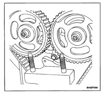

https://images.2carpros.com/forum/automotive_pictures/12900_c2_18.jpg
Remove the timing belt front cover. Refer to DOHC Engine Mechanical. Remove the camshaft position sensor bolts. Remove the camshaft position sensor from the top. Installation Procedure

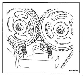

https://images.2carpros.com/forum/automotive_pictures/12900_c3_9.jpg
Install the camshaft position sensor and bolts. Tighten Tighten the camshaft position bolts to 8 N.m (71 lb-in ).

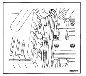

https://images.2carpros.com/forum/automotive_pictures/12900_c4_5.jpg
Install the timing belt front cover, the crankshaft pulley, the accessory drive belt, and the air filter. Refer to DOHC Engine Mechanical. Connect the sensor electrical connector. Install the engine cover. Connect the negative battery cable.
