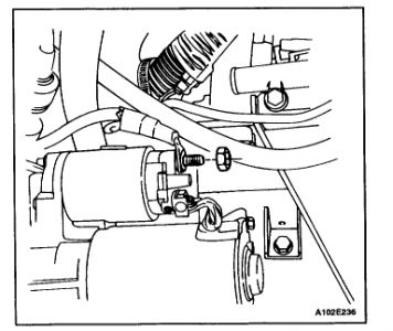

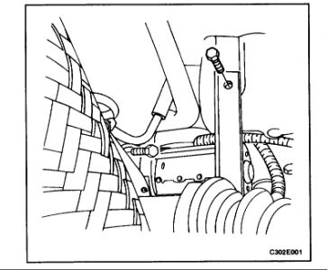

I need to Find out how to take off the starter on my Daewoo
Jul 6, 2010 at 5:11 AM
  • 75,992 POSTS
Removal Procedure
https://images.2carpros.com/forum/automotive_pictures/12900_d1_8.jpg
Remove the engine intake manifold-to-engine block strap bracket over the starter. Remove the starter-to-transmission mounting bolt. Remove the starter-to-engine block mounting bolt.
https://images.2carpros.com/forum/automotive_pictures/12900_d2_7.jpg
Remove the starter solenoid nuts to disconnect the electrical cable. Remove the starter assembly
