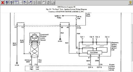

was driving car and it just turned off couldnt start anymore after checking .it has no spark to plugs.

Check fuse EF16 20amp and test the crankshaft position sensor
