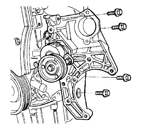

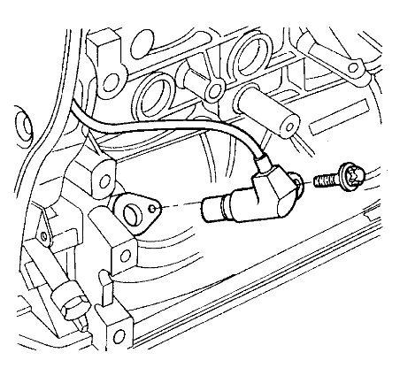

Quick question, Having same problem with 2000 daewoo leganza. Where is the crank sensor located? And how do I get to it? Can't find a diagram online.
Jan 22, 2013 at 11:01 AM
THIS IS MIKE
  • 686 POSTS
The crankshaft position sensor is located on the block under the power steering pump if so equipped. You have to remove the air conditioning compressor and the A/C mounting brackets. Then remove the accessory mounting bracket. You will be able to remove the crankshaft position sensor connector to access the retaining bolt. After removing crankshaft position sensor carefully remove the sensor by rotating it while pulling it out.
