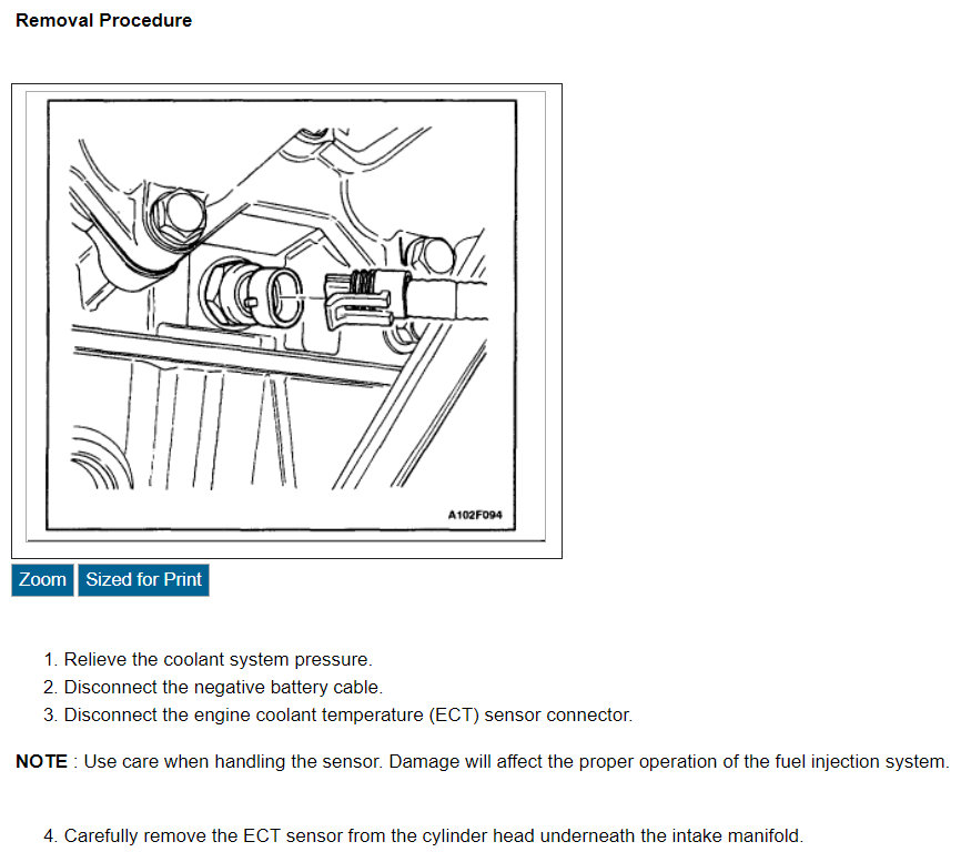

I need to replace the temp sensor and can not find it. Can you please tell me where it is located so I don't have to take off anymore PLASTIC parts then nessecary?

The engine coolant sensor is under the intake manifold here is a guide to help you see what you are in for when doing the job and diagrams below to show you the location for you car.
https://www.2carpros.com/articles/coolant-temperature-sensor-cts-replacement
