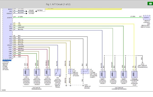

Error Code 70-03 - A/T system malfunction. A shift solenoid valve "a" stuck off 3. Shift Solenoid
What is this telling me and how do I fix it. I tried to find the solenoid A but could not locate it on my trans (v-6). Is it serious or just a malfunctioned solenoid?
Jul 9, 2013 at 8:44 AM
  • 55,433 POSTS
Hey LON1952,

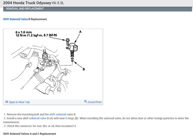

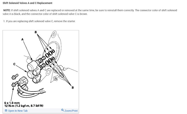

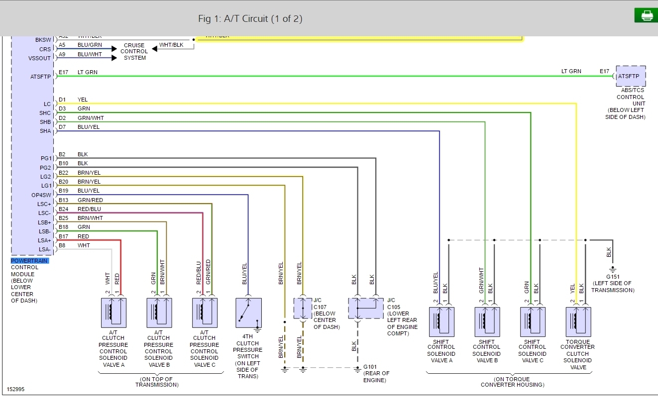

Yes you need this solenoid to work. I found the locations for you in the diagram below. Check out the diagrams (Below). Please let us know if you need anything else to get the problem fixed.
