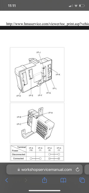

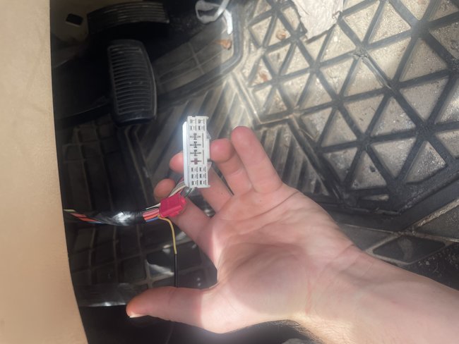

I’ve figured out which harness is responsible for blowing the fuse but now I need help figuring out how to determine which wire is bad on that connector to trace it out.

I’m still not very far with the problem but I was able to determine the exact harness for y’all. Also, I think you should know, that when harness IP/J is unplugged, the D/Clock fuse doesn’t pop at all. But I lose my dome lights, driver side windows, power locks for the driver's side, power mirrors, and my fuel door button as well, however when that harness is plugged in everything works when the fuse does pop except for my radio and power mirrors. Any further advice would be much appreciated.

Have you tried disconnecting one component at a time to see if you can find the one that is causing it to fail?
Let us know.
