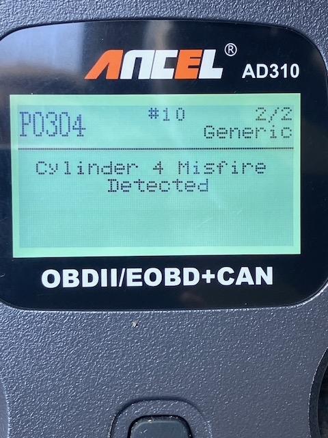

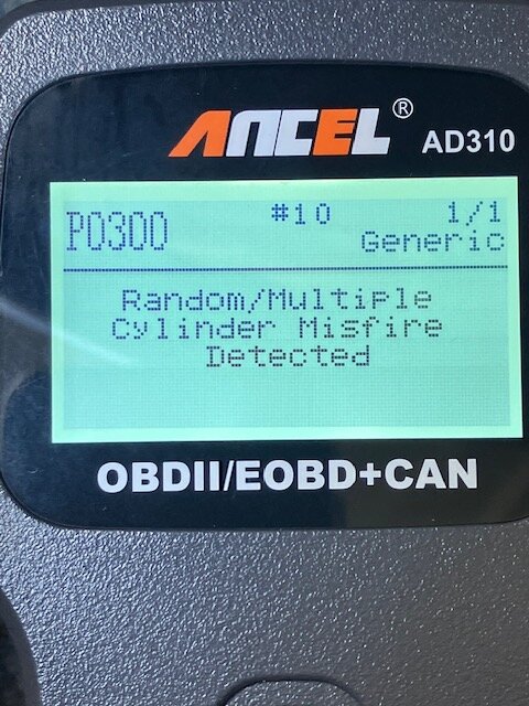

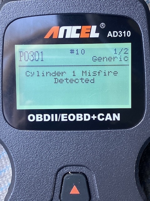

Problem occurs when RPM is higher than 2750
Problem started up immediately after replacing the AC compressor, harmonic balancer and serpentine belt.
I had replaced the spark plugs this past March along with air intake filter, and MAF in order to pass the required smog check.
I have now replaced the spark plug wires and the ignition coils.
There is no physical manifestation of the misfire. Engine runs smooth, no apparent lost of power.
Check engine light appears and then disappears. Reading the error codes indicates:
Random misfires all cylinders
Misfire cylinder 1
Misfire cylinder 4
1999 Mazda 626 ES 2.5 litre V6
Any suggestions where to look next?

Best thing to do now that its running smoothly the actual codes might be old id erase them at this point and wait to see if they come back they might not after youve done the work thats said "
Heres a few Things to check that can cuase or at least contribute to a mutible random misfire you might have already checked some of these .. first and formost the coil for 1 and 4 where your getting the misfires is a single coil running both cylinders 1 and 4 on this vehicle you said its been replaced but It might be defective if it keeps misfiring depending on where you purchased it and check the ground and all other wires and plugs leading to the coil..and also ..is there any chance you might have damaged the reluctor ring mounted to the back of the harmonic balancer vary important if a tooth is evan slightly bent or damaged in any way it can cuase this especially at high rpm but not so bad at lower rpm ..and or damage to the crank sensor plug and wires down there while working with the hamonic balancer ..check these too

Problem resolved after much troubleshooting. Thought you would like to know what rectified the issue. The mechanic ran a bunch of tests then decided that a computer reset might be needed. He did the reset procedure and the misfires vanished. Somehow replacing the harmonic balancer triggered the issue but resetting the computer rectified it.
