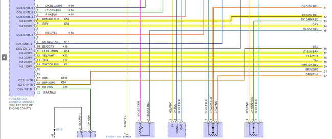

Cylinders 2 and 6 circuit malfunction
2004 JEEP LIBERTY
227,000 MILES • 3.7L • V6 • 2WD • AUTOMATIC
JEREMY09

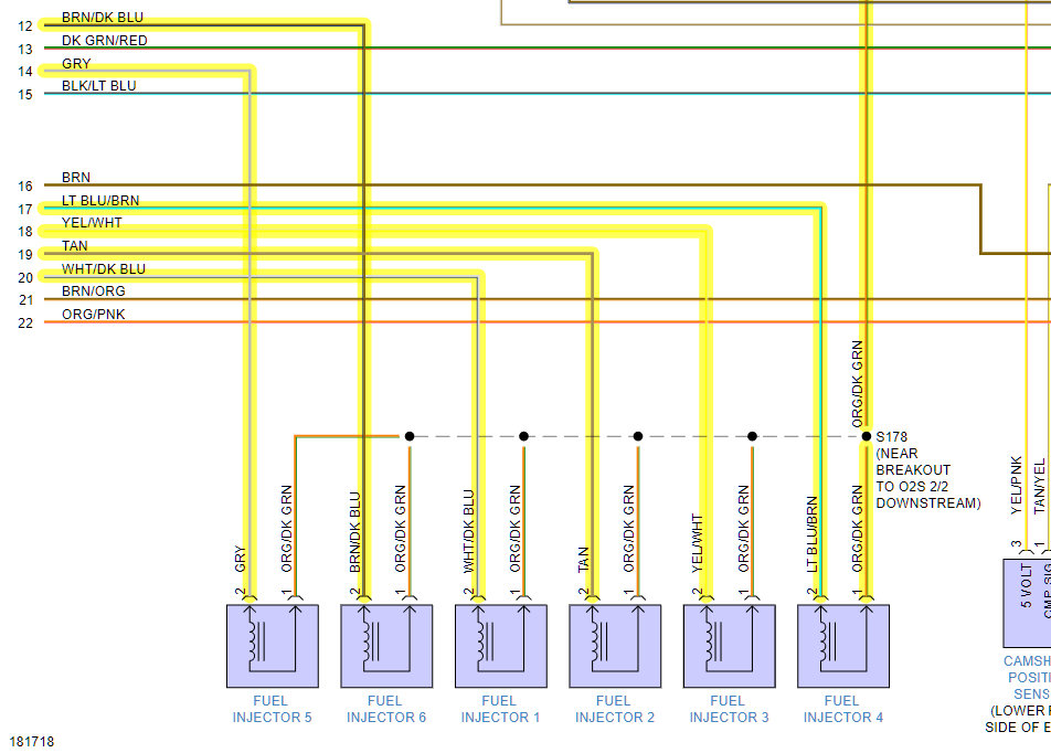

I need wiring diagram for the injector circuit.
May 6, 2022 at 9:15 AM
AL514
  • 5,587 POSTS

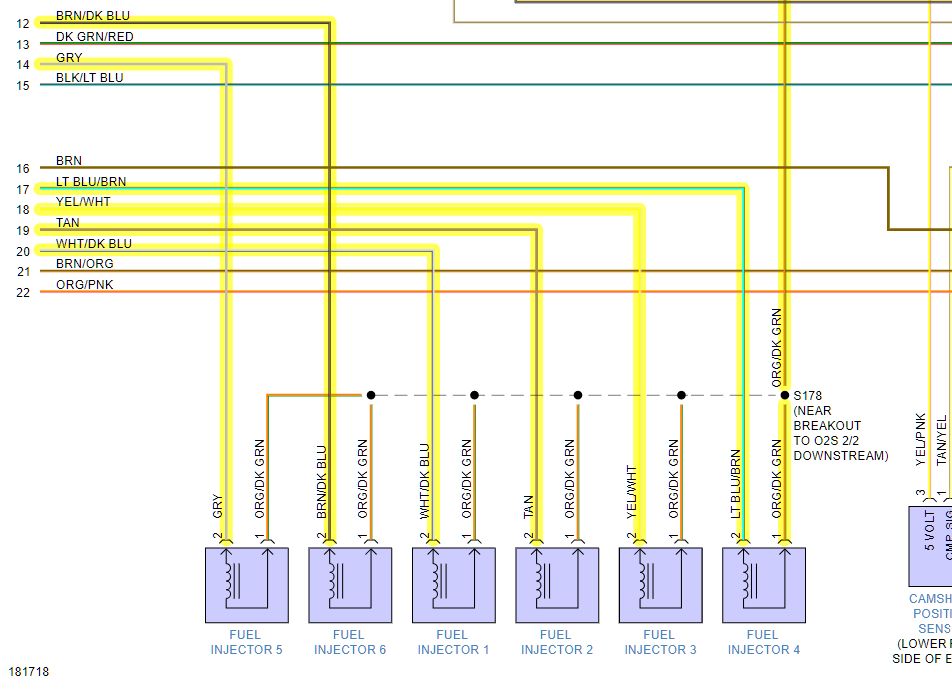

Hello, here's each injector (first page) and where they meet up at the ECM connector C2. If you need anything else, just let us know. The orange/dark green wire is the power feed. (12v)
The resistance spec for each is 10.8 - 13.2 Ohms.
