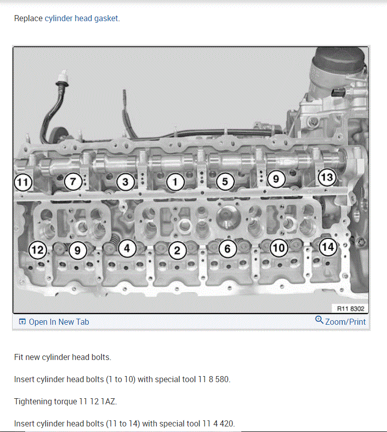

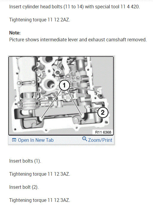

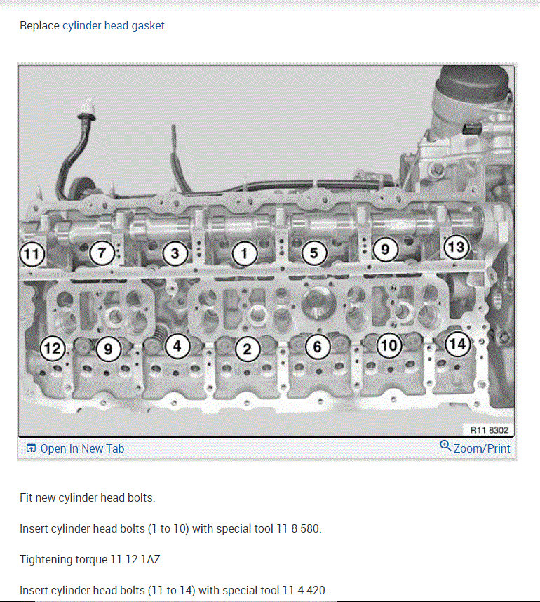

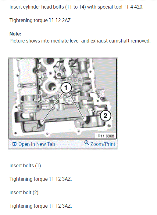

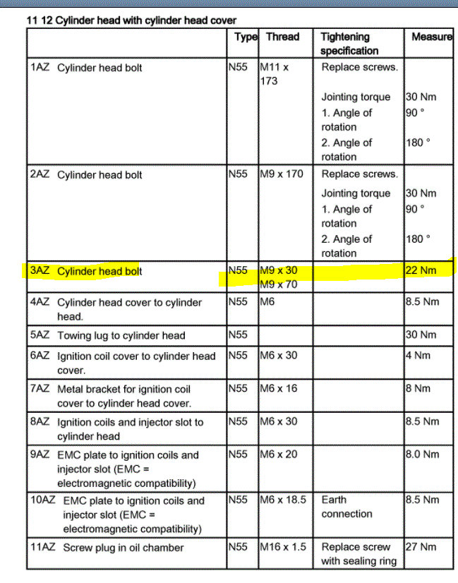

i'm rebuilding the motor.

If you look at the attachments below, they provide the procedure and torque specifications for this vehicle. Let me know if this is what you needed.
