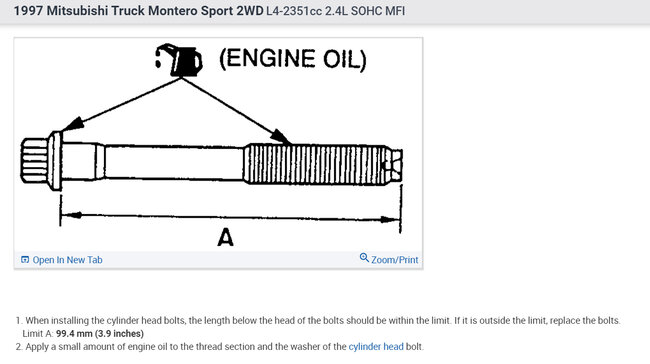

I want to know the cylinder head bolt torque specification on the vehicle listed above junior Pajero 4A31 engine.
May 30, 2023 at 6:46 PM
  • 55,219 POSTS

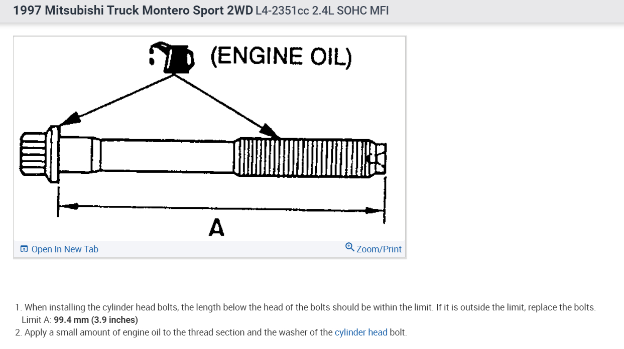

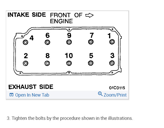

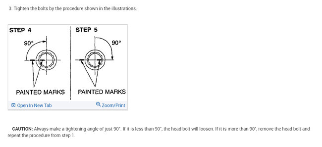

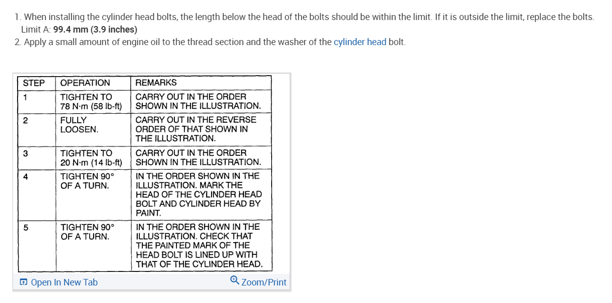

Sure, here are the cylinder head bolt tightening instructions. Check out the images (below). Please let us know if you need anything else to get the problem fixed.
Jun 1, 2023 at 7:18 AM
EMMANUEL PAIVA
Thanks for getting back to me.
The diagram is for Mitsubishi Montero.
Is it the same specification for Mitsubishi Pajero junior H57A 4A31 engine cylinder head bolt torque?
Jun 1, 2023 at 7:40 AM
  • 55,219 POSTS
Yep, they should be the same I crossed referenced the vehicles.
