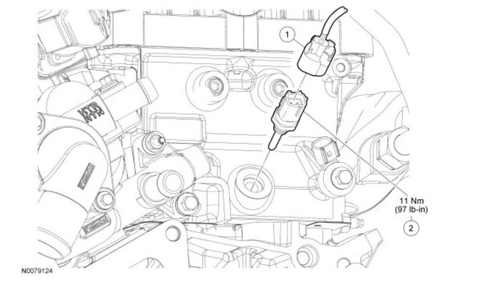

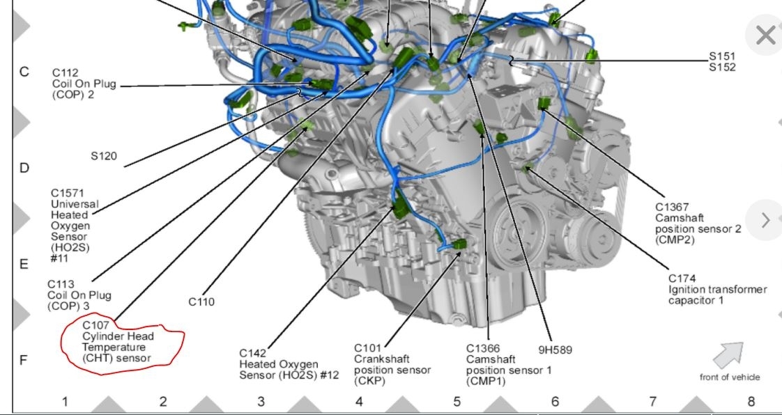

Can't find the cylinder temperature sensor.
Feb 25, 2021 at 7:50 PM
Good morning,
The sensor is at the back of the motor about half way up from the bottom.
https://www.2carpros.com/articles/how-a-coolant-temperature-sensor-works
I attached pictures for you of the location.
NOTE: If the cylinder head is being replaced, the CHT must be replaced.
1. Disconnect the Cylinder Head Temperature (CHT) sensor electrical connector.
2. Remove the CHT (Cylinder Head Temperature) sensor.
- To install, tighten to 11 Nm (97 lb-in).
3. To install, reverse the removal procedure.
