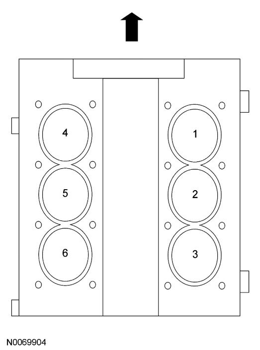

Can I get the cylinder order?
2006 MERCURY MARINER
179,000 MILES • 3.0L • 6 CYL • 4WD • AUTOMATIC
ROBERT LETTERIO
MEMBER
1 POST
I need the location of each cylinder.

This is the layout on the 3.0. 1-2-3 is the right side 4-5-6 are the left side.
Image (Click to enlarge)
