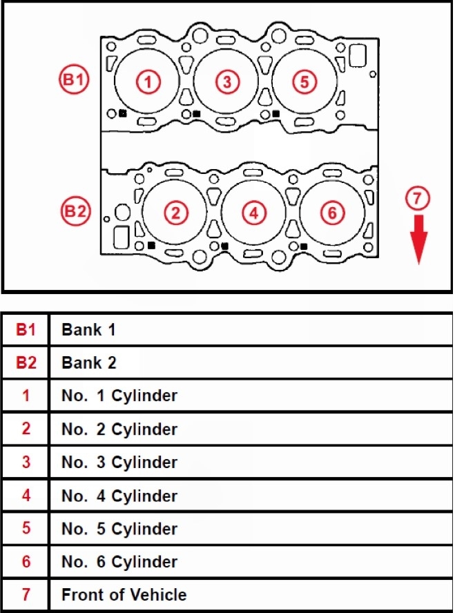

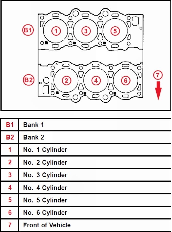

I am working on this Lexus and have a P0354 code for primary ignition coil D, which is cylinder number four. I have been using ChatGPT to help diagnose and fix the issue. ChatGPT said that cylinder number four is at the back of the engine close to the firewall. After doing further research, pretty much everyone else is saying that cylinder number four is at the front of the engine towards the radiator. I tried to tell ChatGPT that it is wrong, but it is insisting that cylinder number four is at the rear of the engine. I do suspect that ChatGPT is wrong, but just want to confirm with you guys. Thank you. You all are a blessing. I tried uploading the photos from ChatGPT, but for some reason they are not uploading.
Dec 18, 2025 at 3:41 AM
STEVE W.
  • 15,352 POSTS
ChatGPT is frequently wrong when it comes to automotive items, especially diagnostics.

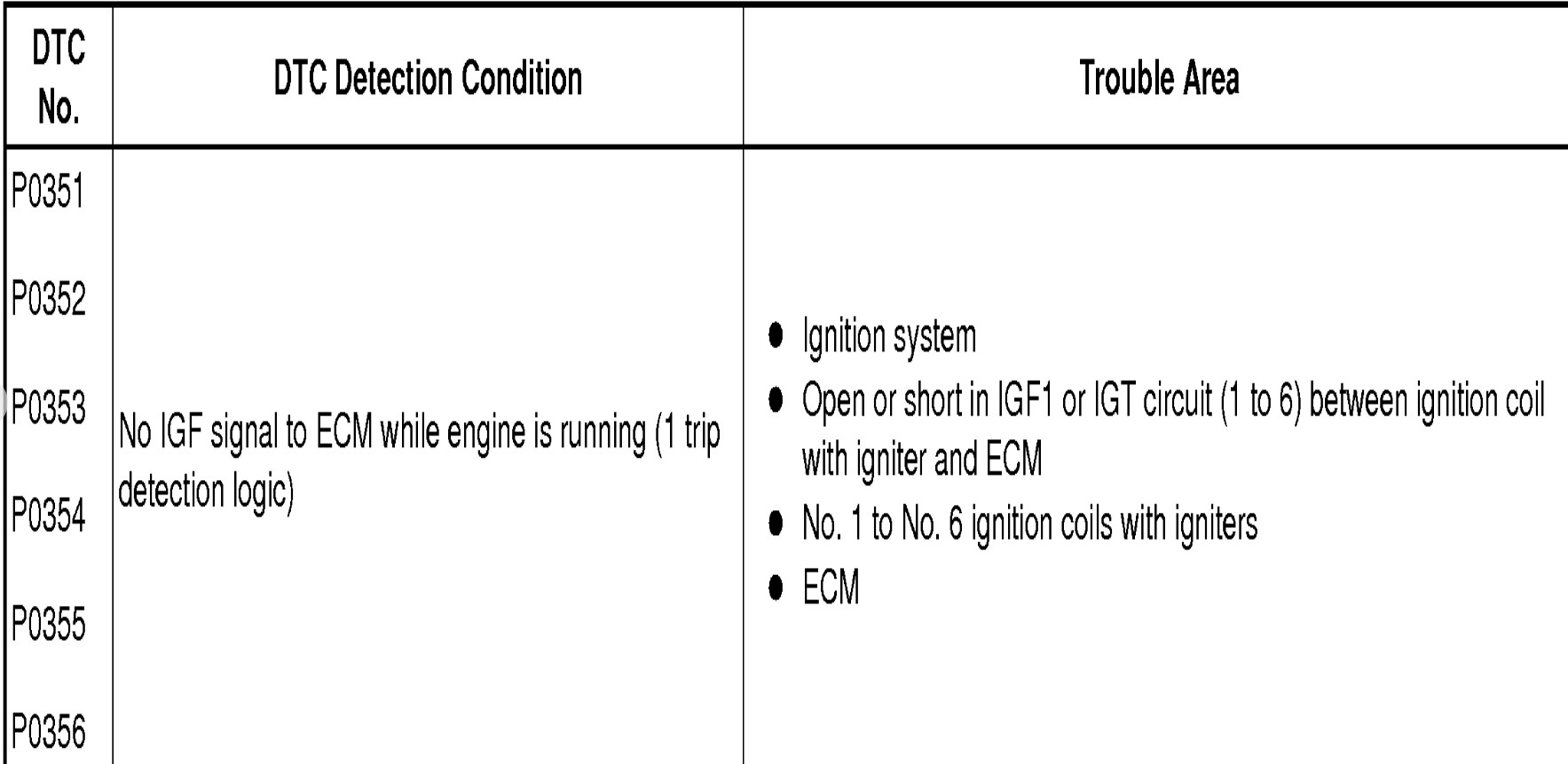

P0354 is a cylinder 4 coil secondary circuit failure, usually a shorted coil. Cylinder 4 is the middle cylinder on the radiator side of the engine as you indicate. The DTC sets when the ECM doesn't get the feedback signal from the coil(s) indicated. That is commonly from a failed feedback circuit in the coil. The easiest way to confirm it's the coil and not a wiring fault is simple, swap the coil with a neighbor cylinder. The code should follow if it's the coil. Remove the engine cover and in the middle of the left cylinder head you will find the coils. Remove the retaining bolts and lift them out and swap cylinders 4 and 2, Connect them up and start the engine. If you now have a P0352 you have a bad coil. One thing with Toyotas and Hondas are that they are touchy about replacement parts, I have seen aftermarket parts from quality companies cause problems on them that an OE part cleared up as soon as it was installed, as such I use OE parts on the ignition and control parts of those brands.

On a sidenote, I did swap the coils and the code came back P0356, so the coil is bad. The coils that are in my Lexus are Toyota 90919–a2002. On your end, do you show any other OEM part numbers than that one that would work for my Lexus? Thanks again for your help!
