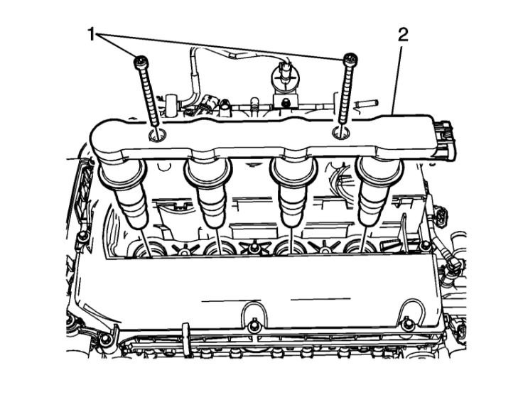

Car started missing, code was p0302. I replaced plugs and coil. Coil covers all 4 plugs. Problem went away for a day. Now missing again but has p0301. So the cylinder 2 misfire was fixed but now a cylinder 1 misfire is present.

Did you replace all the plugs and coils?
Was there any oil in the well for the spark plugs?
Sep 21, 2020 at 6:55 AM
LAPARSONS
I did replace all plugs and there is only 1 coil that covers all 4 plugs and I did replace that as well. There was oil in 2 of the wells but oddly enough the oil was in plugs 3 and 4 which don't show a problem.
Sep 23, 2020 at 10:33 PM
Okayt, then the next thing I would check is fuel pressure. Misfires are common from low fuel pressure.
Fuel Pressure
Ignition "on" engine "off" .................... 365-414 kPa (53-60 psi)
Relieve the fuel pressure to 69 kPa (10 psi). Verify the fuel pressure does not decrease greater than 14 kPa (2 psi) in 5 minutes.
