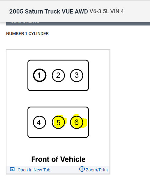

Engine light blinking so I put the ob2 reader and codes that popped up was cylinder 5 misfire/engine misfire/ cylinder 6 misfire. What could be the problem or how do I fix it? someone else put new spark plugs and coil packs, so what's going on? What should I do, I'm lost?

If the new plugs and coil packs didn't help, it could be a couple of things. For example, there could be a fuel injector issue. Also, with that many miles, it could be a head gasket or simply low compression in those cylinders.
I suspect you had P0305 and P0306 codes. Were there any other codes?
Also, since cylinders 5 and 6 are next to each other, the first thing I would be checking is for engine compression in those cylinders. A faulty head gasket can leak between the two. See pic below for cylinder orientation.
Here is a link that explains how to check compression. You will need a compression gauge, but most parts stores will lend one to you.
Let me know if that is something you are comfortable performing.
See pic below.
