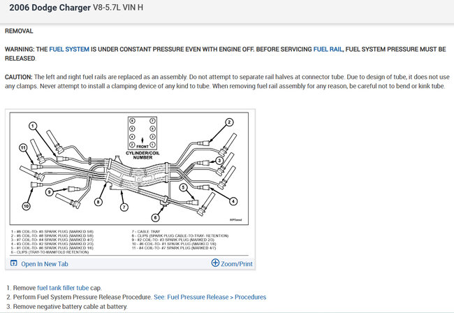

I bought a fuel injector from Amazon. Installed them but one was faulty and continued to dump fuel. code P0306 and P0175. Noticed raw fuel coming from exhaust pipes. I've reinstalled my old injectors and replaced spark plugs but still have engine knock.
Nov 12, 2024 at 5:26 AM
  • 55,694 POSTS
Can you please shoot a quick video with your phone so I can hear the noise? That way I can tell for sure what's going on.
P0306 - Cylinder 6 Misfire Detected
P0175 - System Too Rich (Bank 2)

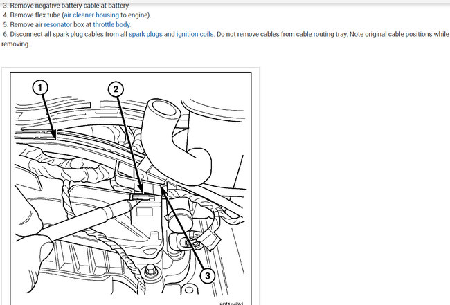

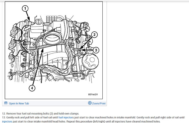

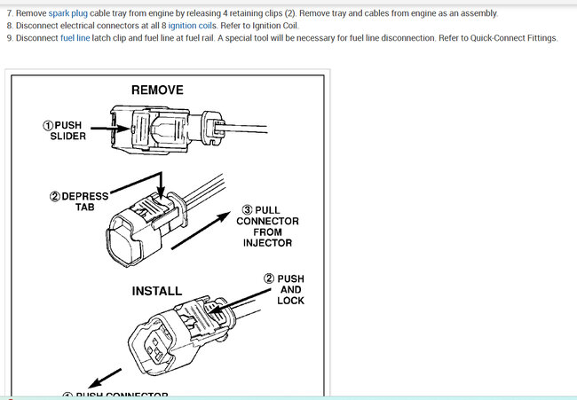

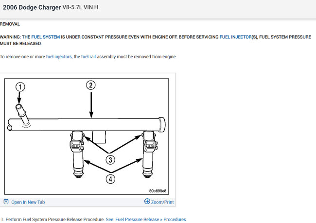

I would remove all fuel injectors for testing, this guide can help:
https://www.2carpros.com/articles/how-to-test-a-fuel-injector
Here is how to remove the fuel injector correctly. Check out the images (below). Please let us know what happens.
