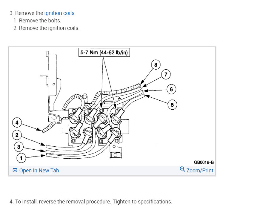

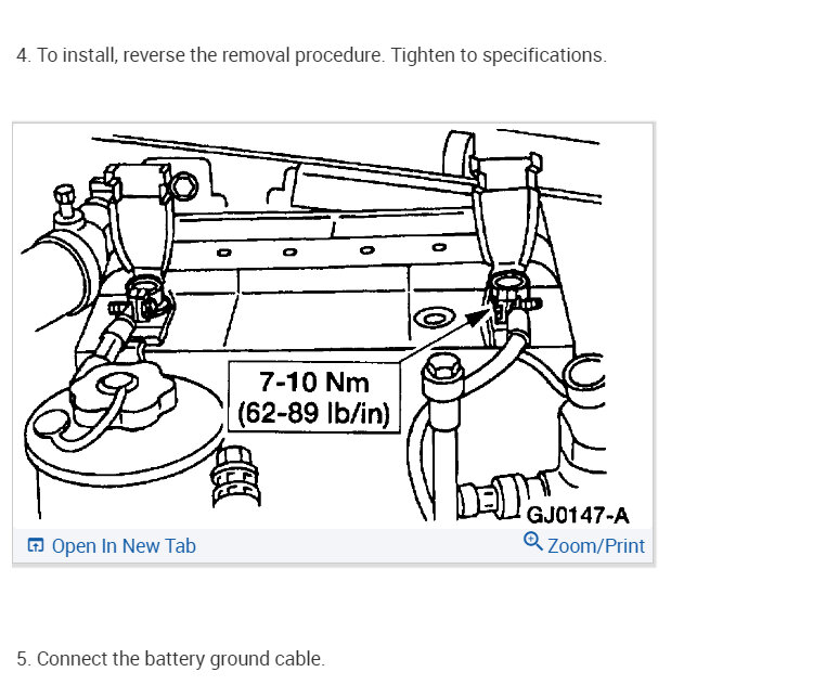

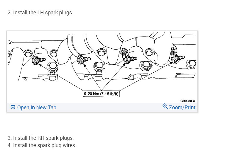

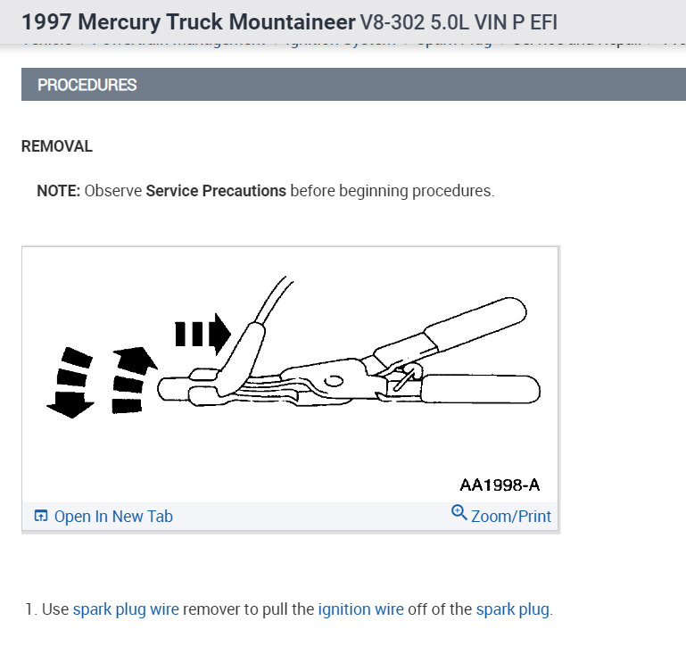

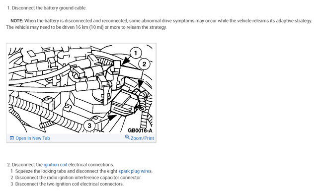

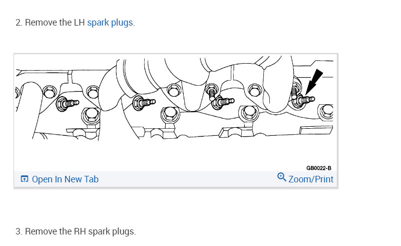

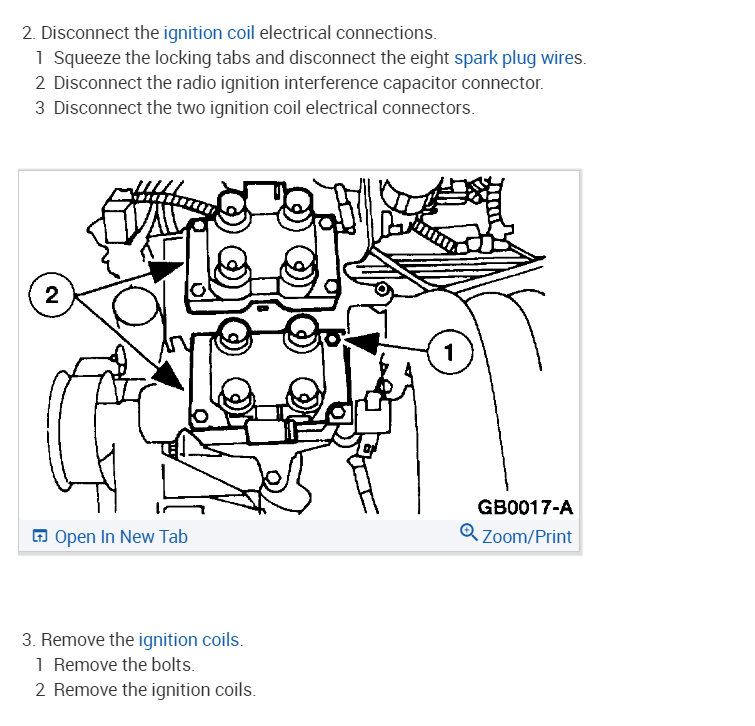

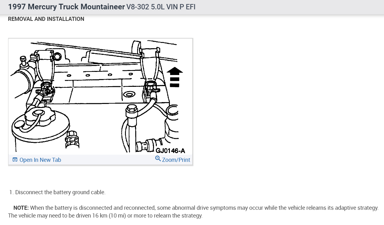

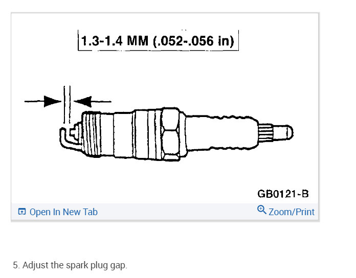

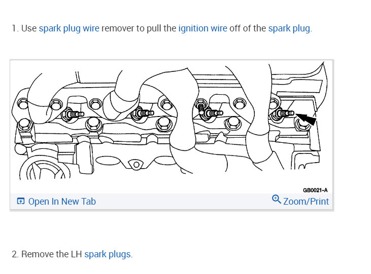

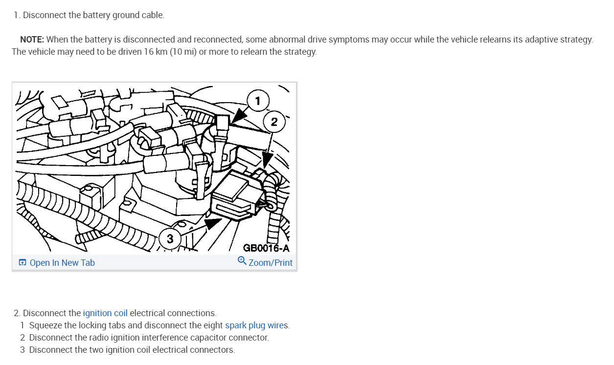

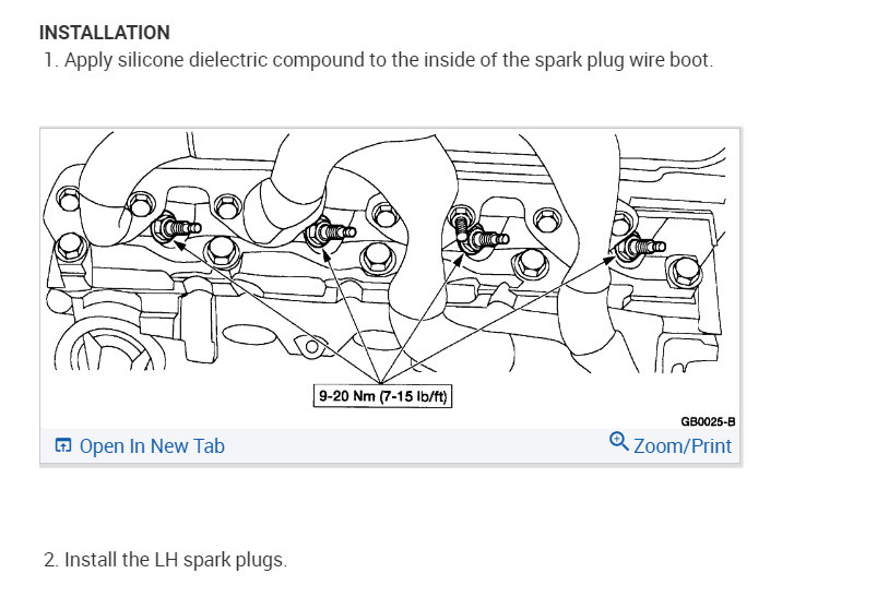

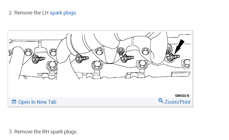

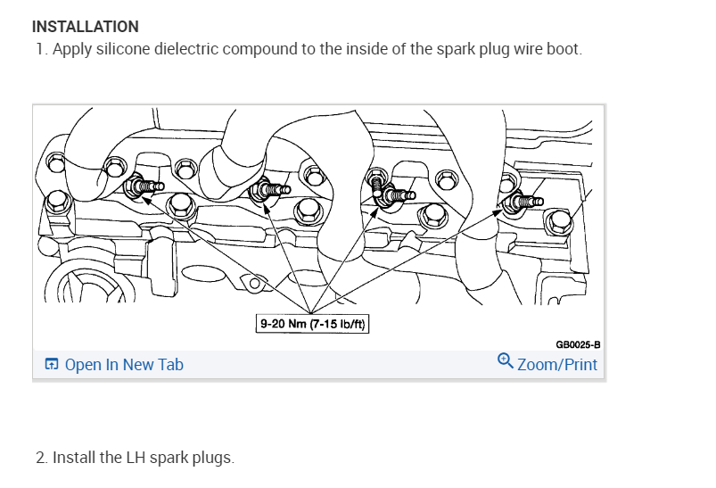

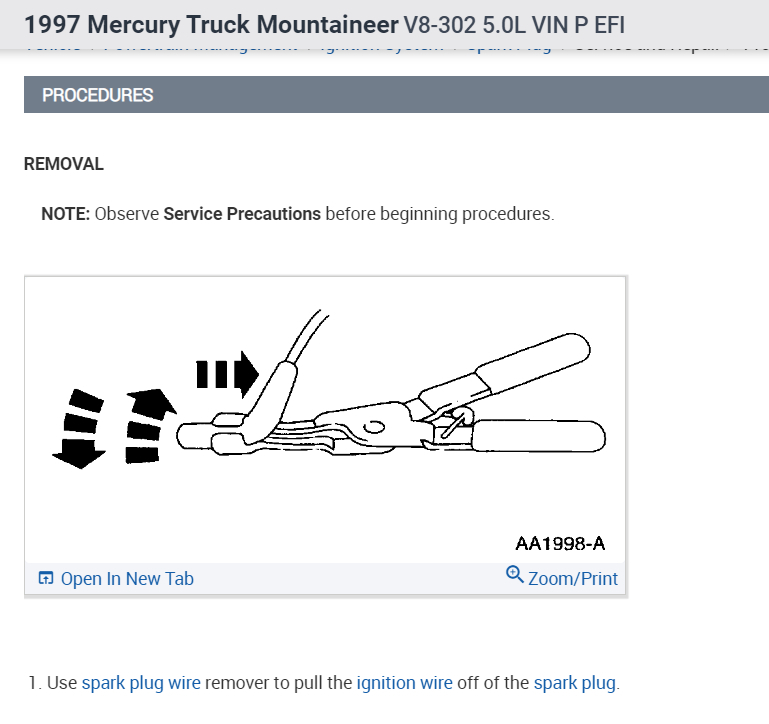

It still can be the spark plug just to let you know. I would do a full tune up including coils, wires and plugs. Here is a guide to help you step by step and I have included how to change the ignition coils out as well in the images below.
Replacement Spark Plugs (Either side) .................... AWSF32EE
https://www.2carpros.com/articles/how-to-tune-up-a-car-engine
Make sure you change ethe plugs wires one at a time. Check out the images (below). Please let us know what happens.
