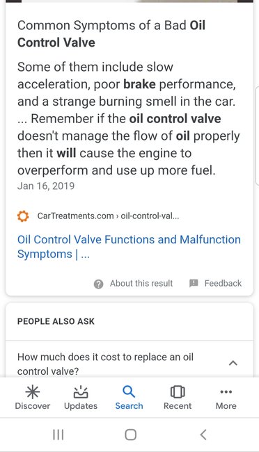

I found this information on the oil control valve. I hope this is the only thing wrong with my car.
Aug 3, 2019 at 5:57 AM
Agreed. Please update us when you know what it was. Thanks
