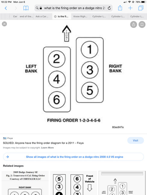

In my service manual it gives a fire in order as 123456, it says 246 left Bank, 135 right bank, i’m confused as to what that means, does it mean 135 on the passenger side or 135 on the driver side when I look online they said on that engine it was turned backwards further confusing me any help you can give would be greatly appreciate it it’s a 2008 dodge nitro 4.0l v6, thanks.

Different engines and makers lay out their engines in different ways. Normally cylinder number one will be the cylinder farthest to the front of the engine.
In the case of your engine the "backwards" would be as compared to other makes. Cylinder one on that engine is the first cylinder on the passenger side. Then behind it are 3 and 5 The driver's side then becomes 2-4-6.
Now if you take that same engine and turn it sideways like in a front wheel drive. The numbers stay the same, so in that case 135 would be the side of the engine facing the firewall and 246 would be the bank facing the radiator.
Hope that helps.

The image in my service manual is the opposite of the of the image you sent. Does that make a difference?

This is the way it looks in my service manual. I didn’t know how to upload it when I first responded.

Same thing, just the one I posted would be if you were standing in front of the car, your image shows the layout from the driver's seat. Note, the arrows showing the direction of the front of the vehicle.

Thank you so much for clearing that up for me. I could not see it that way before you explained it. I really appreciate you responding so quickly. Thank you.
