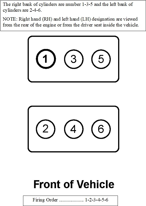

Cylinder 5 is misfiring occasionally. Need to find which one is #5 cylinder.

Here's the cylinder layout and the firing order.
Image (Click to enlarge)
