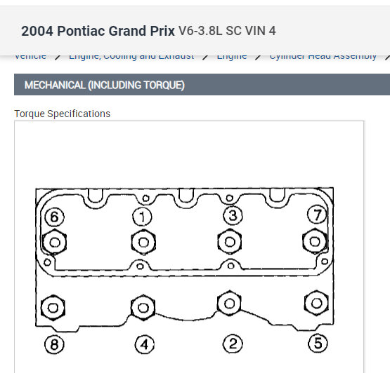

Need torque specs and sequence. supercharged.
May 7, 2024 at 6:14 PM
  • 110,194 POSTS
If you look below, I attached both the torque specifications, torque sequence, and all info related to doing the job.
When you do this, the head bolts should be new. The old ones will be stretched, and the correct torque will not be reached.
Let me know if this helps.
