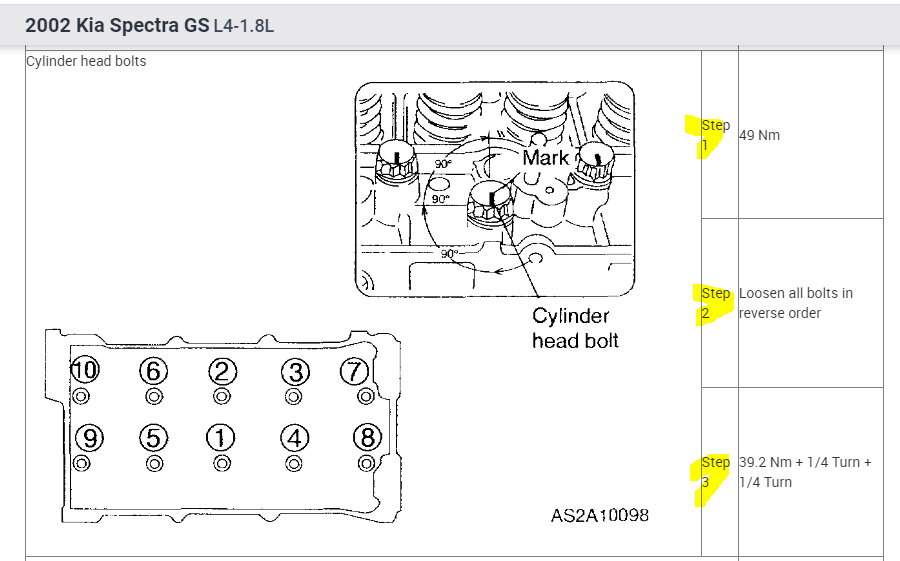

What are the cylinder head torque specs?
2002 KIA SPECTRA
100,000 MILES • 1.8L • 4 CYL • 2WD • MANUAL
HEPP5856
need to know torque on bolts to head.

I attached the torque specs below related to the cylinder head. Make sure to follow the sequence indicated. Also, the torque should be done in three steps. See the area that I highlighted.
See pic below.
