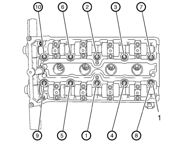

What is the cylinder head torque settings for the car listed above (f18d4)?

Below is the procedure and attached is the sequence for tightening.
First pass to .................... 25 Nm (18 lb ft)
Second pass to .................... 90°
Third pass to .................... 90°
Fourth pass to .................... 90°
Fifth pass to .................... 45°
