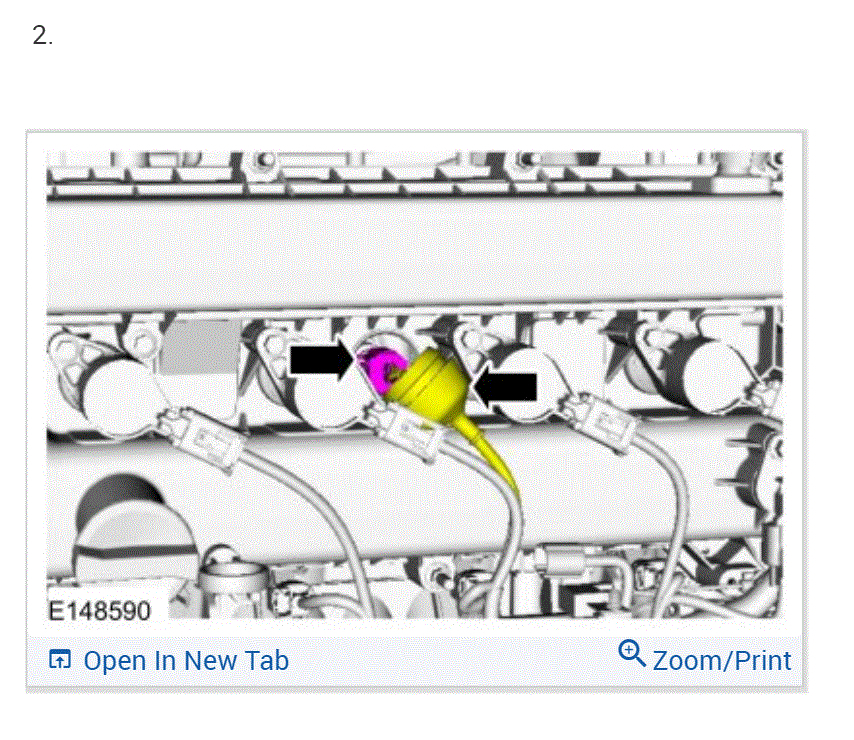

Cylinder head temperature sensor where is it located, please help?
Nov 29, 2021 at 4:21 AM
  • 110,241 POSTS

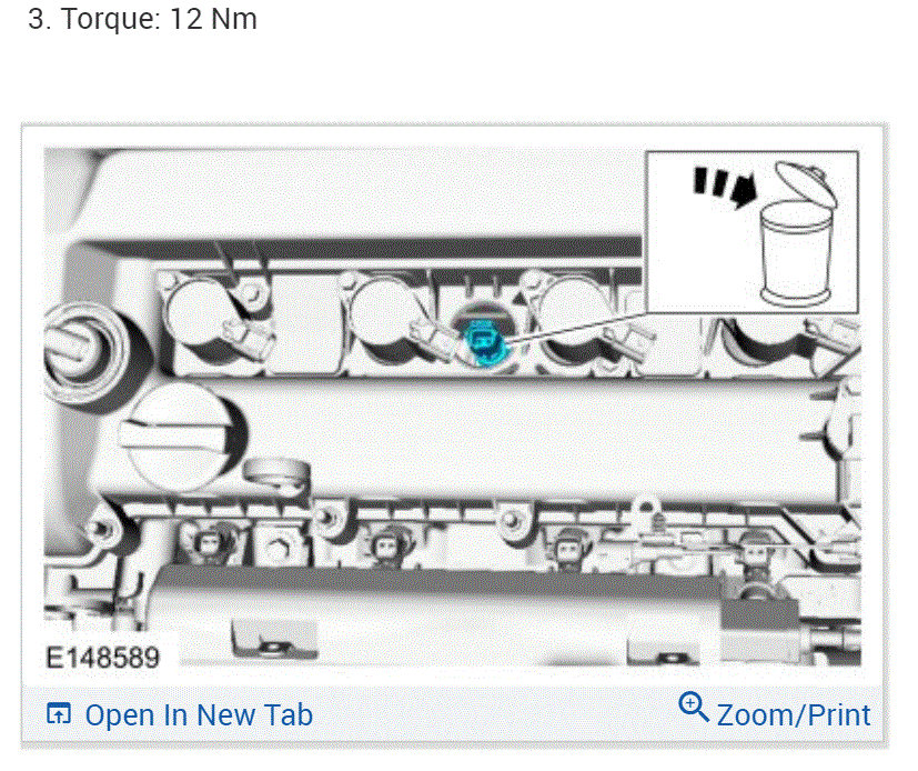

The CHT sensor is located between cylinders 2 and 3 at the top of the engine. However, that can be different based on which 4 cylinder you have. The information I'm providing is for the 2.5L 4 cylinder. If you have something different, let me know.

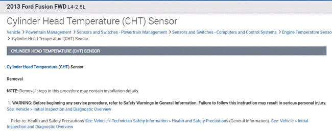

If you look at the pics below, they are the directions for replacement. They are very vague. Basically, the manual provides pics without a description.
