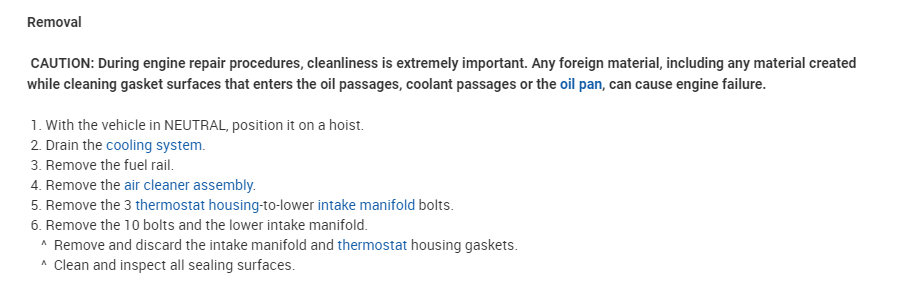

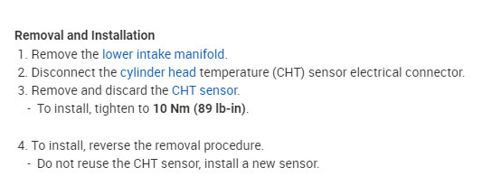

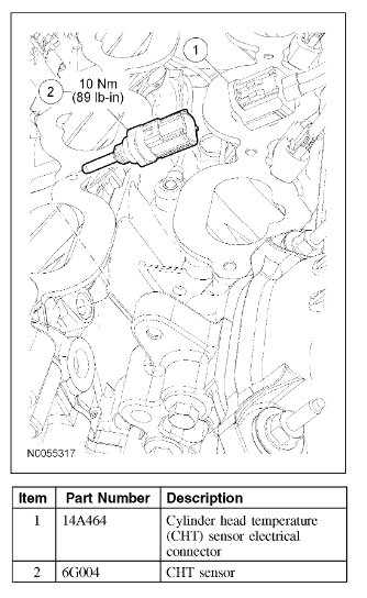

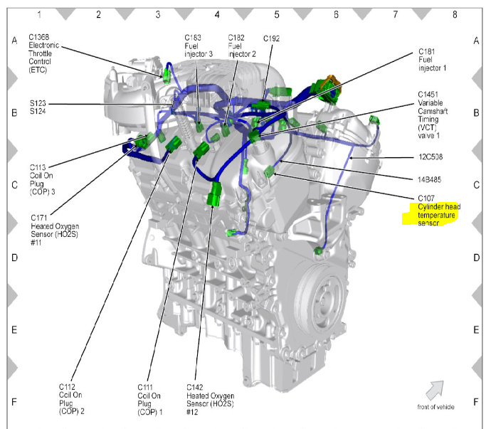

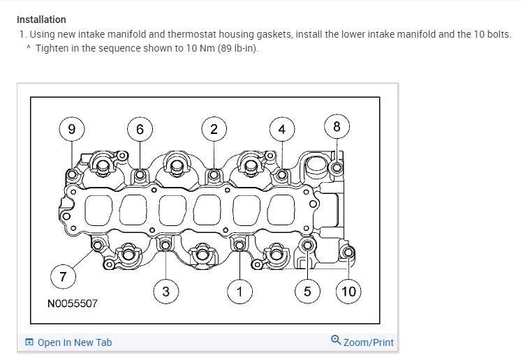

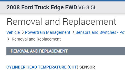

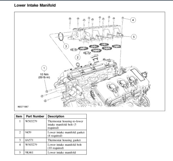

I wanted to know where the cylinder head temperature sensor is located and how to replace it?
Sep 16, 2022 at 7:20 AM
Experienced Mechanic
110,248 POSTS

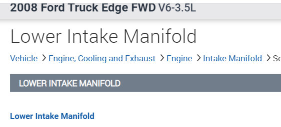

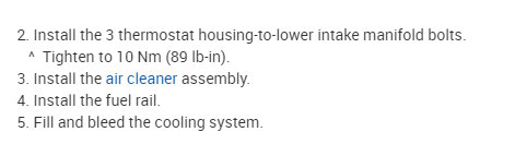

The sensor is in the rear of the cylinder head. It requires the removal of the lower intake manifold to be replaced.
If you look below, I provided the location and directions. (Pics 1-4) The remaining pics are the directions for removing the lower intake manifold.
Let me know if this helps.
