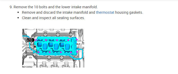

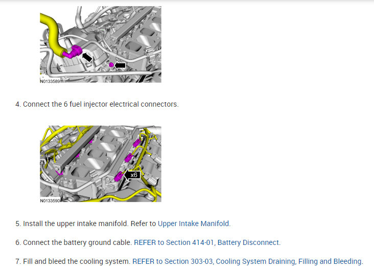

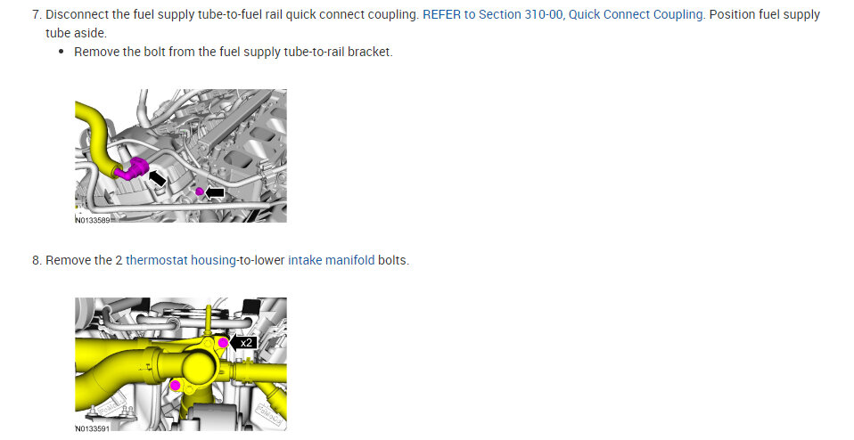

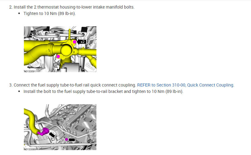

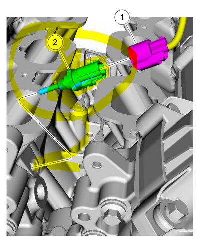

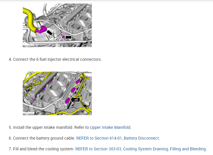

I am not a mechanic, but I am trying to replace the sensor. Need details or illustration as to its location.
Sep 22, 2024 at 4:06 AM
✓Experienced Mechanic
110,240 POSTS

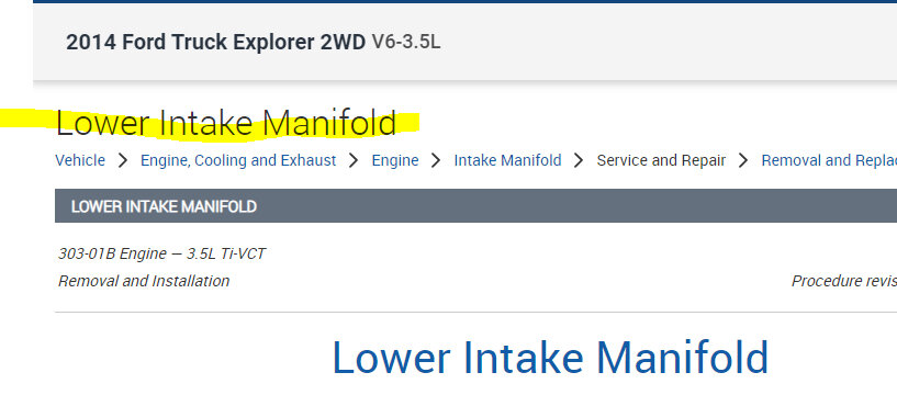

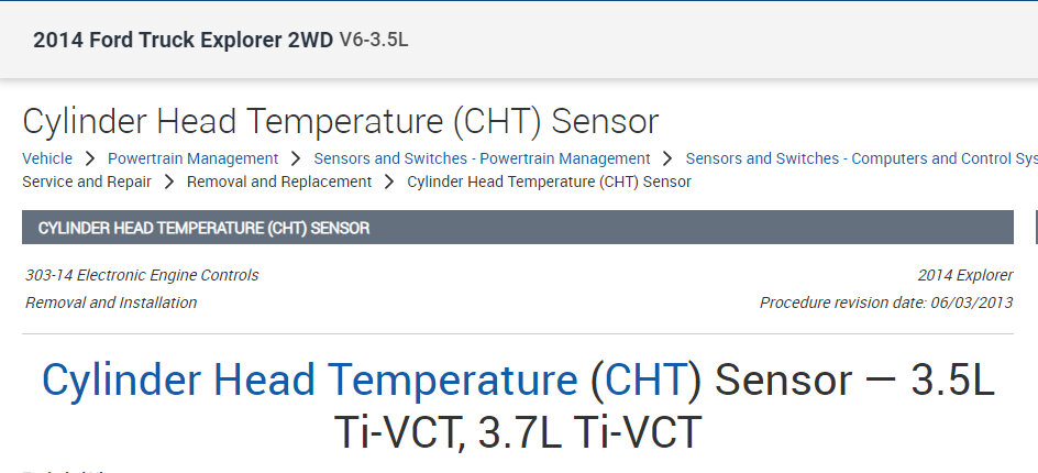

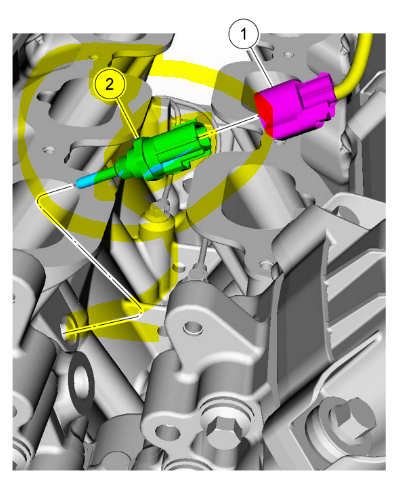

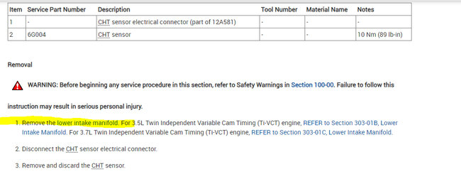

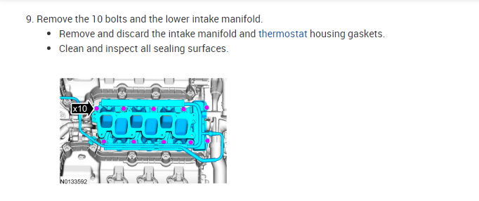

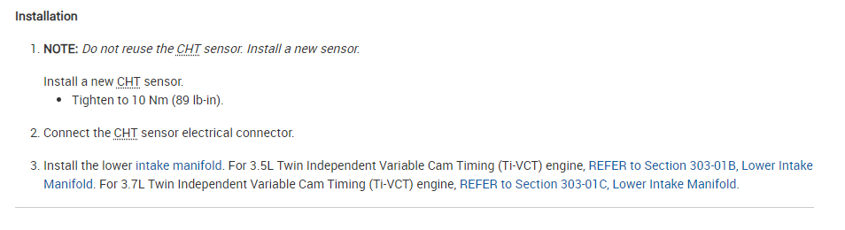

The cylinder head temperature sensor (CHT) is located under the intake manifold. It requires the removal of the manifold. Basically, a simple job has turned into a major job.

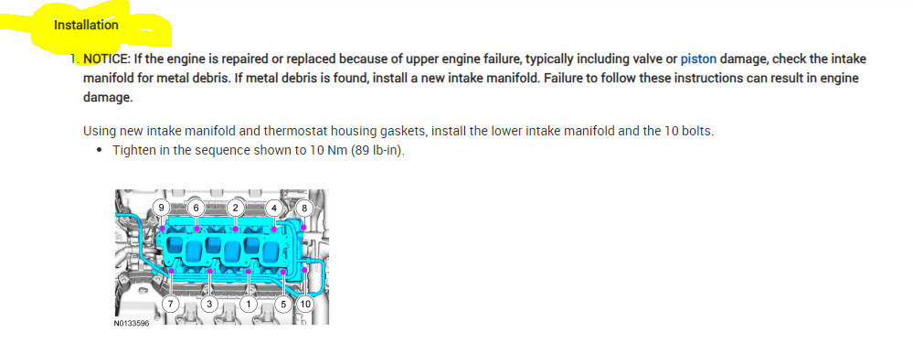

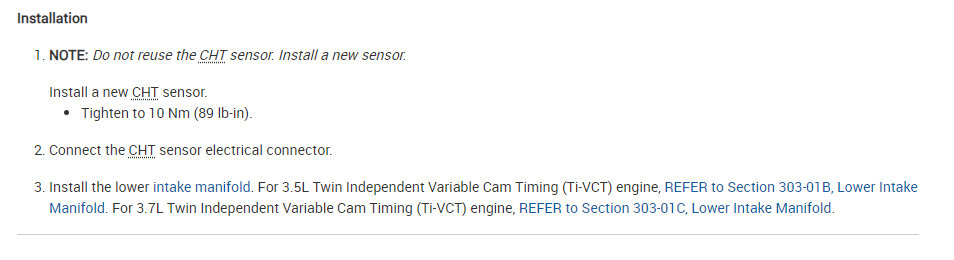

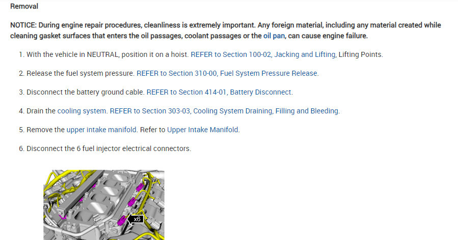

I attached the directions below. Pica 1-4 are for the sensor once the manifold is removed. The remaining pictures are for the removal of the lower manifold. Take a look and let me know if you are comfortable performing them or if you have other questions.
