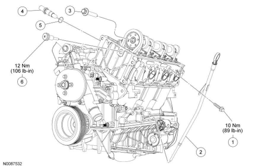

Do you have to pull the engine to change heads?
Apr 7, 2019 at 10:57 AM
  • 110,244 POSTS
Welcome to 2CarPros.
No, it doesn't need pulled. However, sometimes I think it would be easier.

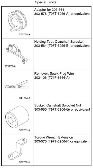

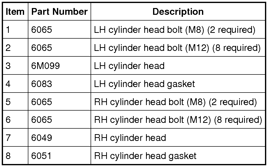

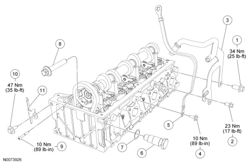

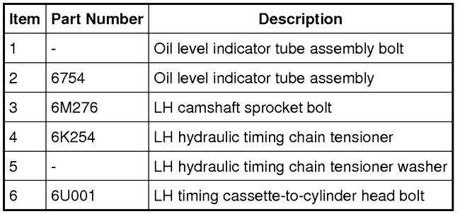

Here are the directions for head replacement. All attached pictures correlate with these directions and the torque specs are there too.
__________________________

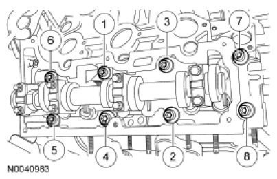

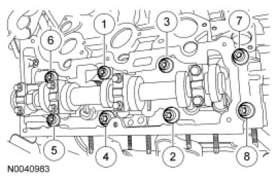

CYLINDER HEAD
Cylinder Head
Pictures 1 and 2

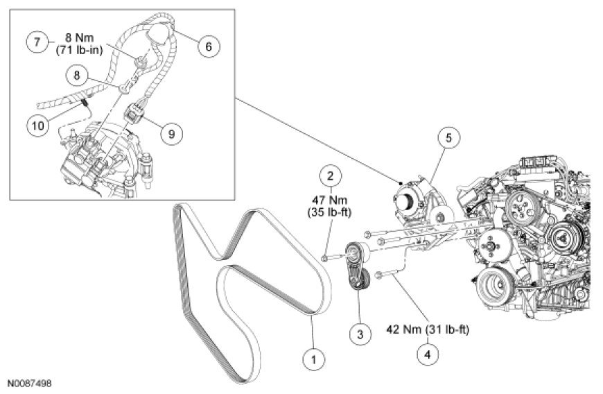

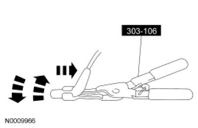

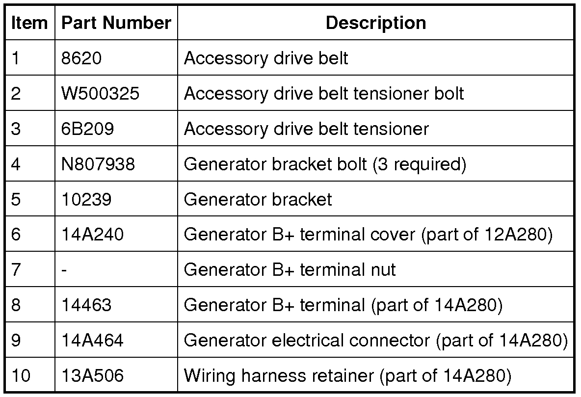

Accessory Drive Belt, Tensioner and Generator Bracket
Pictures 3 and 4

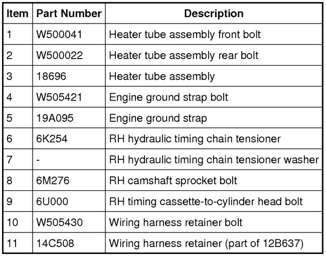

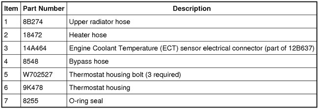

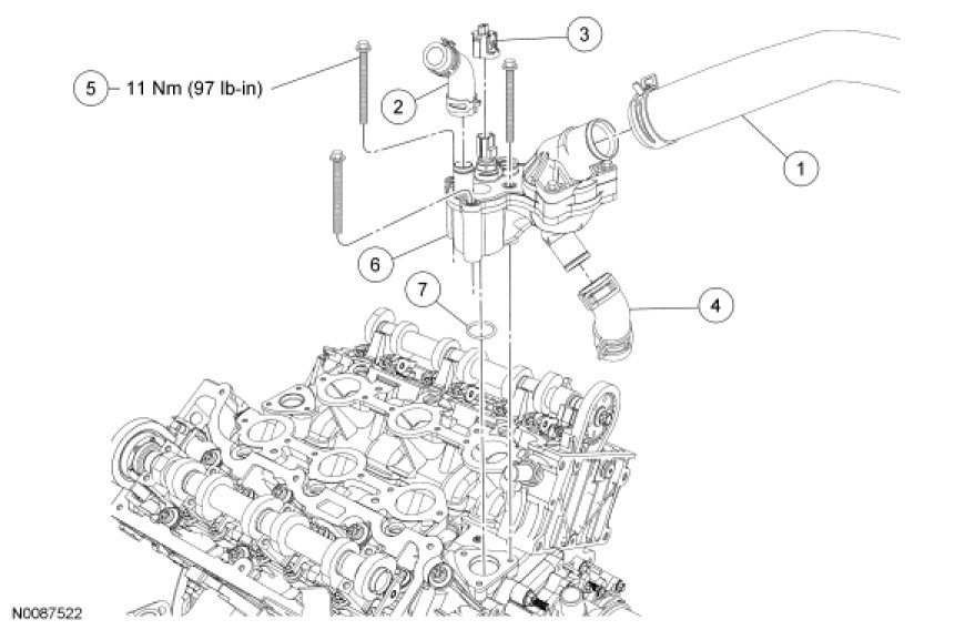

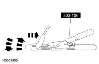

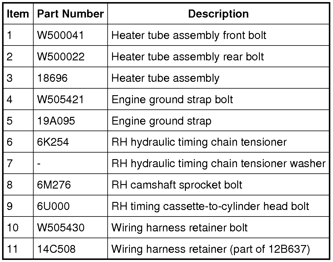

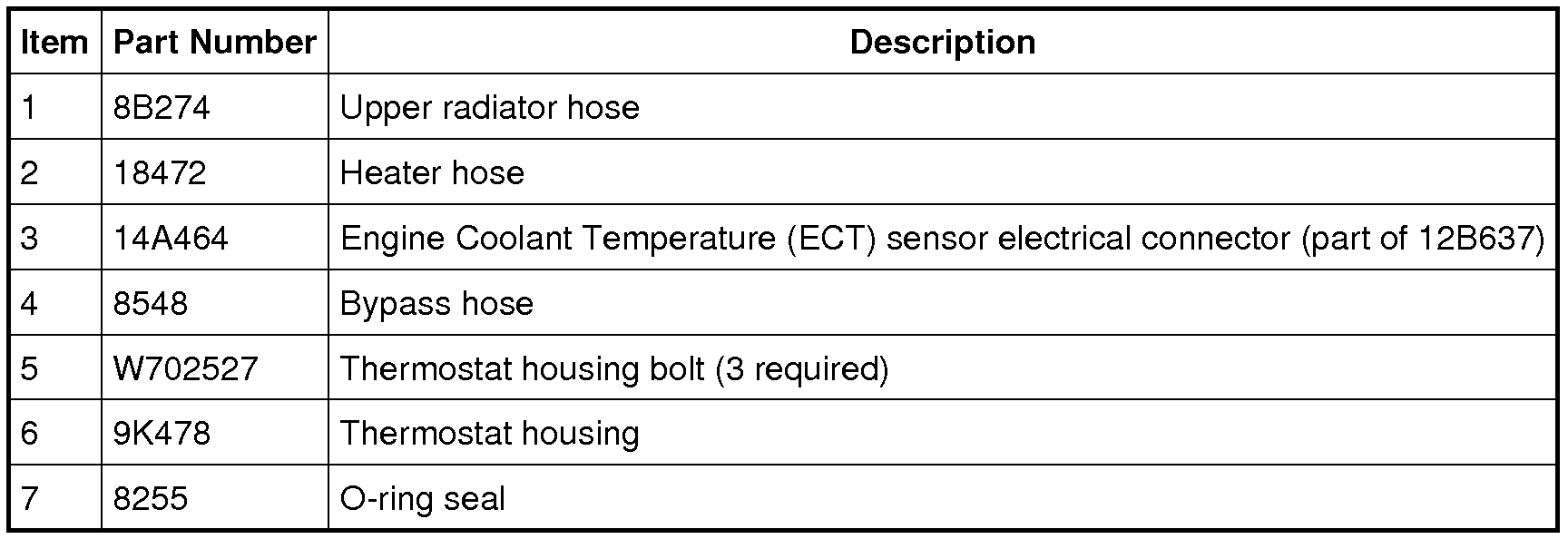

Thermostat Housing
Pictures 5 and 6

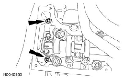

RH Cylinder Head Attachments
Pictures 7 and 8

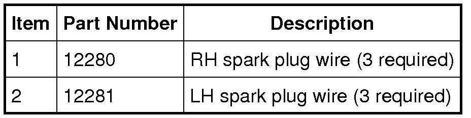

Spark Plug Wires
Pictures 9 and 10

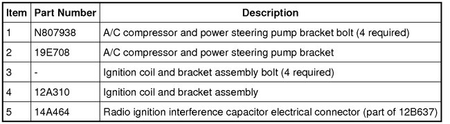

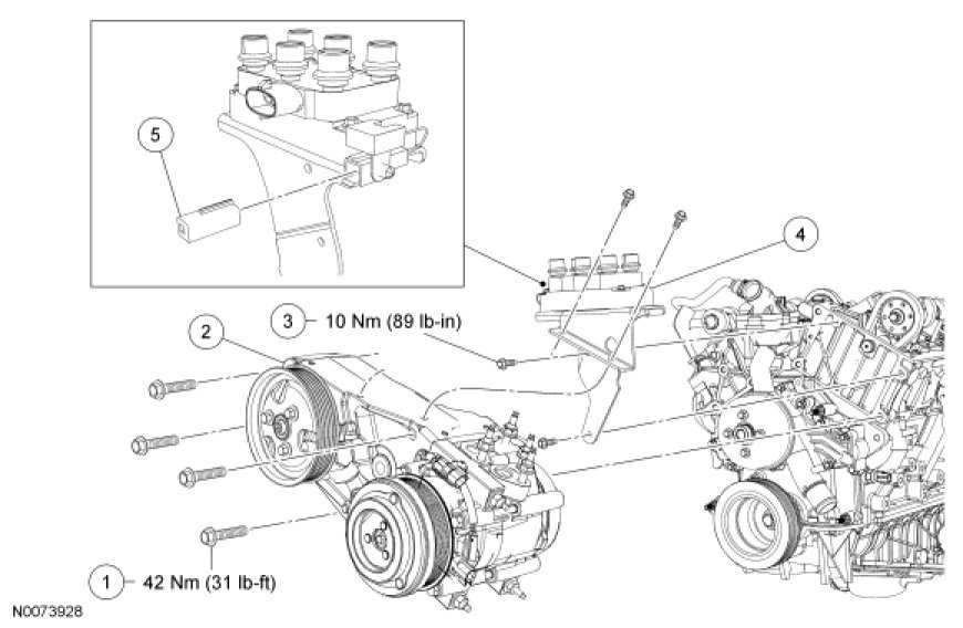

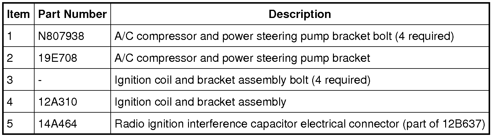

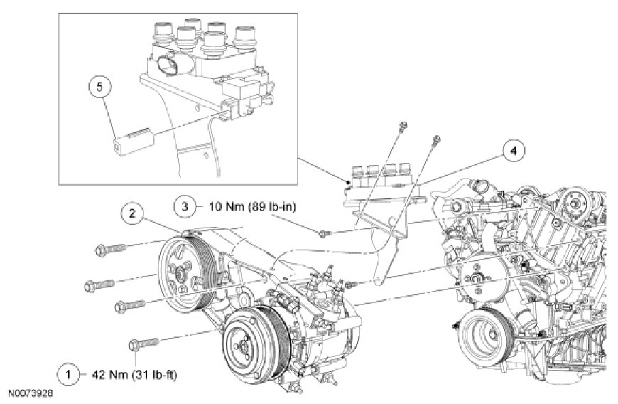

Power Steering Pump and A/C Compressor Bracket and Ignition Coil
Pictures 11 and 12

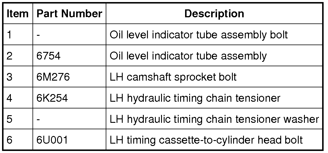

LH Cylinder Head Attachments
Pictures 13 and 14
Cylinder Heads
Pictures 15 and 16
Removal
Both sides
1. With the vehicle in NEUTRAL, position it on a hoist.

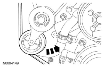

4. Rotate the accessory drive belt tensioner counterclockwise and remove the accessory drive belt.
Picture 17
RH side
5. Remove the 2 bolts and position the heater hose tube bracket aside.
6. Disconnect the battery ground cable.

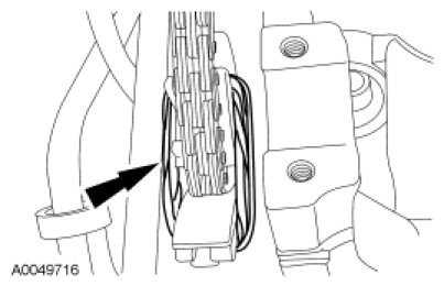

7. Disconnect the generator electrical connections.
8. Remove the bolt and the accessory drive belt tensioner.
9. Remove the 3 bolts and the generator mounting bracket assembly.
10. Disconnect the heater hose from the thermostat housing.
11. Disconnect the Engine Coolant Temperature (ECT) sensor electrical connector.
12. Disconnect the upper radiator hose from the thermostat housing.
13. Position the bypass hose clamp aside.
14. Remove the 3 bolts and the thermostat housing.
15. Remove the bolt and position the engine wiring harness aside.
16. Remove the engine ground strap.

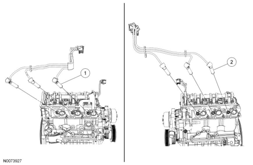

17. NOTICE: It is important to twist the spark plug wire boot while pulling upward to avoid damage to the spark plug wire.
NOTE: Spark plug wires must be connected to the correct spark plug. Mark the spark plug wires for installation reference.
With a twisting motion, use the Spark Plug Wire Remover to pull the spark plug wires from the RH spark plugs.
Picture 18
18. Remove the RH exhaust manifold. For additional information, refer to Exhaust Manifold - RH See: Exhaust Manifold > Removal and Replacement > Exhaust Manifold - RH.

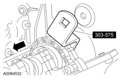

19. Remove the RH hydraulic timing chain tensioner.

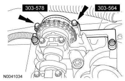

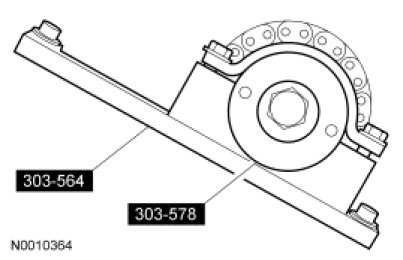

20. Install the Camshaft Sprocket Holding Tool and the Adapter for 303-564.
- Tighten to 10 Nm (89 lb-in).
Picture 19
21. NOTICE: The RH camshaft sprocket bolt is a LH-threaded bolt. Turning the bolt in the wrong direction can damage the bolt.
Using the Torque Wrench Extension with the Camshaft Sprocket Nut Socket, remove the RH camshaft bolt.
Picture 20
22. Remove the RH side cassette-to-cylinder head bolt.
23. NOTICE: Remove the camshaft sprocket from the timing chain to gain clearance to remove the cylinder head. Leaving the sprocket in place can damage the cassette and prevent the cylinder head from being removed.
NOTE: Hold the timing chain and cassette with a rubber band to aid in removal and to prevent the timing chain from falling into the cylinder block.
Remove the RH camshaft sprocket from the timing chain. Install a rubber band around the cassette and the timing chain.

24. Disconnect the radio ignition interference capacitor electrical connector.
25. Remove the 2 ignition coil and bracket assembly-to-A/C compressor and power steering pump bracket bolts.
26. Remove the 4 bolts and position the A/C compressor and power steering pump bracket aside.
27. Remove the 2 ignition coil and bracket assembly-to-cylinder head bolts and the ignition coil and bracket assembly.
28. Remove the bolt and the oil level indicator tube.
29. Remove the LH exhaust manifold. For additional information, refer to Exhaust Manifold - LH See: Exhaust Manifold > Removal and Replacement > Exhaust Manifold - LH.
30. Remove the LH hydraulic timing chain tensioner.
31. Install the Camshaft Sprocket Holding Tool and the Adapter for 303-564.
- Tighten the top clamp bolts to 10 Nm (89 lb-in).
Picture 22
32. Remove the LH side camshaft sprocket bolt.
33. Remove the LH timing cassette-to-cylinder head bolt.
34. NOTICE: Remove the camshaft sprocket from the timing chain to gain clearance to remove the cylinder head. Leaving the sprocket in place can damage the cassette and prevent the cylinder head from being removed.
Remove the LH camshaft sprocket from the timing chain. Install a rubber band around the cassette and the timing chain.
Picture 23

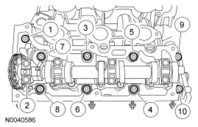

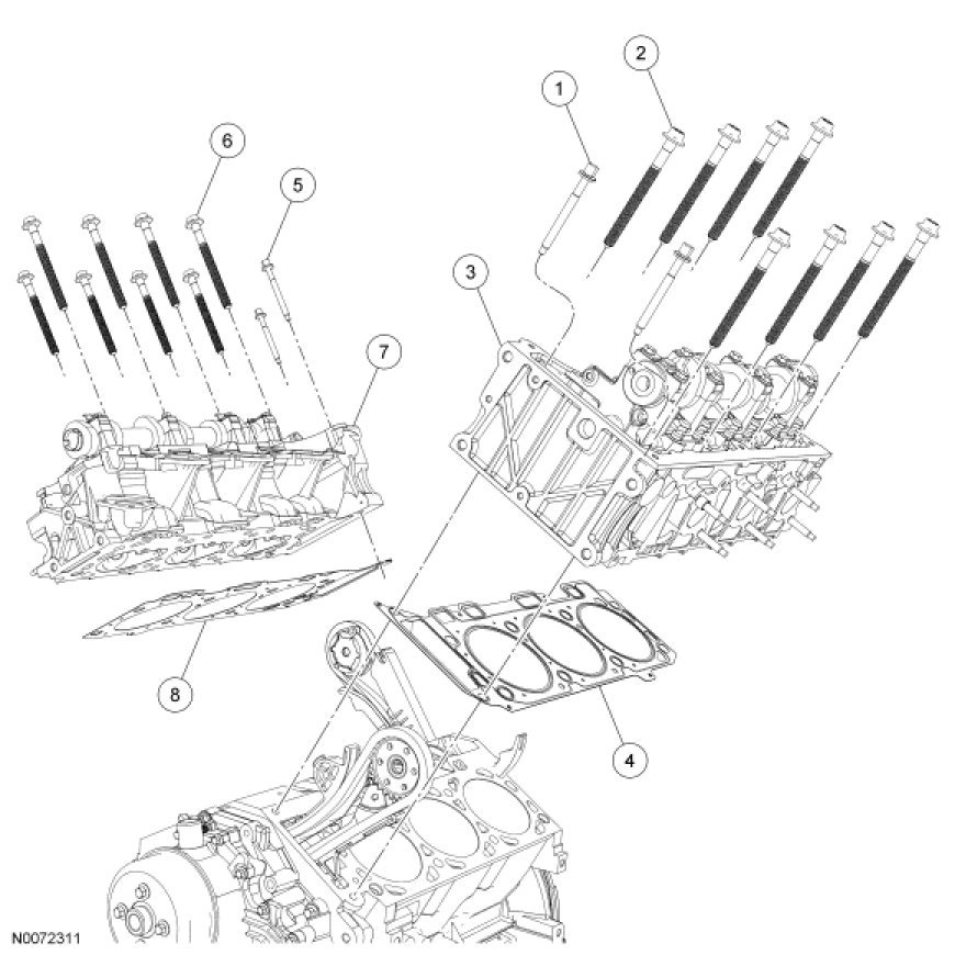

35. NOTICE: To avoid damage to the timing chain cassette, an assistant will be required to help lift the cylinder head from the vehicle.
NOTICE: On the RH side, when lifting the cylinder head, be careful to avoid contacting the A/C tube or the A/C tube can be damaged.

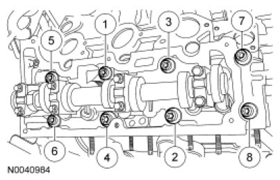

NOTE: New cylinder head bolts must be installed. They are a torque-to-yield design and cannot be reused.
Remove the cylinder heads.
- Remove the 10 bolts from each cylinder head in the sequence shown. Discard all bolts.
- Remove and discard the head gasket.
Picture 24

Installation
Both sides
1. Clean the cylinder head bolt holes in the cylinder block. Make sure all coolant, oil or other foreign material is removed.
2. Position the cylinder head gasket on the block.
RH side

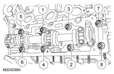

3. NOTICE: To avoid damage to the timing chain cassette, an assistant will be required to help position the cylinder head in the vehicle.
NOTICE: On the RH side, when positioning the cylinder head, be careful to avoid contacting the A/C tube or the A/C tube can be damaged.
Install the cylinder head. Install 8 new 12-mm bolts and tighten in the sequence shown in 2 stages.
- Stage 1: Tighten to 12 Nm (106 lb-in).
- Stage 2: Tighten to 25 Nm (18 lb-ft).
Picture 25
4. Install 2 new 8-mm bolts.
- Tighten to 32 Nm (24 lb-ft).
Picture 26
5. Tighten the 8 new 12-mm bolts in the sequence shown in 2 stages.
- Stage 1: Tighten 90 degrees.
- Stage 2: Tighten an additional 90 degrees.
Picture 27

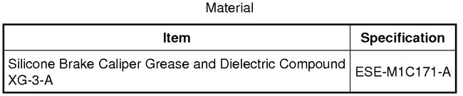

9. NOTE: Apply silicone brake caliper grease and dielectric compound to the inside of the spark plug boots.
Connect the spark plug wires to the RH spark plugs.

12. NOTE: Inspect the O-ring seal. Install a new O-ring seal if necessary.
Install the thermostat housing and the 3 bolts.
- Tighten to 11 Nm (97 lb-in).
13. Position the coolant bypass hose clamp.
14. Install the upper radiator hose to the thermostat housing.
15. Connect the Engine Coolant Temperature (ECT) sensor electrical connector.
16. Connect the heater hose to the thermostat housing.

23. NOTE: Apply silicone brake caliper grease and dielectric compound to the inside of the spark plug boots.
Connect the spark plug wires to the LH spark plugs.

26. Install the generator mounting bracket assembly and the 3 bolts.
- Tighten to 42 Nm (31 lb-ft).
27. Position the accessory drive belt tensioner and install the bolt.
- Tighten to 47 Nm (35 lb-ft).
28. Connect the generator electrical connections.
- Tighten to 8 Nm (71 lb-in).
29. Connect the battery ground cable.
30. Position the heater hose tube bracket and install the 2 bolts.
- Tighten the rear bolt to 23 Nm (17 lb-ft).
- Tighten the front bolt to 34 Nm (25 lb-ft).

31. Position the ignition coil and bracket assembly and install the 2 bracket-to-cylinder head bolts.
32. Position the A/C compressor and power steering pump bracket and install the 4 bolts.
33. Install the 4 ignition coil bracket-to-A/C compressor and power steering pump bracket bolts.
34. Connect the radio ignition interference capacitor electrical connector.

35. Rotate the accessory drive belt tensioner counterclockwise and install the accessory drive belt.
Picture 31
