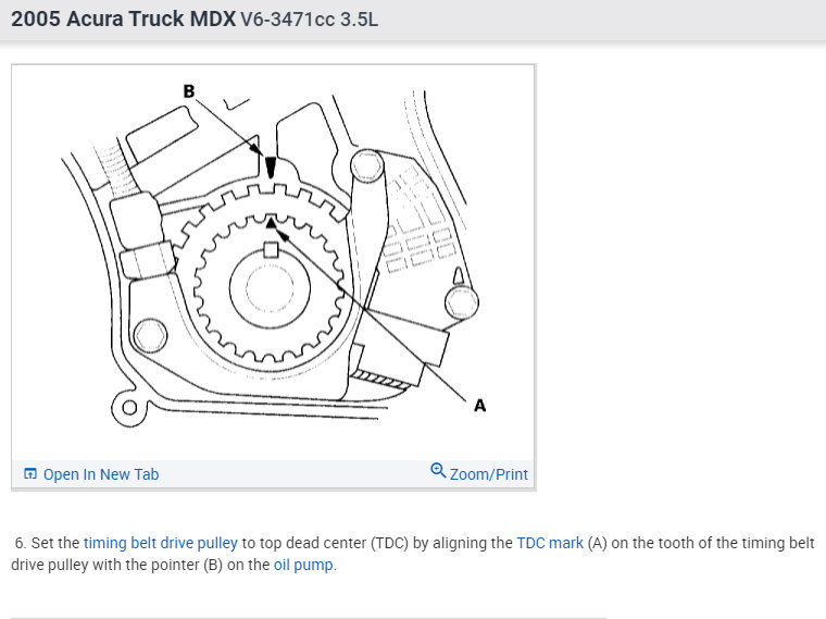

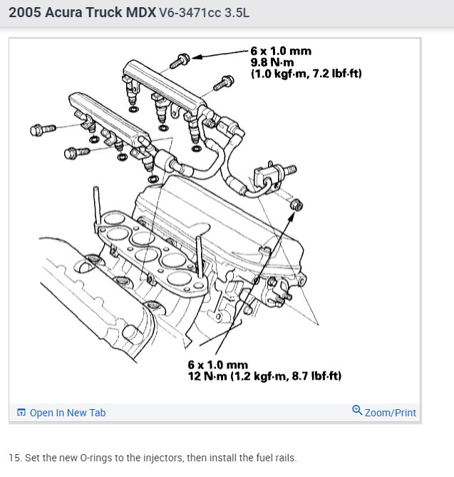

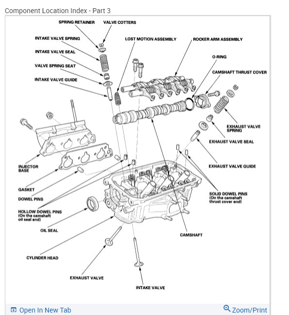

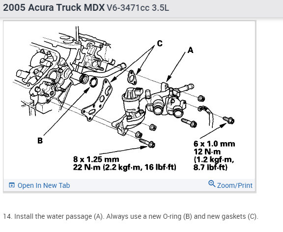

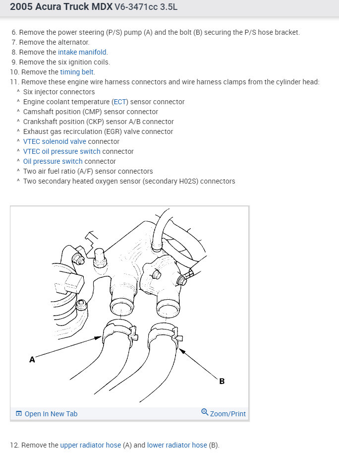

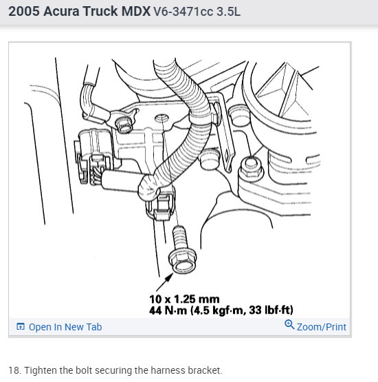

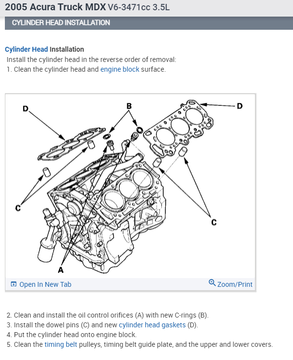

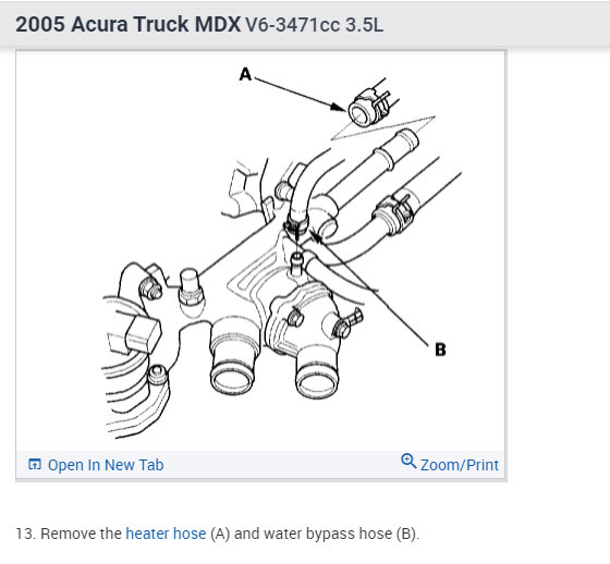

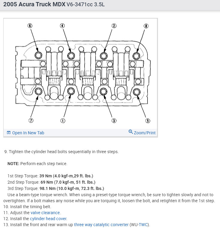

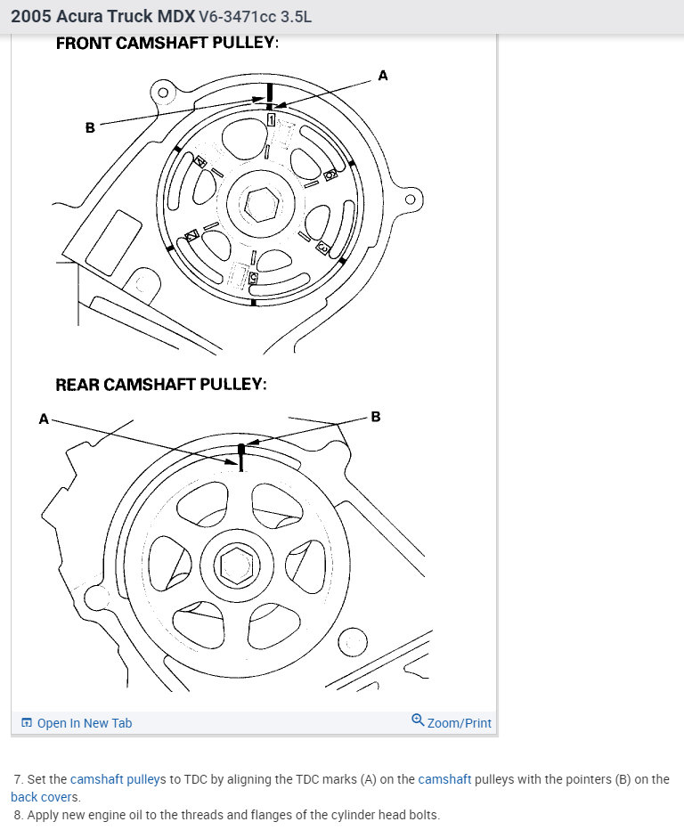

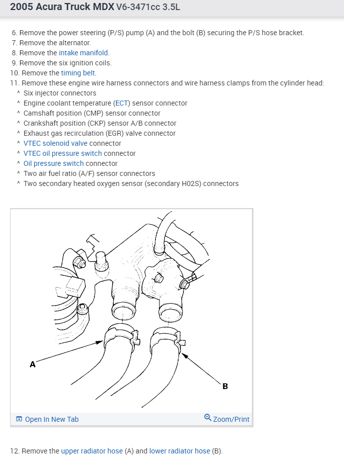

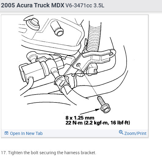

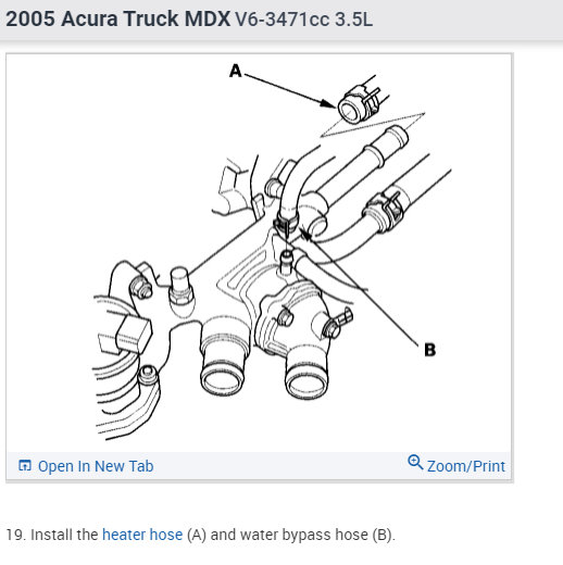

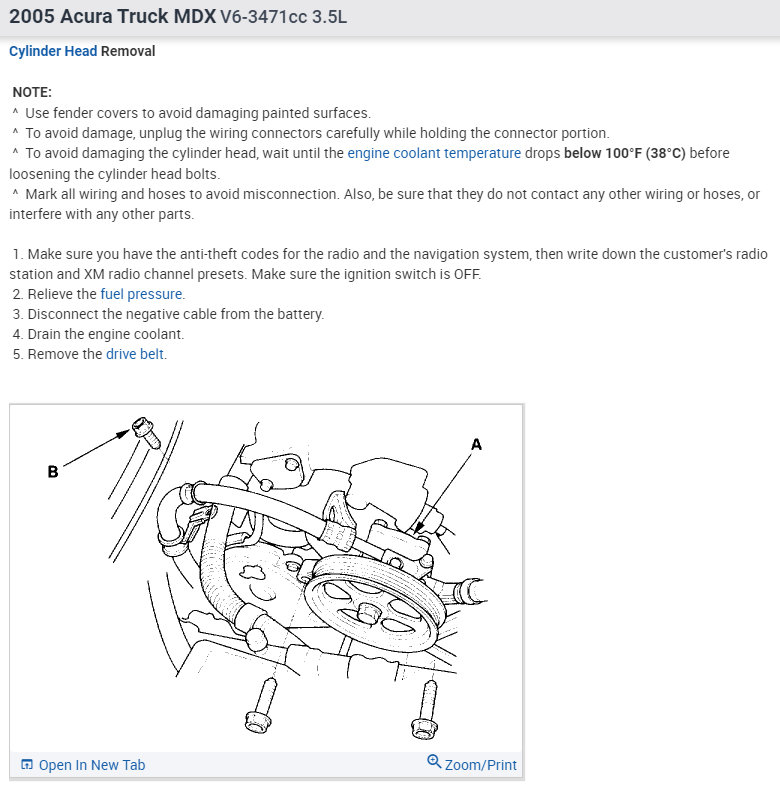

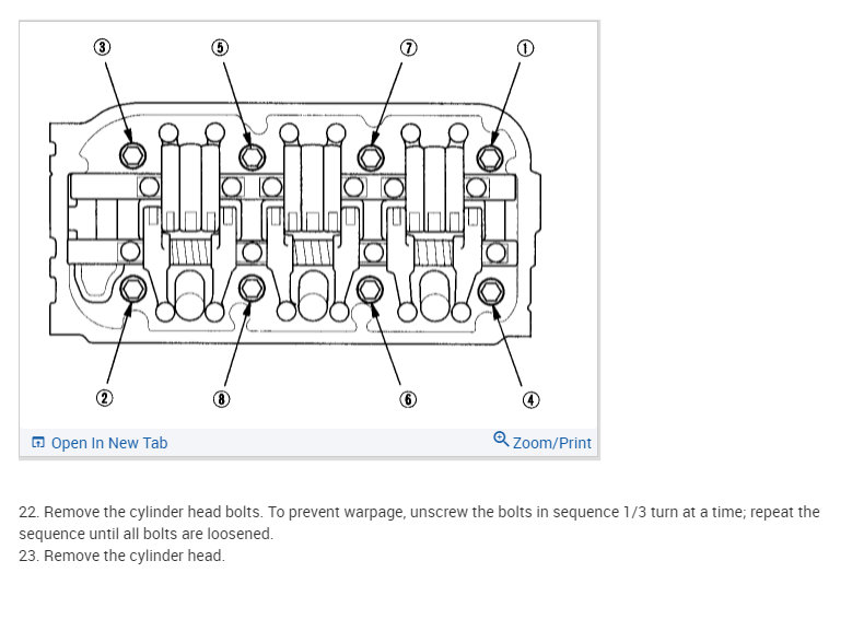

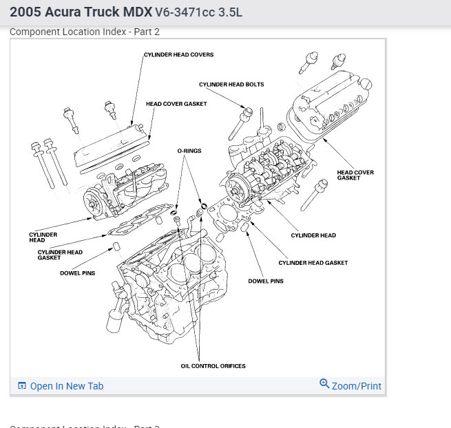

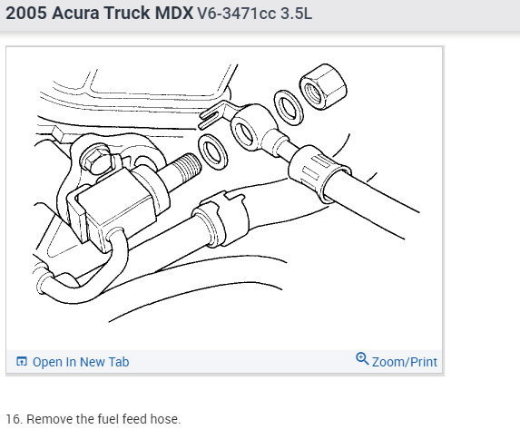

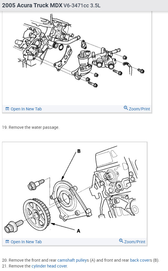

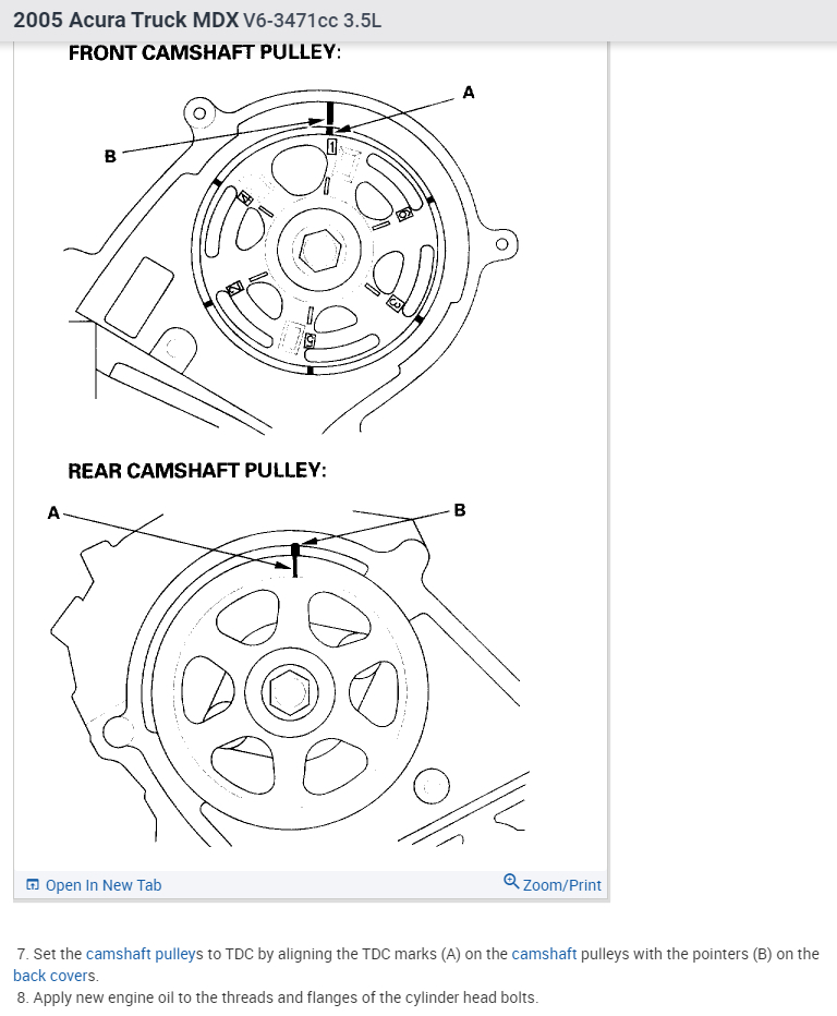

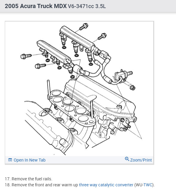

I have a bent valve on my vehicle listed above from the timing belt failure. I need the procedure to remove and reinstall the heads after I get them back from the machine shop.
Oct 12, 2021 at 7:52 AM
SQM
  • 6,383 POSTS

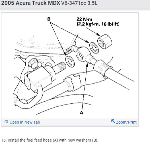

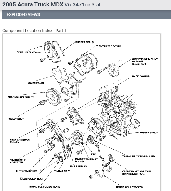

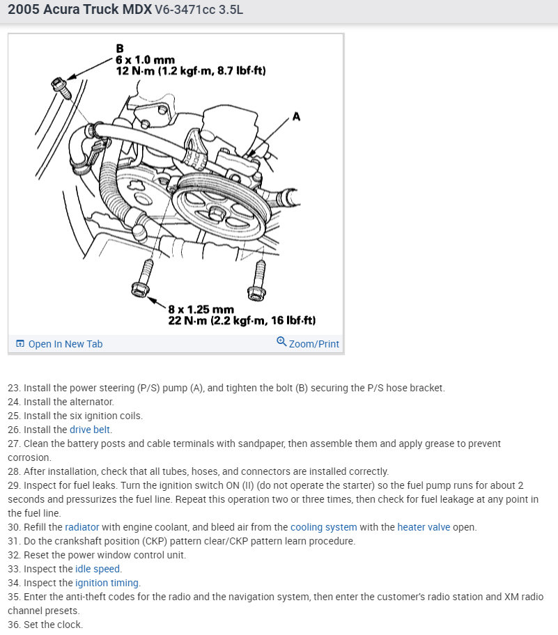

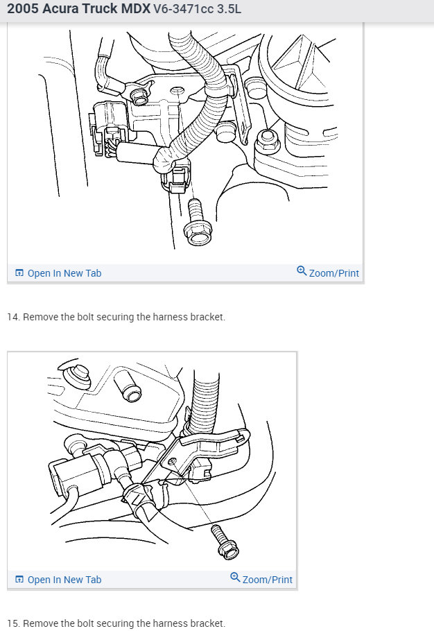

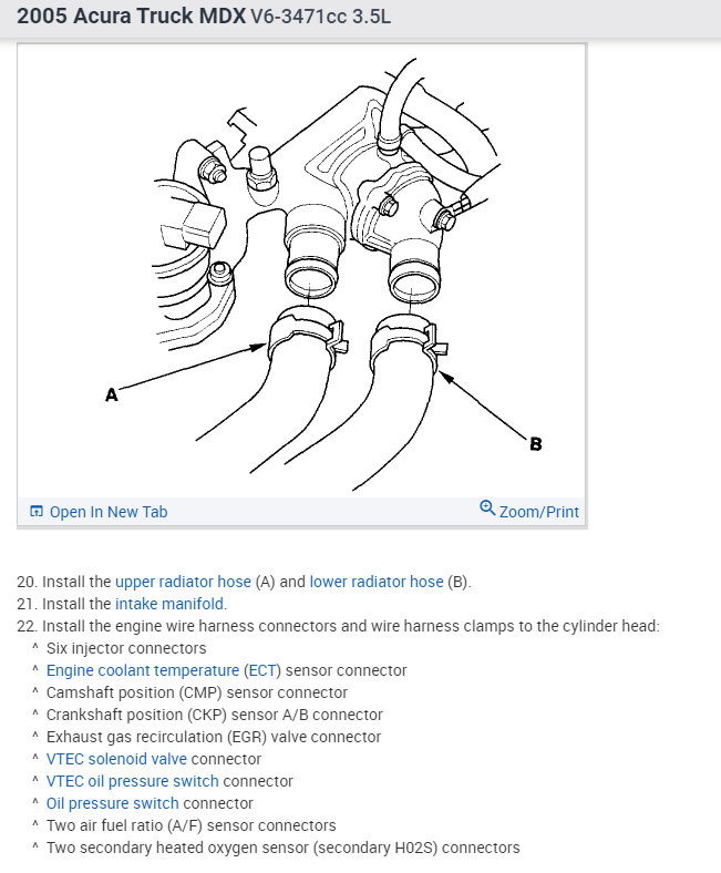

Look below for the cylinder head replacement procedure, including the torque specification and sequence.
