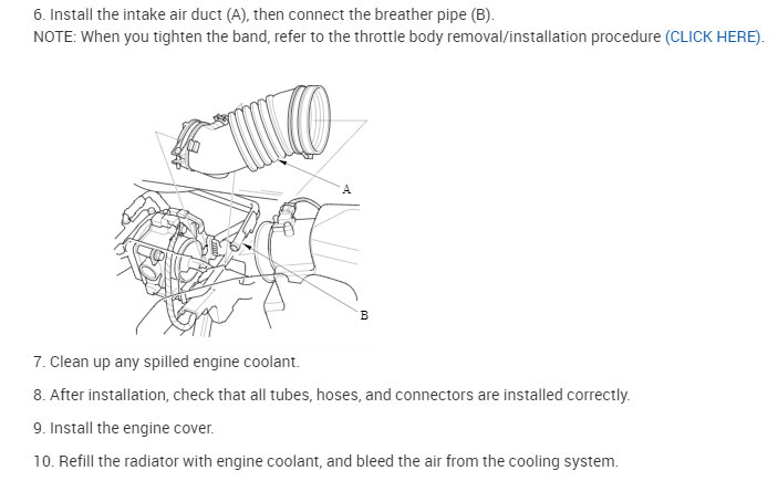

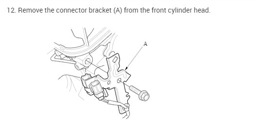

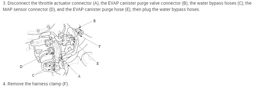

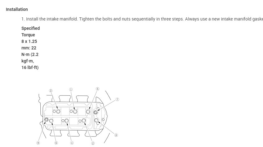

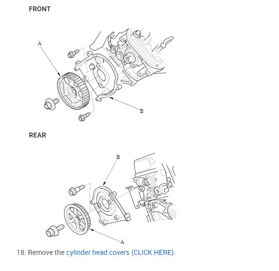

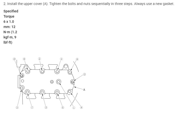

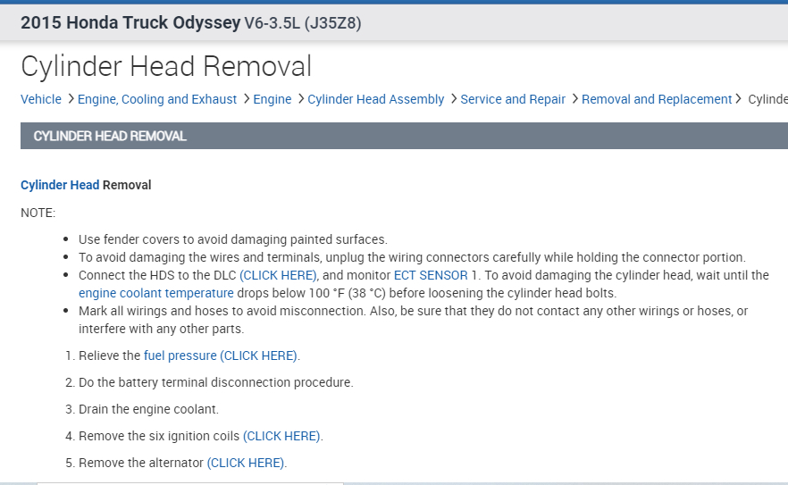

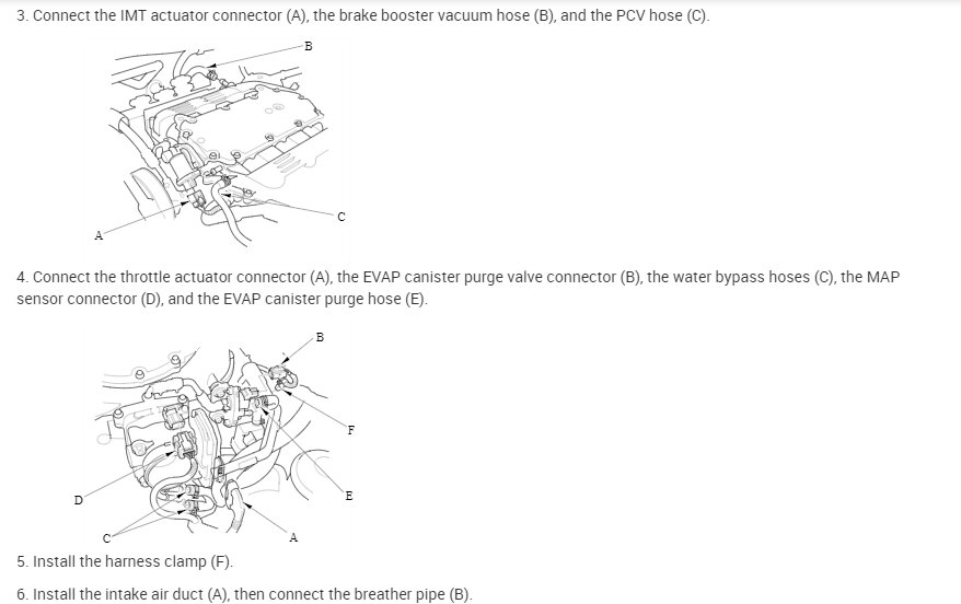

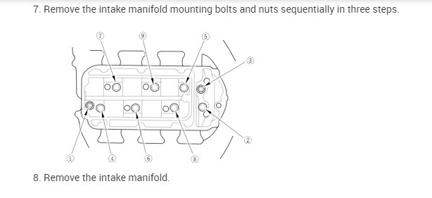

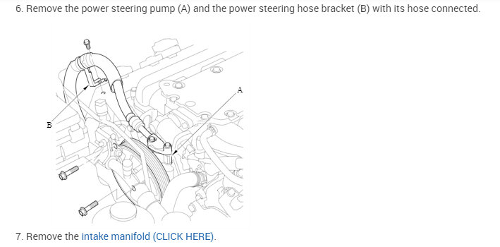

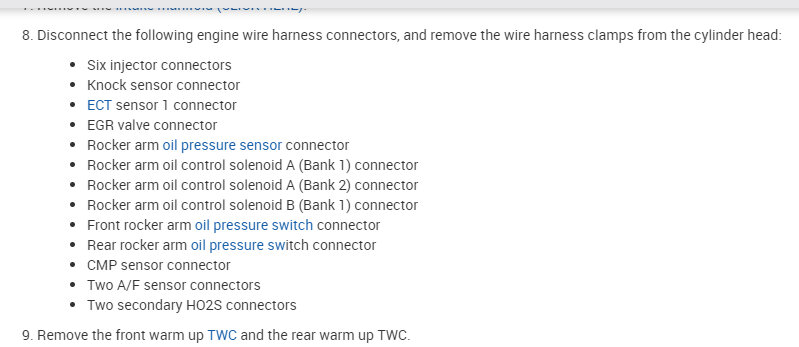

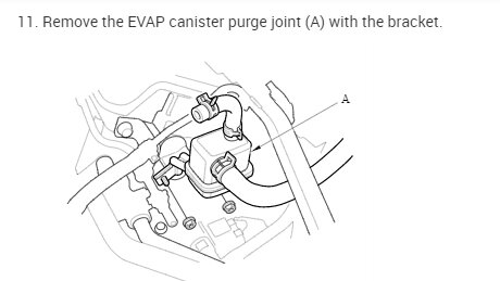

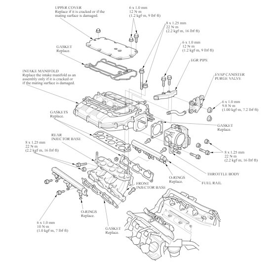

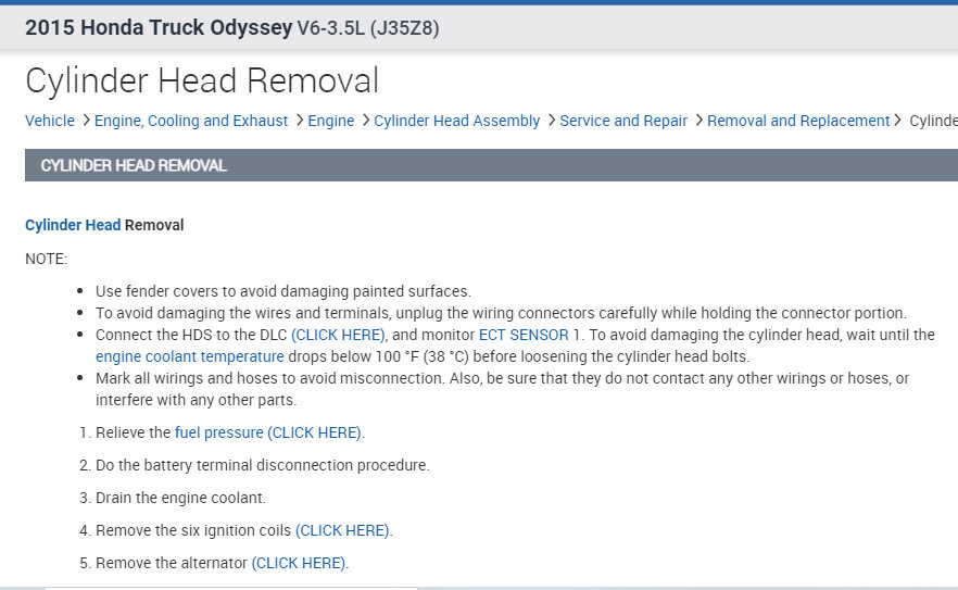

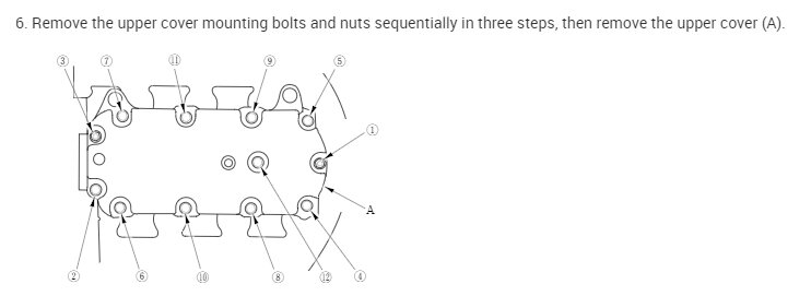

The Timing belt broke and bent valves, now I need to remove the heads, have a valve job and replace the heads.
Procedure for removing the heads with the engine in the vehicle would be very helpful.
Nov 7, 2022 at 5:37 PM
  • 110,190 POSTS

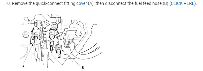

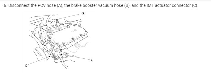

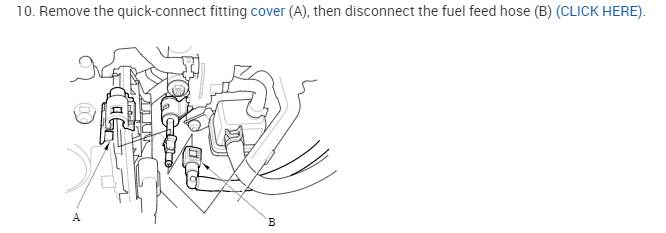

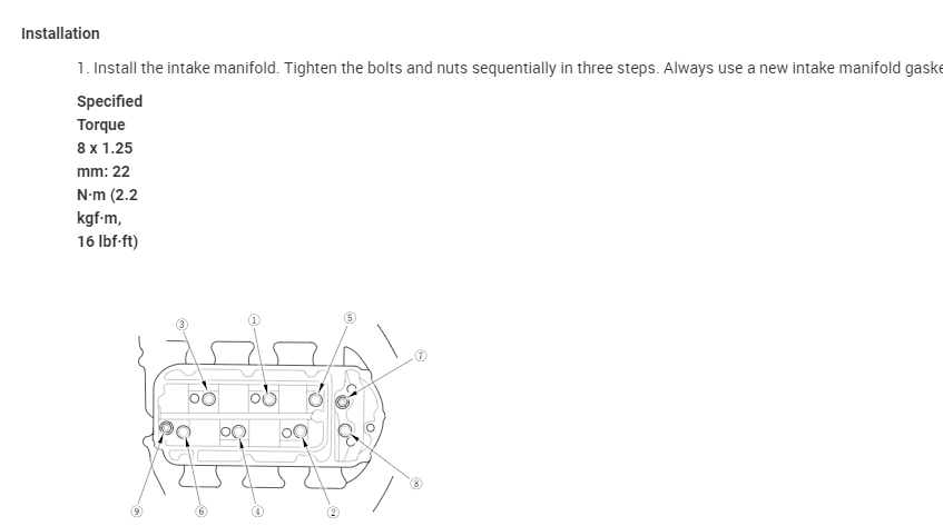

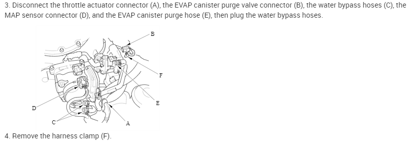

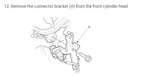

When you remove the head, make sure the pistons were not damaged. Check for cracks or anything that can prevent them from functioning as designed.

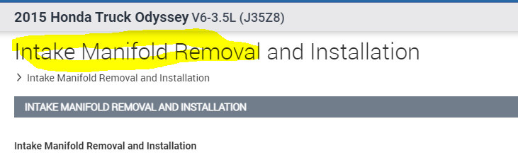

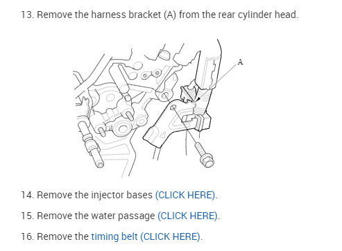

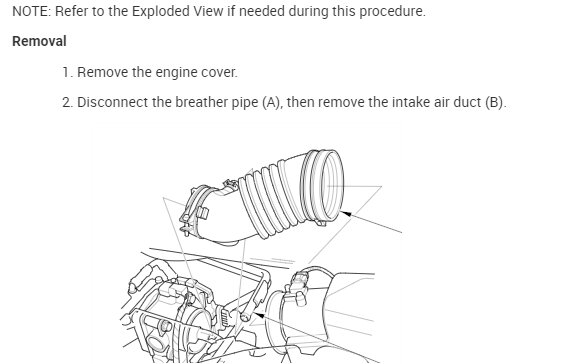

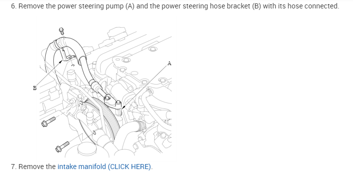

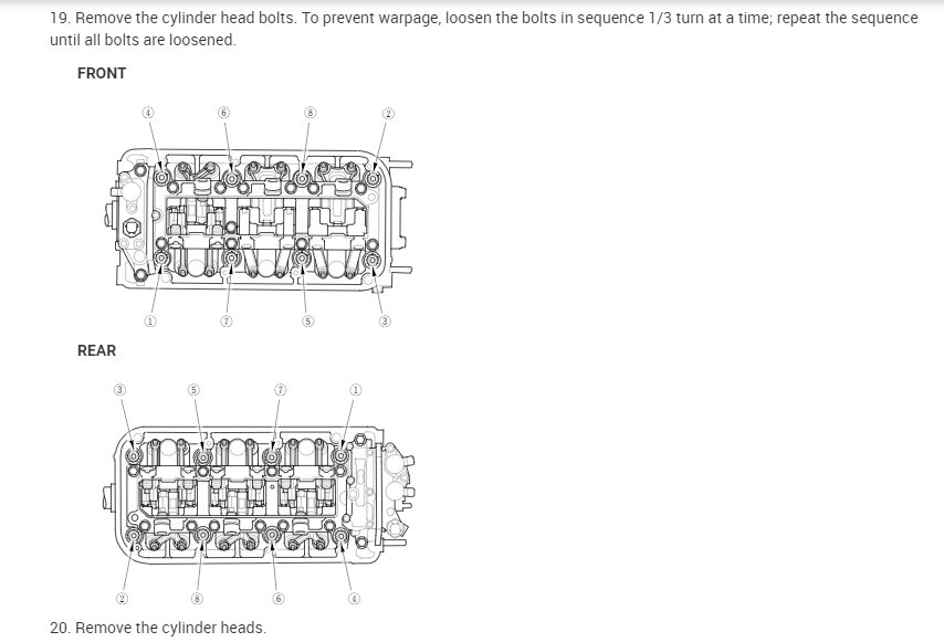

As far as the directions, I attached them below. You need to remove both the upper and lower intake manifolds. I added that in where it was needed.
See pics below. Also, let me know if you need help with the timing belt.
