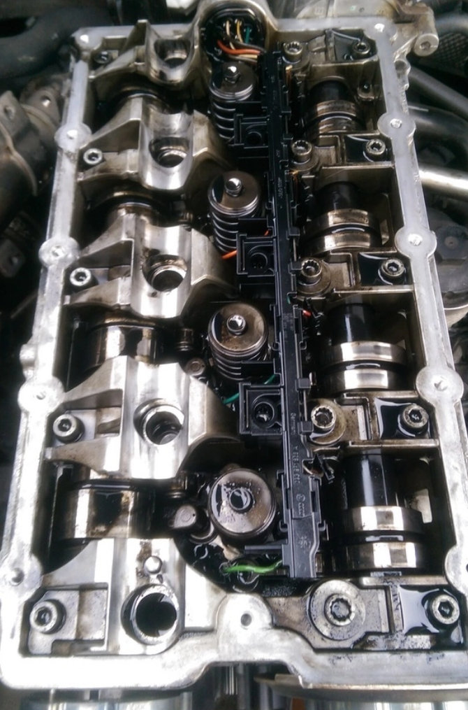

Hi, I've recently changed the head on my car listed above 20tdi. I put it all back together but when I bolt the injector rail down the cams lock up. I've changed the shell bearings encase it was that, but still no joy. please help it's really stressing me out.

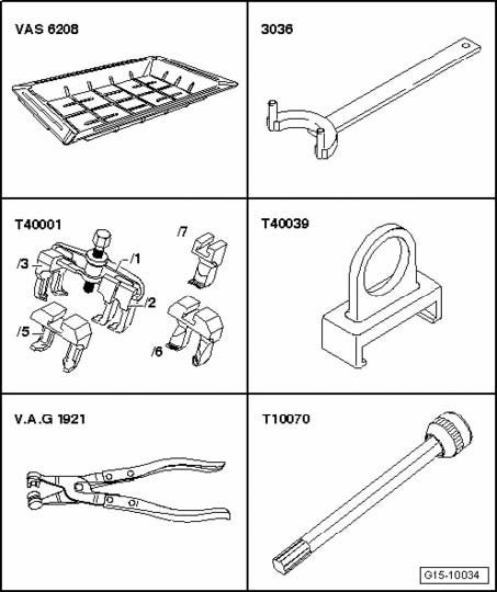

Special tools, testers and auxiliary items required
Picture 1
^ Drip tray for workshop crane VAS 6208
^ Counter-holder tool 3036
^ Puller T40001
^ Puller T40039
^ Hose clamp pliers V.A.G 1921
Pin wrench T10020

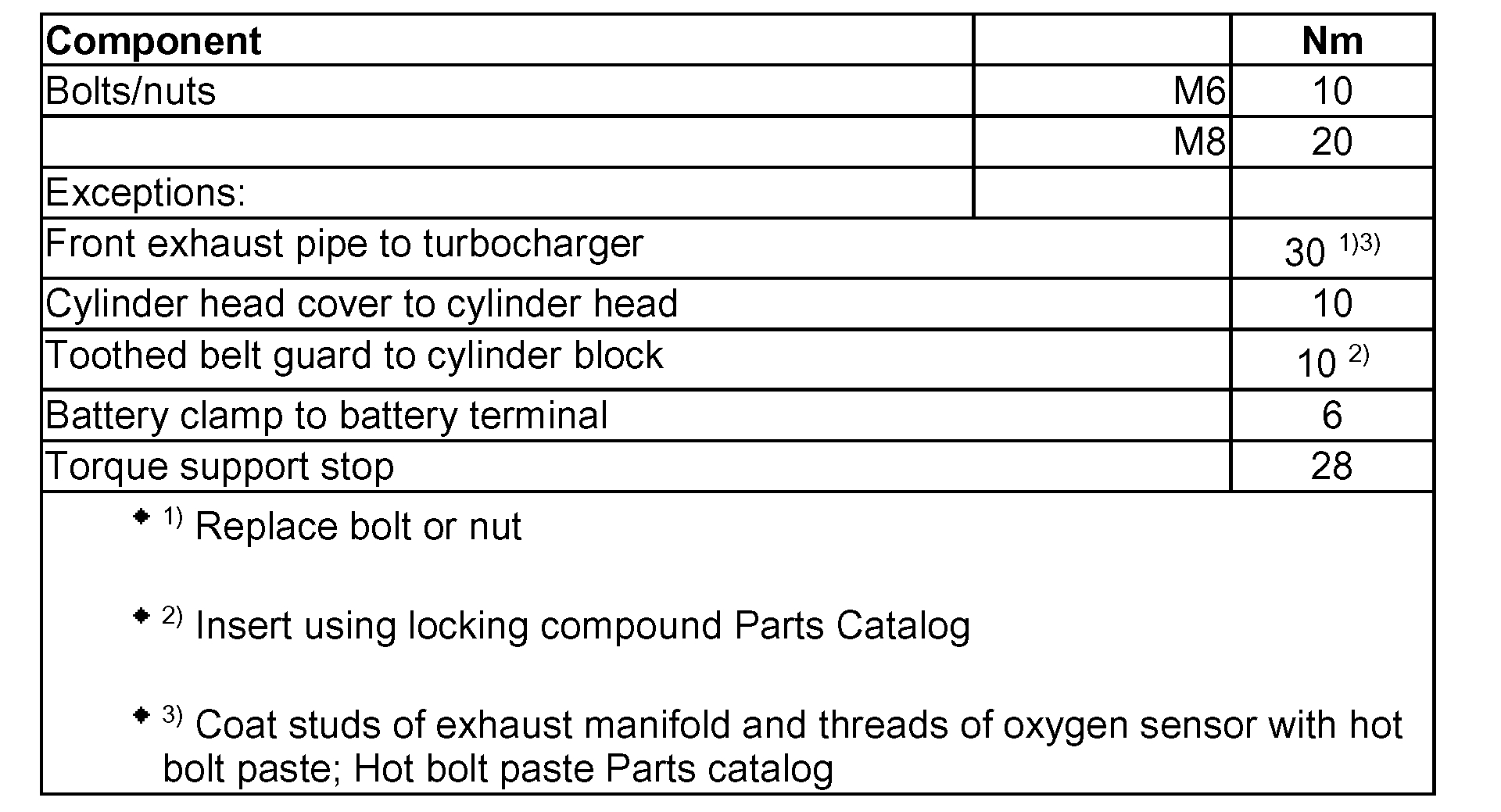

Picture 2
Drift T40098

Hi there, thanks for your reply. I've done everything in your step by step guide, but I don't know if it makes any difference, but my car is twin cam 16V.
Feb 22, 2019 at 5:04 PM
  • 110,241 POSTS
Welcome back:
If I understand, when you install the fuel rail/injectors, the cams lock up. Can you see anything that is making contact? That doesn't really make sense.
Are you using all the same hardware (bolts) to reinstall?
Feb 23, 2019 at 8:34 AM
TONYP247
  • 5 POSTS

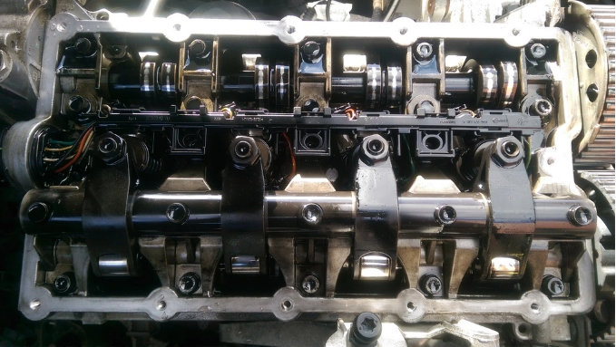

I'm using all new bolts and the only thing that makes contact is the injector rockers. If I loosen the bolts that hold the rail down the cams turn freely it's doing my head in and help would be so appreciated many thanks tony
Feb 23, 2019 at 11:21 PM
  • 110,241 POSTS
Do me a favor, take a picture of where it is hitting, where it bolts. anything you can think of that may help. If they are touching when bolted, something is missing. Are you sure there were no spacers? Take a look at picture 1 and tell me what is touching the cam. You have me confused because the injectors shouldn't be near the cam. They are on the side of the engine under the intake. See picture 1. Picture 2 is of the injector. Which part is hitting?
Feb 24, 2019 at 8:17 AM
TONYP247
  • 5 POSTS

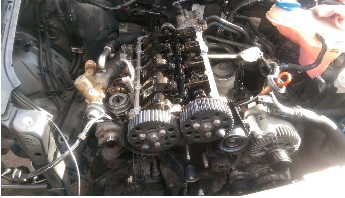

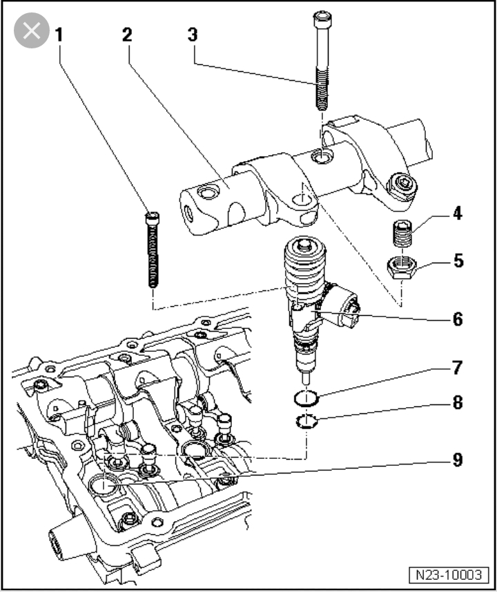

This is my engine so you understand what I'm talking about. The injectors are in between the two cams. I've sent a picture of the injector rail removed.
Feb 24, 2019 at 6:11 PM
  • 110,241 POSTS

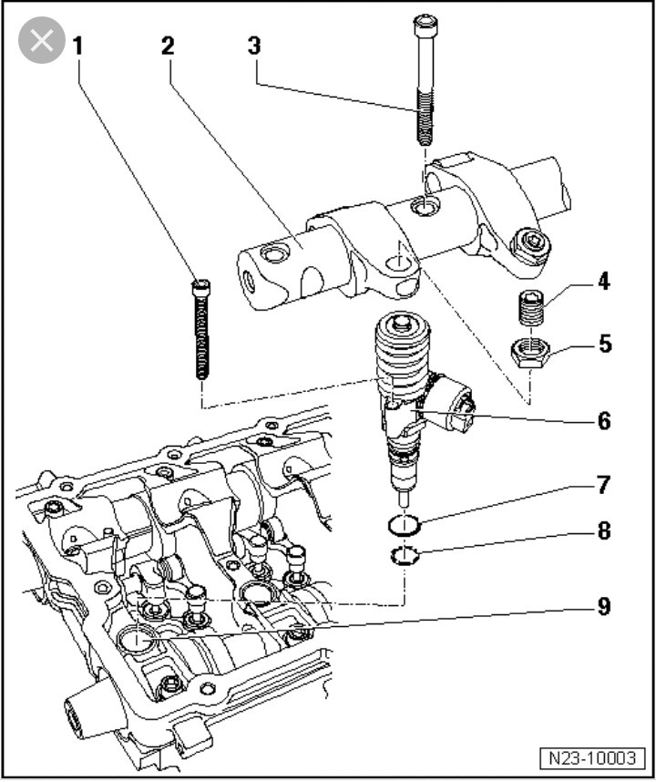

Here are the directions I have. Let me know if they help. Something isn't aligning when you do the install.
Installing
NOTE:
- Install a new Pump-Injector Unit, also replace the corresponding adjustment bolt in rocker arm.
- For each step which requires an adjustment of Pump-Injector Unit, adjustment bolt in rocker arm and also the ball pin for Pump-Injector Unit must be cleaned and examined for traces of wear. If there is wear, ball pin and adjustment bolt must be replaced.
- Grease contact surface between ball pin and adjustment bolt with G 000 100.
- New Pump-Injector Units are shipped with O-rings and heat protection seal.
- If old Pump-Injector Unit is re-installed, the O-rings and heat protection seal must be replaced.
- Before installing Pump-Injector Unit, check that the three O-rings, heat protection seal and securing ring are seated properly.
NOTE: O-rings must not be twisted on themselves.
- Oil O-rings and insert Pump-Injector Unit with great care into cylinder head seat.
- Drive Pump-Injector Unit in using uniform pressure into cylinder head seat until stop.
- Insert tension block into lateral slot of Pump-Injector Unit.
NOTE: If Pump-Injector Unit does not stand at right angle to tension block, securing bolt can loosen and thereby cause damage to Pump-Injector Unit / cylinder head.
- Align Pump-Injector Unit as follows.
- Screw in the new securing bolt as far into tension block so that the Pump-Injector Unit can still be turned lightly.
- Now align Pump-Injector Unit at right angle to thrust bearing of camshaft.
- Using a caliper gauge (measuring range minimum 400 mm), check dimension "a" from outer edge of cylinder head to round surface of Pump-Injector Unit.
- Re-align Pump-Injector Unit if necessary and tighten securing bolt as follows:
- Tighten securing bolt to 12 Nm and 270 degree (3/4 turn) (additional rotation can occur in several stages).
- Install rocker arm axle and tighten new securing bolts as follows:
- Tighten inner bolts -2- hand-tight, then outer bolts -1-. Then in the same sequence,
Tighten to 20 Nm plus an additional 90 degree (1/4 turn).
- Set a dial gauge onto adjustment bolt of Pump-Injector Unit
- Rotate crankshaft in direction of engine rotation until rocker arm roller stands at camshaft top.
Roller side (arrow -A-) stands at highest point
Dial gauge (arrow -B-) stands at lowest point
- Remove dial gauge.
- Now turn adjustment bolt into rocker arm until significant resistance is noticeable (Pump-Injector element stands at stop).
- Turn back adjustment bolt from stop approx.
225 degree.
- Hold adjustment bolt in this position and tighten lock nut to
30 Nm.
- Connect connector to Pump-Injector Unit and install cylinder head cover and toothed belt guard.
See if this helps.
