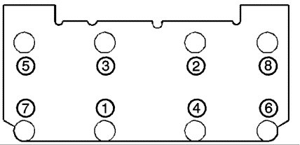

Cylinder head bolts specs
2002 PONTIAC GRAND AM
200,000 MILES • V6 • FWD • AUTOMATIC
KIM REIMANN
In foot pounds.
Oct 7, 2016 at 4:06 PM
JIS001
  • 3,412 POSTS
44 foot pounds plus an additional 95 degrees on second step.
