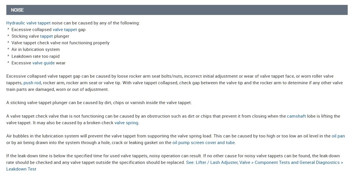

The diagram below was in service info for this vehicle, which was just listed as "Noise". But here is one of our guides to engine noises as well:
https://www.2carpros.com/articles/engine-noises
