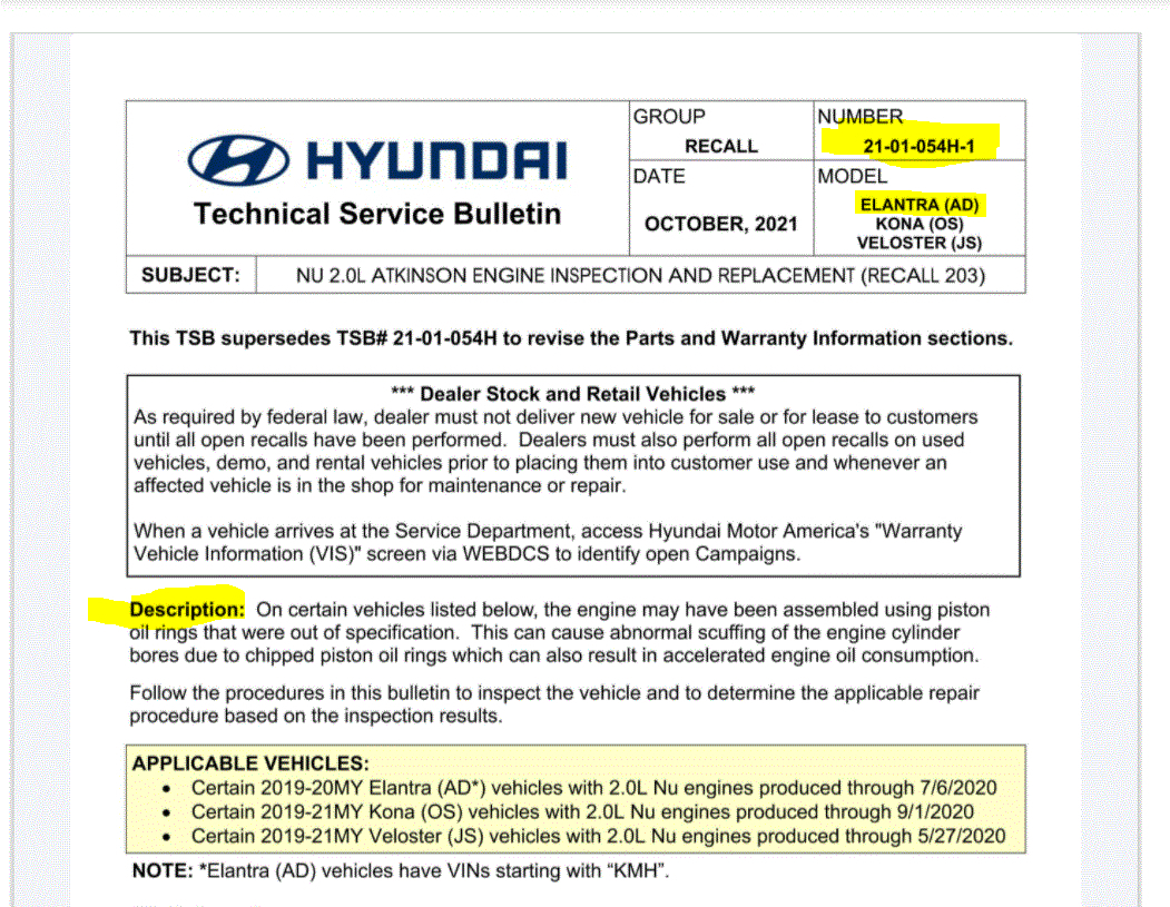

So, basically the reason I'm asking is because there was a recall notice sent out about the piston oil rings being produced with inconsistent heating and then it'll explain all the things that could make go wrong with your problem with your car. And we took it into the shop, and they said everything was fine, that's fine, and 2 months later the car was not knocking the oil was almost empty. I'm trying to figure out if when they supposedly check to see if our car was one with that issue if they actually did. Because if they, did it makes absolutely no since that in 2 months somehow all of the oil just disappeared. Because now it's going to need its second new engine because the engine seized up at 10,000 miles and they rebuilt it. The thing is no oil light came on no light of any kind came on.
Mar 25, 2022 at 9:43 AM
  • 110,240 POSTS

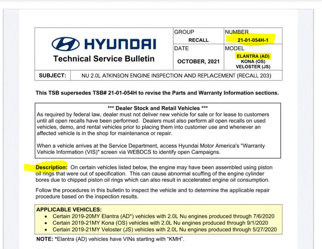

Hi Carrie, how did they base their decision? What you described is exactly what was happening on these engines. The oil rings were faulty causing excessive usage. The engine oil would be exhausted way too fast. Just for curiosity, how many miles were on the specific oil change when you found it low? This sounds 100% like a warranty claim.
Take a look at the pic below. Is that the recall you got?
If it is, I need to know the 8th digit on the vehicle's VIN number starting from the left.
See pic below.
Mar 25, 2022 at 12:03 PM
CARRIE PANNELL
  • 6 POSTS
The 8th is an F. And yes, the recall notice I got was something similar to that. Like I said they either didn't actually check, or they did check and didn't put any oil back in after they checked because those are the only 2 possibilities that make any sense to me.

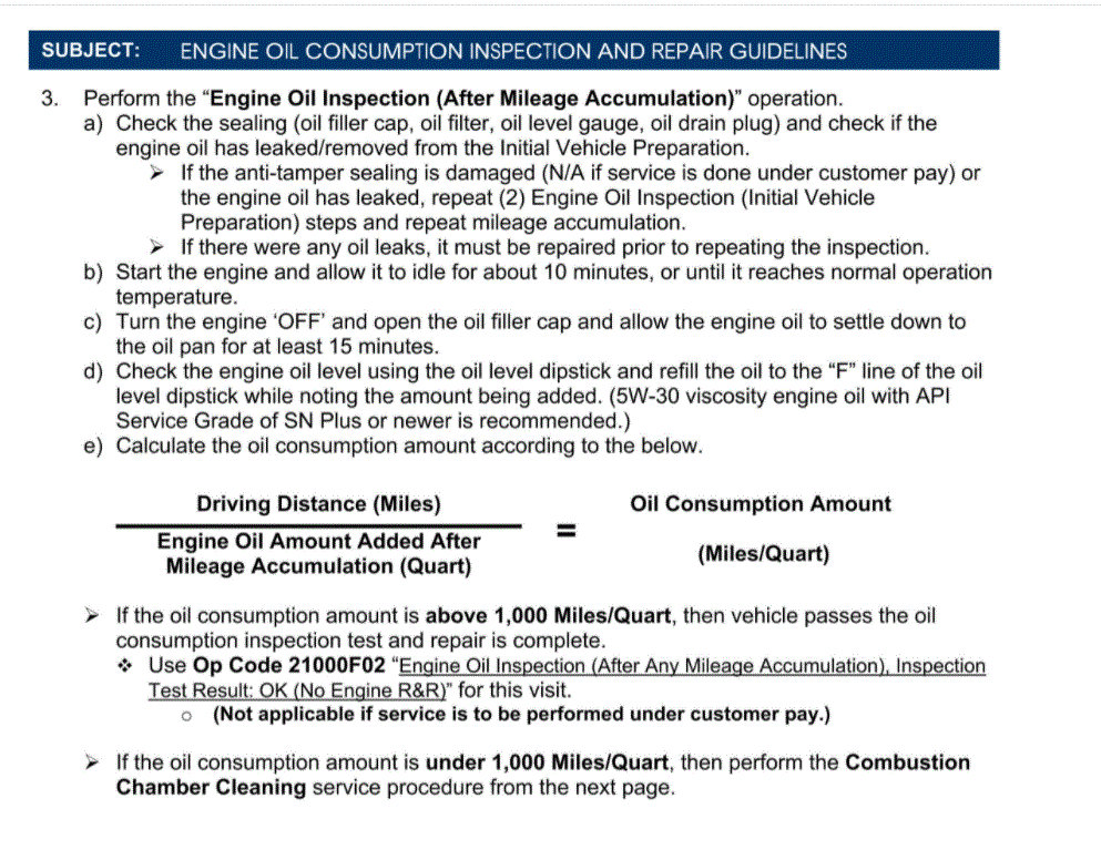

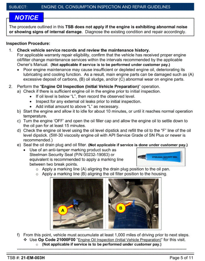

Okay, I just wanted to double check, in simpler terms, to check on the issue from the recall notice they would have needed to drain the oil, correct? If it's not too much trouble, could you give me an idea of the process that should be used to assess if my car needed to be fixed under that recall.
Thank you so very much,
Carrie
Mar 26, 2022 at 7:09 AM
  • 110,240 POSTS

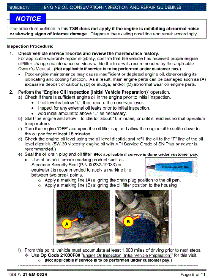

Carrie,
When it comes to testing, usually it is done based on oil consumption, and the engine isn't taken apart. When you mentioned the things that were checked, that isn't standard procedure for testing. What the dealer needs to determine is if the engine is using more than 1 quart of oil in less than 1000 miles. That is what constitutes a warranty and oil wouldn't have been removed. It should have been at the full mark when it left if they were performing the test. Then, you would have been asked to drive the vehicle for 1000 miles and return.
I have to ask. Has the oil been changed within the manufacturer's recommendations, and do you have records?
Also, you mentioned the engine was rebuilt prior. Was the original engine overhauled or did they replace it?
Also, I attached the test procedures below for you to review. This is part of the oil consumption recall.
Let me know if this answers your questions.
See pics below
Mar 26, 2022 at 9:13 AM
