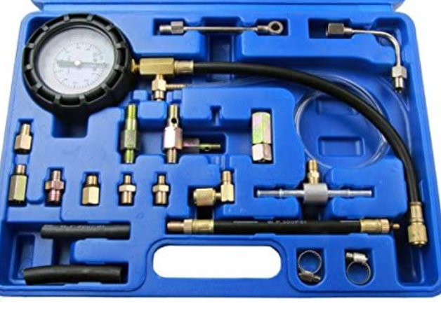

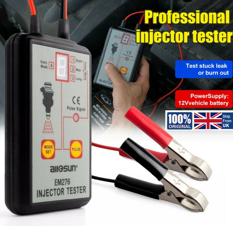

The fuel injectors can be tested by using a suitable scan tool and fuel pressure tester and carrying out an injector balance test. Alternatively, injector testers and fuel pressure gauges can be purchased online, see images below. No expensive diagnostic tool is required.
