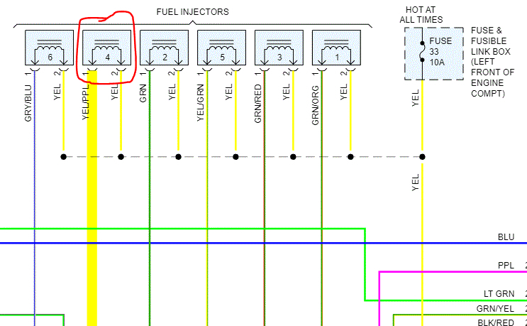

Swapped new plug wires and plug with number one. Cylinder four is still missing, so not wire or plug. Compression test passed. Getting some spark to wire harness as it clearly arcs to ground. The distributor cap and rotor are new. Missing limited to cylinder four only.

You indicated you got some spark to the wire harness. It arcs to ground. Where exactly is this happening?
Also, if compression is good and you are getting spark to the number 4-cylinder spark plug, the next thing would be related to the fuel injector.
I attached a portion of the wiring schematic below and circled the number 4 injector. Note that all injectors have a yellow wire. That wire will have 12v with the key on. Check and confirm the cylinder 4 injector is getting power.
If it is, we need to determine if the yellow wire with a purple tracer is providing a ground path. The best way to do this is with a Noid light. This type of light simply plugs into the connector and will strobe on and off if the circuit is working. If that isn't an option, you can use a test light to see if the circuit is being completed. Here is a link you may find helpful:
https://www.2carpros.com/articles/how-to-test-a-fuel-injector
If that tests good, you have spark to the plugs, and the compression is good, in this case, suspect the injector has failed or is plugged.
See pic below.
