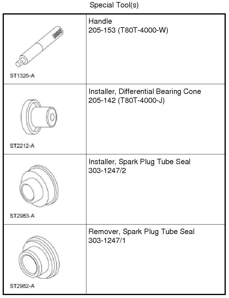

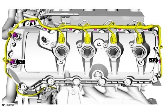

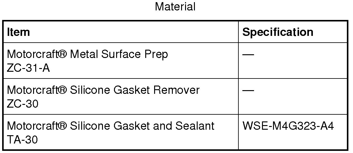

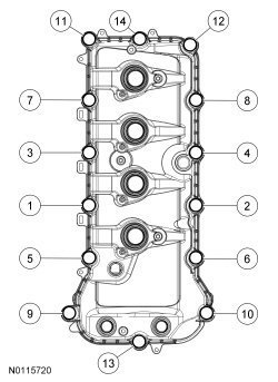

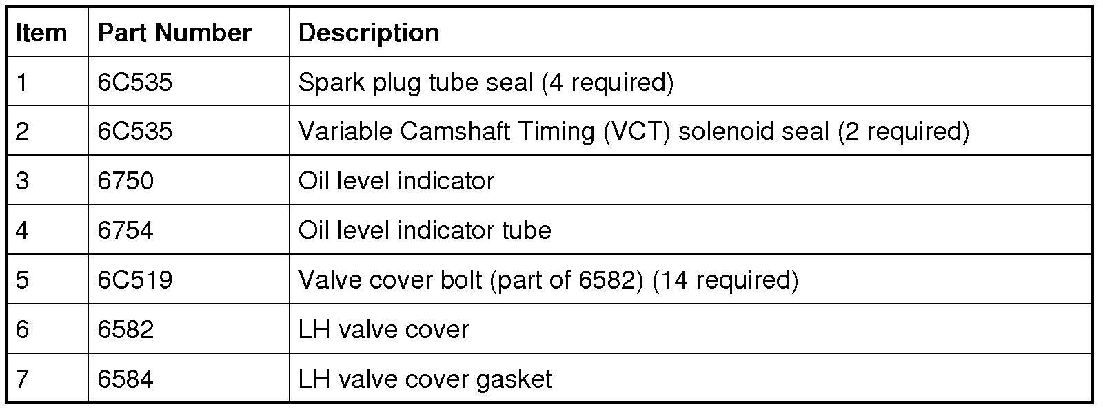

Here are the directions for removing the left side valve cover (cylinder 5). The attached pics correlate with the directions.
______________________________________________
2013 Ford Truck F 150 4WD V8-5.0L
Valve Cover - LH
Vehicle Engine, Cooling and Exhaust Engine Cylinder Head Assembly Valve Cover Service and Repair Removal and Replacement Valve Cover - LH
VALVE COVER - LH
Valve Cover
- LH
See pic 1 to 4
Removal
NOTICE: During engine repair procedures, cleanliness is extremely important. Any foreign material, including any material created while cleaning gasket surfaces, that enters the oil passages, coolant passages or the oil pan, can cause engine failure.
1. Remove the Air Cleaner (ACL) outlet pipe and the ACL (Air Cleaner) cover as an assembly.

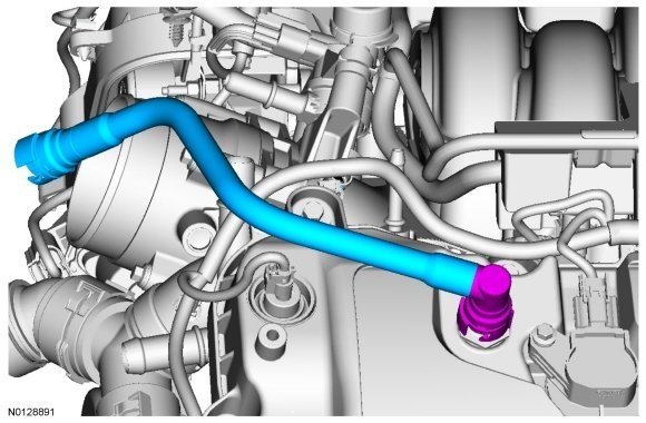

2. Remove the crankcase ventilation tube. For additional information, refer to the quick connect coupling procedure in Fuel Delivery and Air Induction.
pic 5

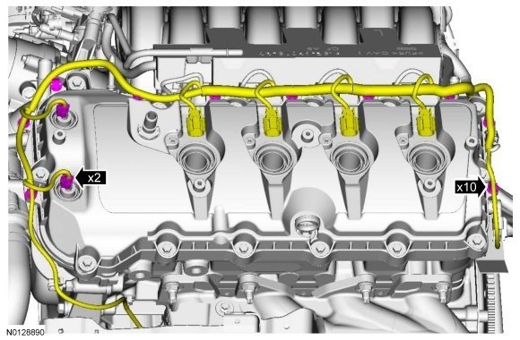

3. Remove the LH ignition coils. For additional information, refer to Ignition System.
4. Disconnect the 2 LH Variable Camshaft Timing (VCT) variable force solenoid electrical connectors.
- Detach the 10 wiring harness retainers.
pic 6
5. Remove the oil level indicator.
6. NOTICE: Do not use metal scrapers, wire brushes, power abrasive discs or other abrasive means to clean the sealing surfaces. These tools cause scratches and gouges which make leak paths. Use a plastic scraping tool to remove all traces of old sealant.

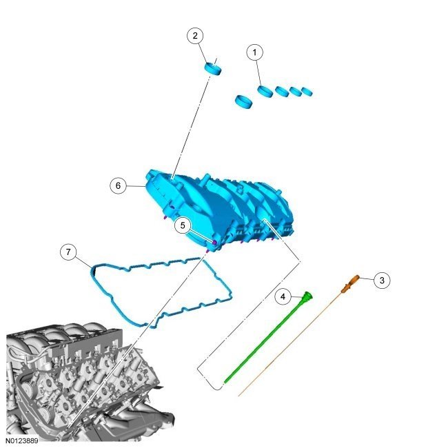

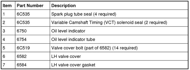

Loosen the 14 bolts and remove the LH valve cover and gasket.

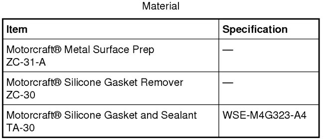

- Clean the valve cover mating surface of the cylinder head with silicone gasket remover and metal surface prep. Follow the directions on the packaging.
- Discard the valve cover gasket. Clean the valve cover gasket groove with soap and water or a suitable solvent.
7. Depress the 4 tabs and remove the oil level indicator tube.
pic 7
8. Inspect the 2 VCT (Variable Camshaft Timing) variable force solenoid seals. Remove any damaged seals.
- Using the Differential Bearing Cone Installer and Handle, remove the seal(s).
pic 8
9. Inspect the spark plug tube seals. Remove any damaged seals.
- Using the VCT (Variable Camshaft Timing) Spark Plug Tube Seal Remover and Handle, remove the seal(s).
pic 9
Installation
1. NOTE: Installation of new seals is only required if damaged seals were removed.
Using the VCT (Variable Camshaft Timing) Spark Plug Tube Seal Installer and Handle, install new spark plug tube seals.
pic 10
2. NOTE: Installation of new seals is only required if damaged seals were removed.
Using the Differential Bearing Cone Installer and Handle, install new VCT (Variable Camshaft Timing) variable force solenoid seal(s).
pic 11
3. NOTE: If the valve cover is not installed and the fasteners tightened within 5 minutes, the sealant must be removed and the sealing area cleaned. To clean the sealing area, use silicone gasket remover and metal surface prep. Failure to follow this procedure can cause future oil leakage.
Apply an 8 mm (0.31 in) bead of silicone gasket and sealant to the engine front cover-to-LH cylinder head joints.
pic 12
4. Position the LH valve cover and new gasket on the cylinder head.
- Tighten the bolts in the sequence shown to 10 Nm (89 lb-in).
pic 13
5. Install the oil level indicator tube.
- Push the oil level indicator tube into the valve cover until it clicks into place.
6. Install the oil level indicator.
7. Connect the 2 LH VCT (Variable Camshaft Timing) variable force solenoid electrical connectors.
- Attach the 10 wiring harness retainers.
pic 14
8. Install the LH ignition coils. For additional information, refer to Ignition System.
9. Install the crankcase ventilation tube. For additional information, refer to the quick connect coupling procedure in Fuel Delivery and Air Induction.
pic 15
10. Install the Air Cleaner (ACL) outlet pipe and ACL (Air Cleaner) cover assembly.

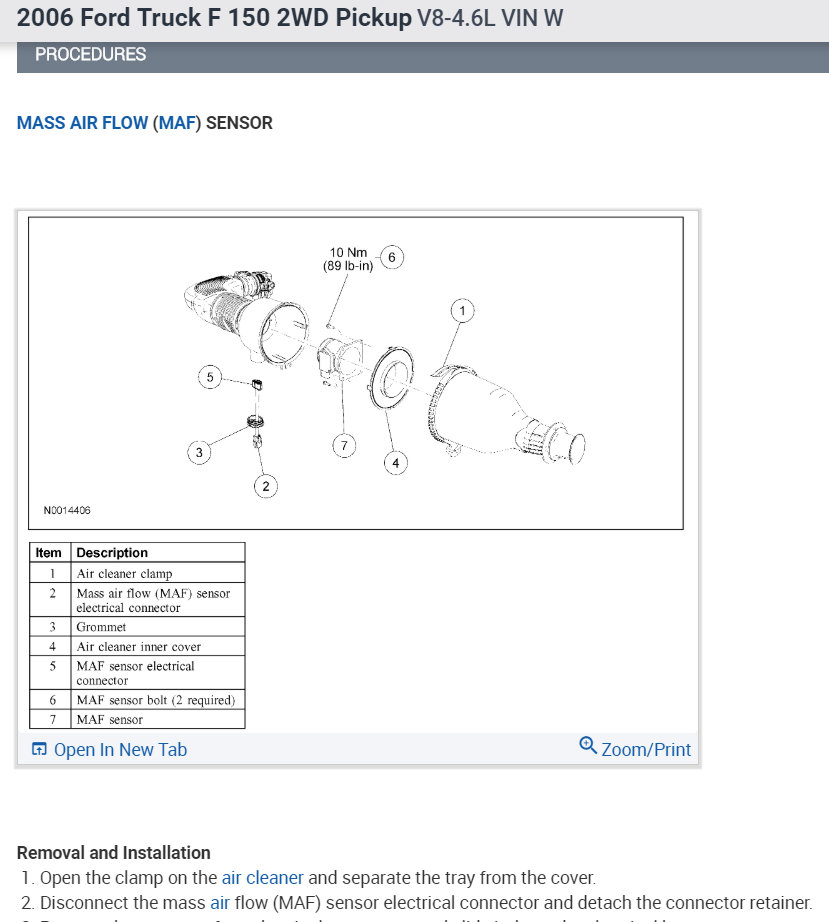

The first thing I would do is check the compression on one and if okay I would replace the MAF sensor with a new Motorcraft unit. Here is a guide to help you with the repair with diagrams below for your car:
and
https://www.2carpros.com/articles/how-to-replace-a-mass-air-flow-sensor-maf
May 10, 2021 at 3:46 AM (Merged)

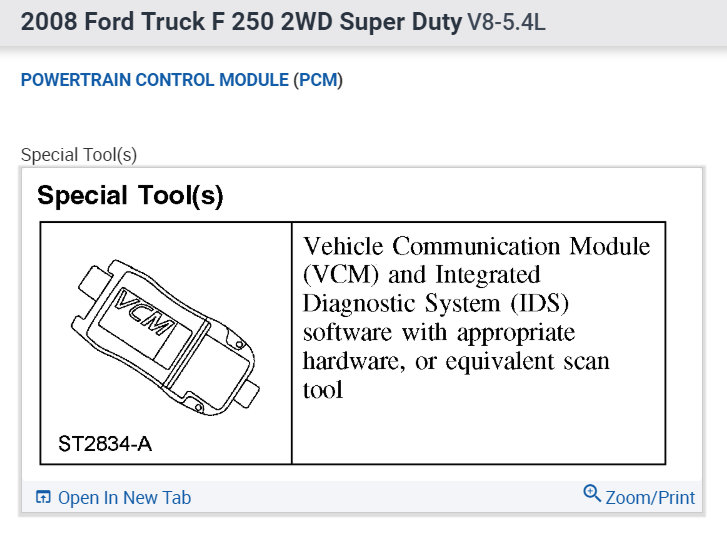

Well, first things first. you need to have the check engine light codes to be retrieved.If you don't have access to a code reader/scanner most auto parts store like AutoZone will check for free.Here is a tutorial showing what is involved retrieving check engine light codes:
After you have the codes checked please get back to us with the information to help us properly diagnose the truck.As far as fuel filter it's located on the left side of the frame rail inside about mid point. I've attached a picture.I would suggest getting the code(s) first before replacing fuel filter.Hope this helps and thanks for using 2CarPros.

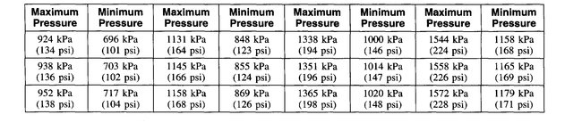

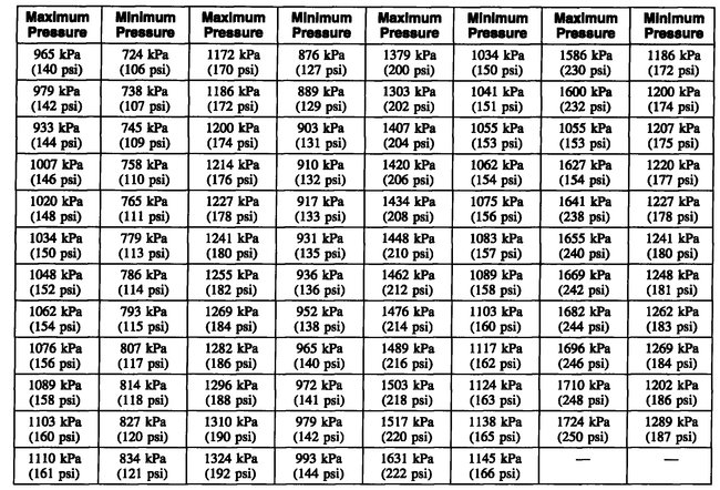

Here are the specifics for your vehicle when checking compression. The two attached pictures relate to your findings.
Compression Test-Compression Gauge Check
1. Make sure the oil in the crankcase is of the correct viscosity and at the correct level and that the battery is correctly charged. Operate the vehicle until the engine is at normal operating temperature. Turn the ignition switch to the OFF position, then remove all the spark plugs.
2. Set the throttle plates in the wide-open position.
3. Install a compression gauge such as the Compression Tester in the No. 1 cylinder.
4. Install an auxiliary starter switch in the starting circuit. With the ignition switch in the OFF position, and using the auxiliary starter switch, crank the engine a minimum of five compression strokes and record the highest reading. Note the approximate number of compression strokes required to obtain the highest reading.
5. Repeat the test on each cylinder, cranking the engine approximately the same number of compression strokes.
Compression Test-Test Results
The indicated compression pressures are considered within specification if the lowest reading cylinder is at least 75 percent of the highest reading. Refer to the Compression Pressure Limit Chart.
Part 1 Of 2
pic 1
Part 2 Of 2
pic 2
If one or more cylinders reads low, squirt approximately one tablespoon of engine oil on top of the pistons in the low-reading cylinders. Repeat the compression pressure check on these cylinders.
Compression Test-Interpreting Compression Readings
1. If compression improves considerably, piston rings are faulty.
2. If compression does not improve, valves are sticking or seating incorrectly.
3. If two adjacent cylinders indicate low compression pressures and squirting oil on each piston does not increase compression, the head gasket may be leaking between cylinders. Engine oil or coolant in cylinders could result from this condition.
Use the Compression Pressure Limit Chart when checking cylinder compression so that the lowest reading is within 75 percent of the highest reading.

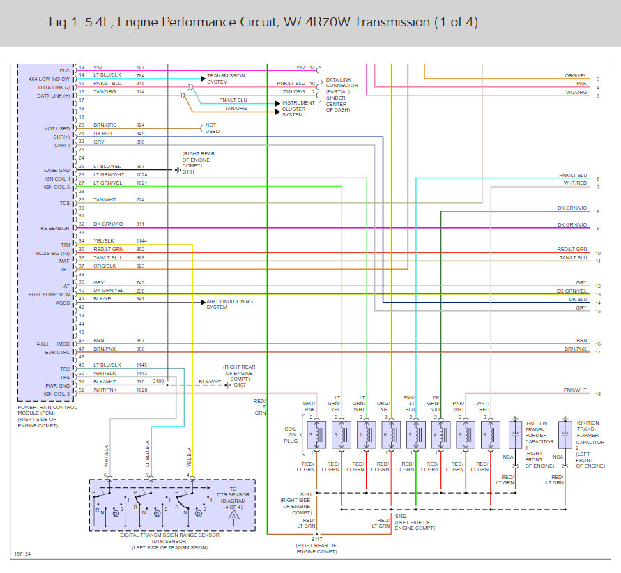

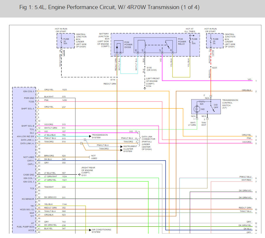

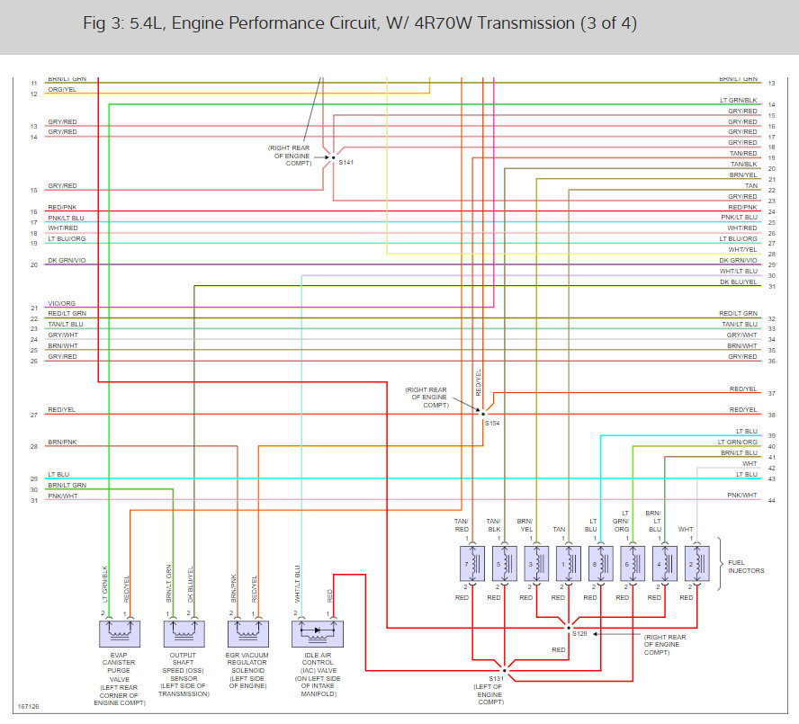

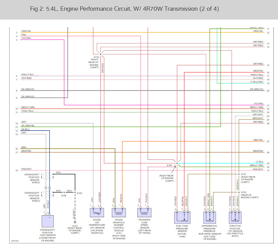

GRIZZ77
XLT model 5.4L V8. Recurring cylinder four misfire after eight new coils, eight new spark plugs, one new fuel injector on number four, compression test passed. Any ideas?
May 10, 2021 at 3:50 AM (Merged)
  • 110,248 POSTS
I would see if the injector and the ignition coil is getting pulse you could have a connection problem between the injector/coil and the PCM. Here is a guide to help you test the connections and confirm the injector coil operation:
https://www.2carpros.com/articles/how-to-test-a-fuel-injector
and
and
Here is the engine wiring diagrams so you can get started. Check out the diagrams (below). Please let us know what happens.
Cheers
REY-GTS
Thanks you so much. I figured out using the guide and the wiring diagrams I had a broken wire to the coil. A simple fix!
