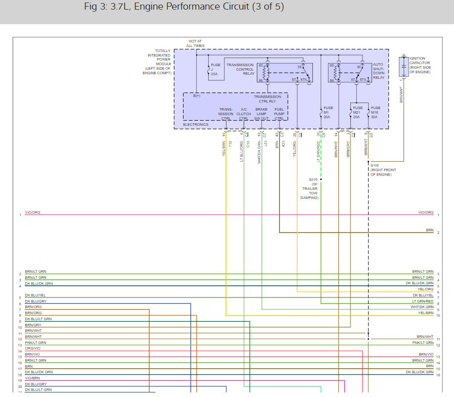

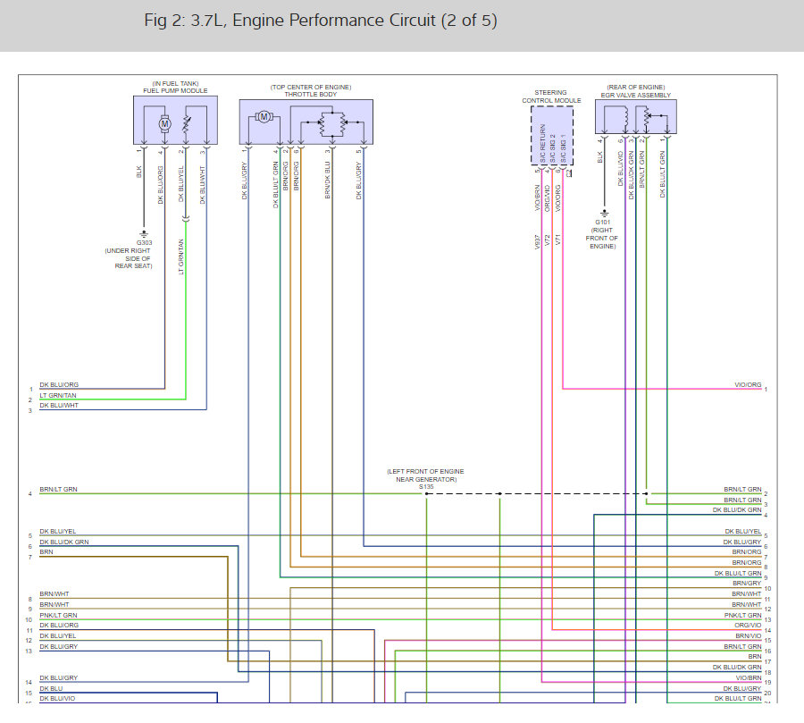

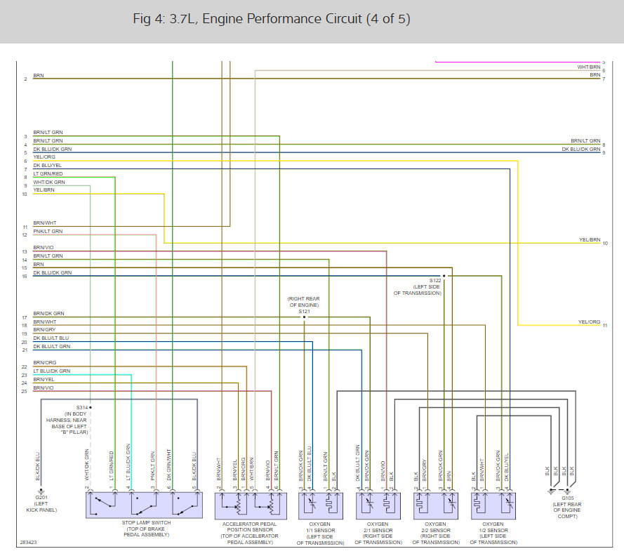

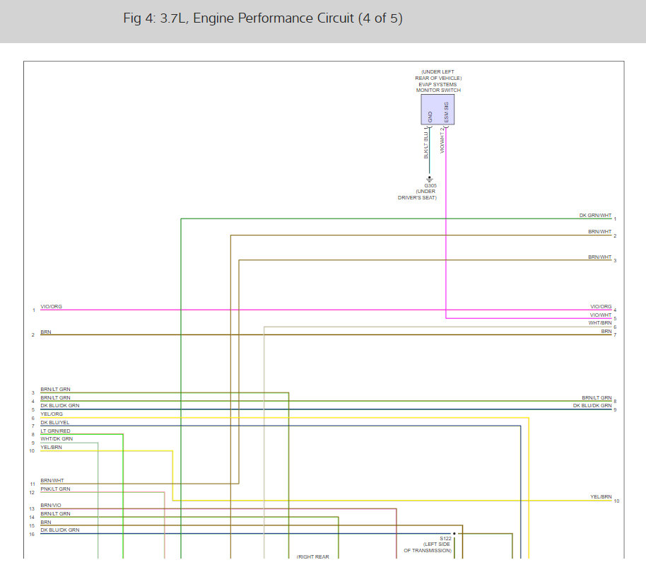

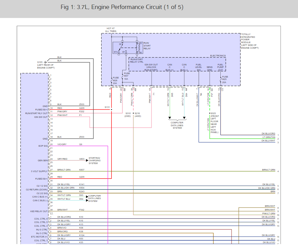

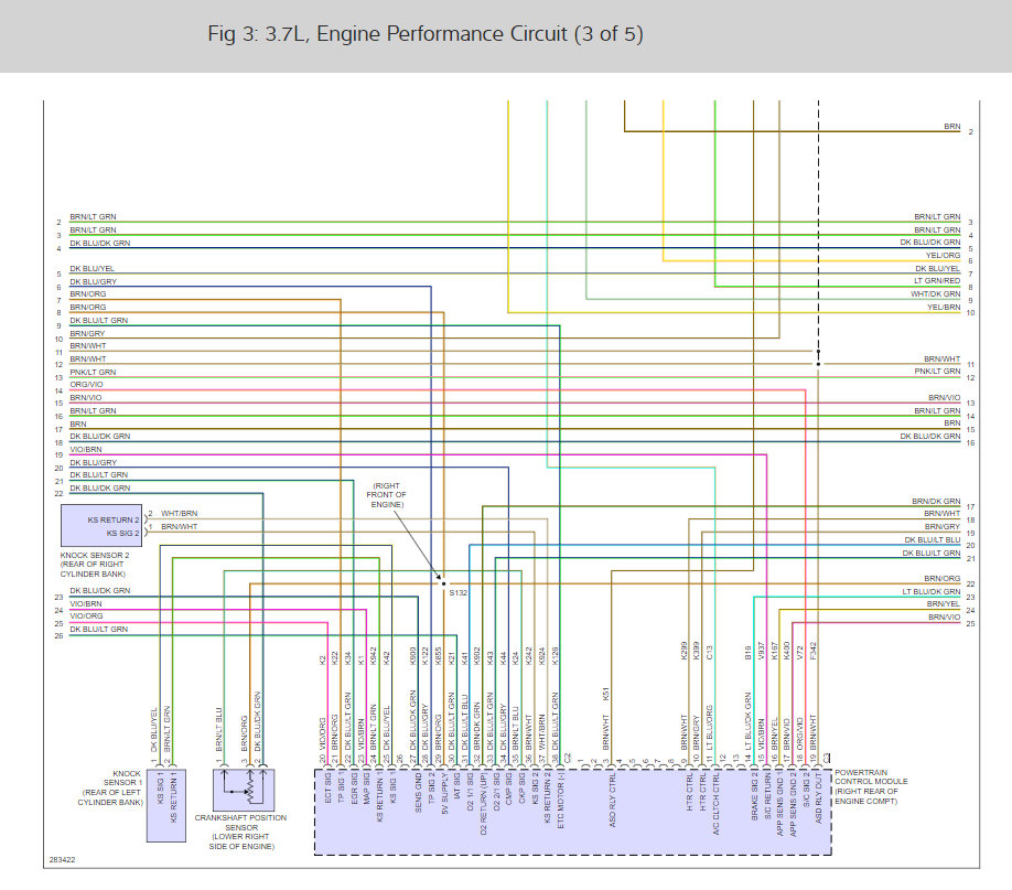

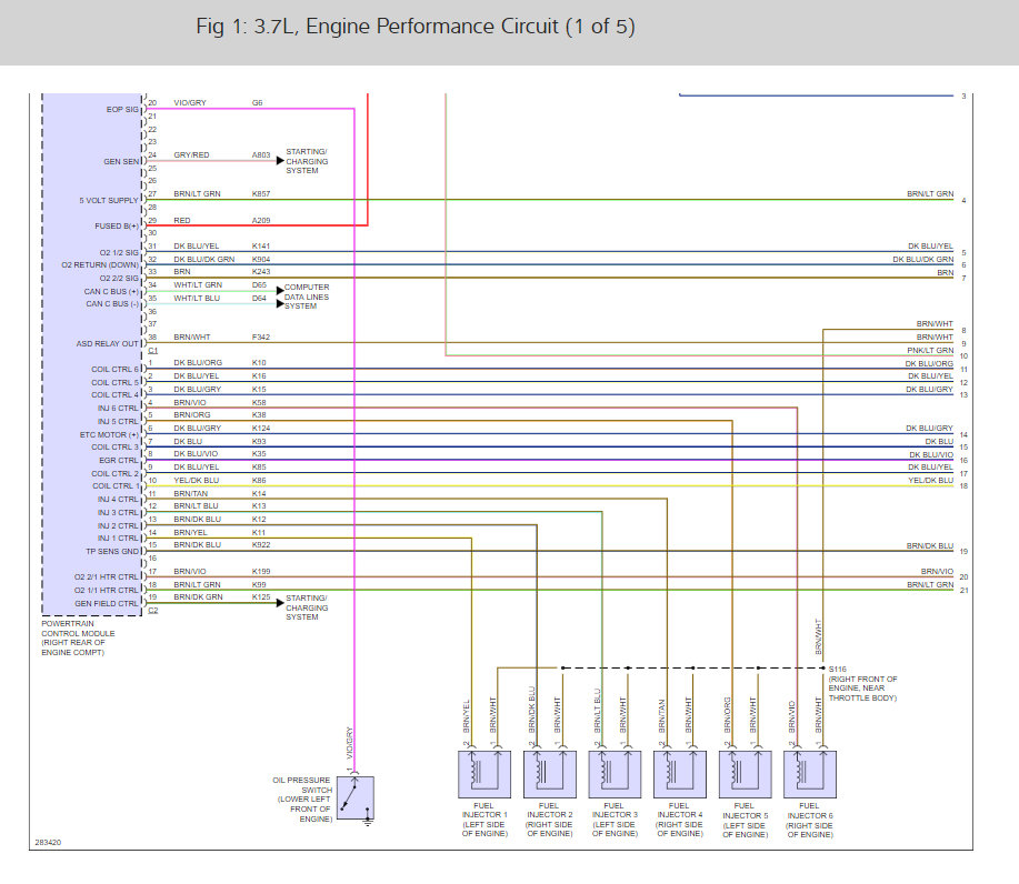

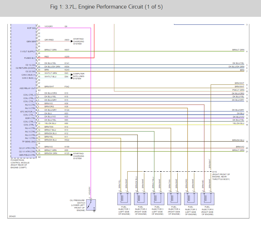

Where can I find a diagram for number four injector wire? I need to replace it. I am getting a cylinder four injector open/circuit. I used test light and it was dead. I did get the flashing on the positive side.

You could have an injector driver that has gone out in the PCM. But to be sure here is a guide to help you test the wiring and the engine wiring diagrams to help you see how it works and which wires to test:
