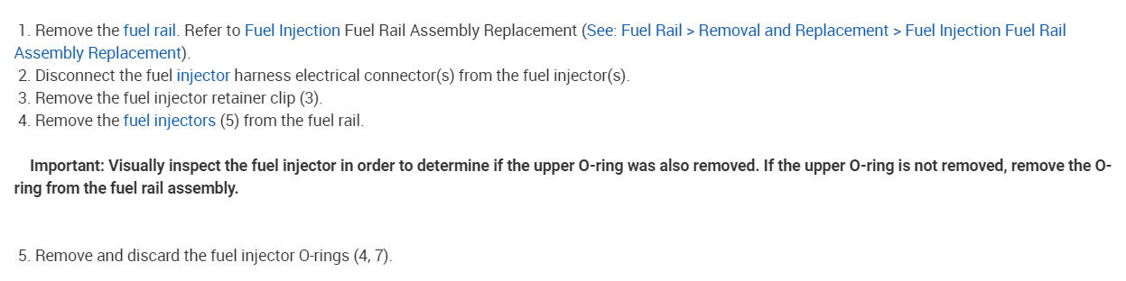

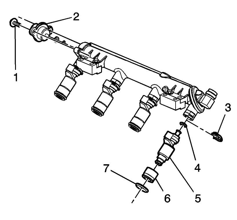

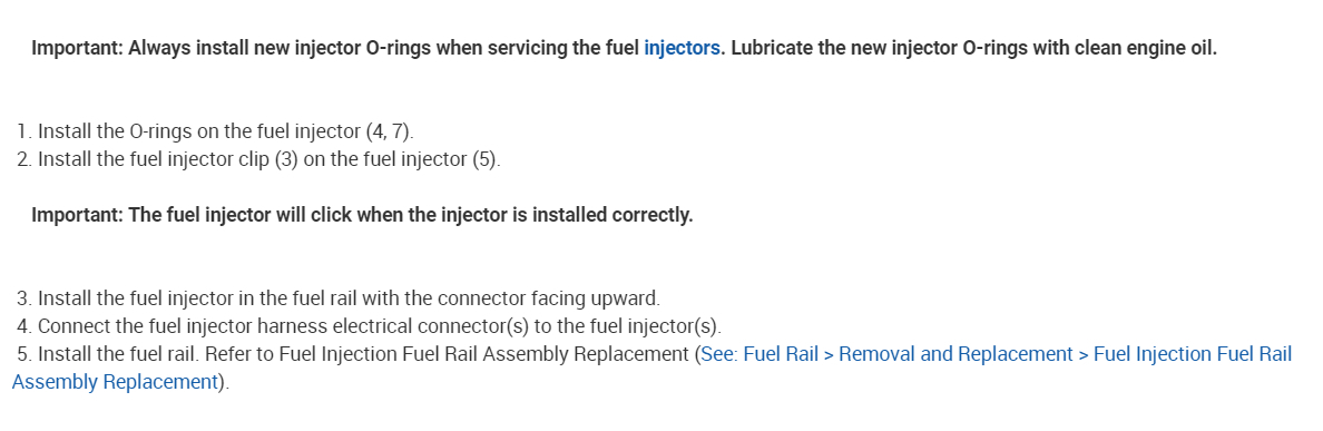

The Traction Control Light may come on because of the misfire. I would do a compression test and if okay I would swap out the fuel injector. Also, I would run the codes to see what comes up, you can get a CAN scanner (Controller Area Network) which will work on most cars from Amazon.

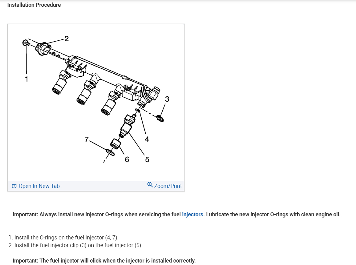

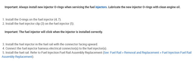

Here is a generic guide to help you step by step with instructions for the injector replacement, the diagrams below will show you how on your car:
https://www.2carpros.com/articles/how-to-test-a-fuel-injector
