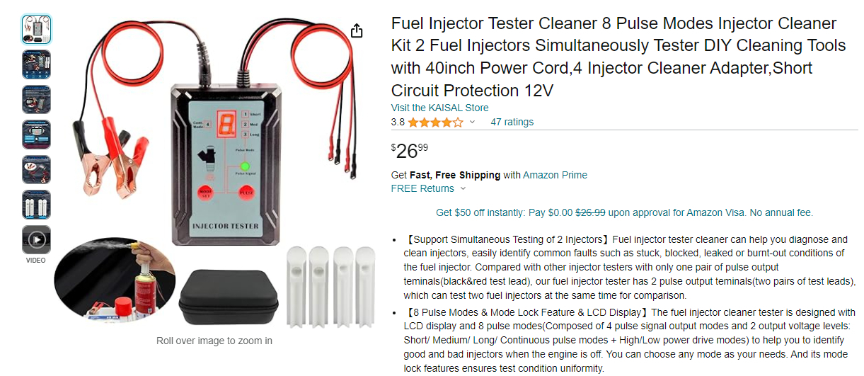

Another test you can do is a fuel injector balance test, where you will install a fuel pressure gauge on the rail and pulse each injector will a pulse tool for a certain number of milliseconds and watch how much pressure each injector drops. Ill post the tool for that as well, you can get one for around $30 on amazon, which will rule out the fuel injector without having to take out the spark plug.

This is a picture of the injector pulse tool, it hooks to the battery and you prime the fuel system by key On, to get the pressure up where it should be, Fords have a nice port on the fuel rail to put a gauge on, then pulse the injector at one of the 3 settings, they are all just different amounts of time, I use number 2 which I think is 50ms of 2.5ms pulses. And you write down how much the pressure dropped. Then re-prime the system and do the next injector. They should all be within 1-2psi of each other. This basically tells you the flow rate of each one. If there is a problem with the one on number 3, you know it's the injector and not the spark plug.

I will try the cadence test and I will see if any of the parts stores rent the injector pulse tool, or I'll consider buying one. It seems like it might be handy to have. The information on the vacuum leak around the injector o rings was very helpful. Thank you. I'm working on the truck for somebody who lives an hour away and I'm taking 10 days to head to the UP of Michigan so follow up may take some time. I'll definitely let you know what I find and I'll probably upload a video of the truck cranking.

Okay, the injector pulse tool is a must have if you're going to be working on vehicles, there's no other way to do an injector balance test, checking just resistance won't tell if the injector is flowing correctly compared to the rest of them. I own one of the $30 ones and have been using it for years, also a smoke machine for checking for intake vacuum leaks or Evap system leaks is important too. Otherwise, it will be just throwing parts at a vehicle, which gets expensive real fast. So, it's worth investing in some gear even to repair your own vehicles. Saves a ton of money in the long run.
