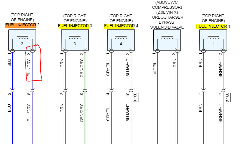

I have a misfire in cylinder 2, I've changed spark plugs, cylinder 2 coil and o2 sensor but didn't help at all. What's the next likely problem?

It could be a few things. Did you confirm there is spark to the number two spark plug after replacing the components? If not, do that first.
https://www.2carpros.com/articles/how-to-check-for-ignition-spark
Next, low compression or no fuel to the cylinder can cause this.
Do this. Disconnect the number 2 fuel injector and check the blue wire with a gray tracer for power. Do this with the key in the run position, and the engine off. See pic below.
Let me know what you find.
See pic below. Note: Checking the injector power is only necessary if you have ignition spark at the cylinder 2 plug. If there is no spark, this isn't needed.
