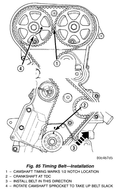

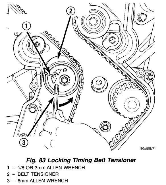

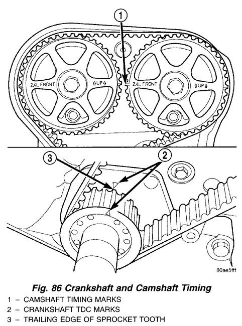

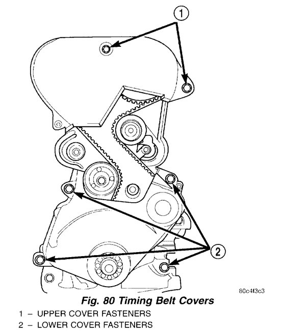

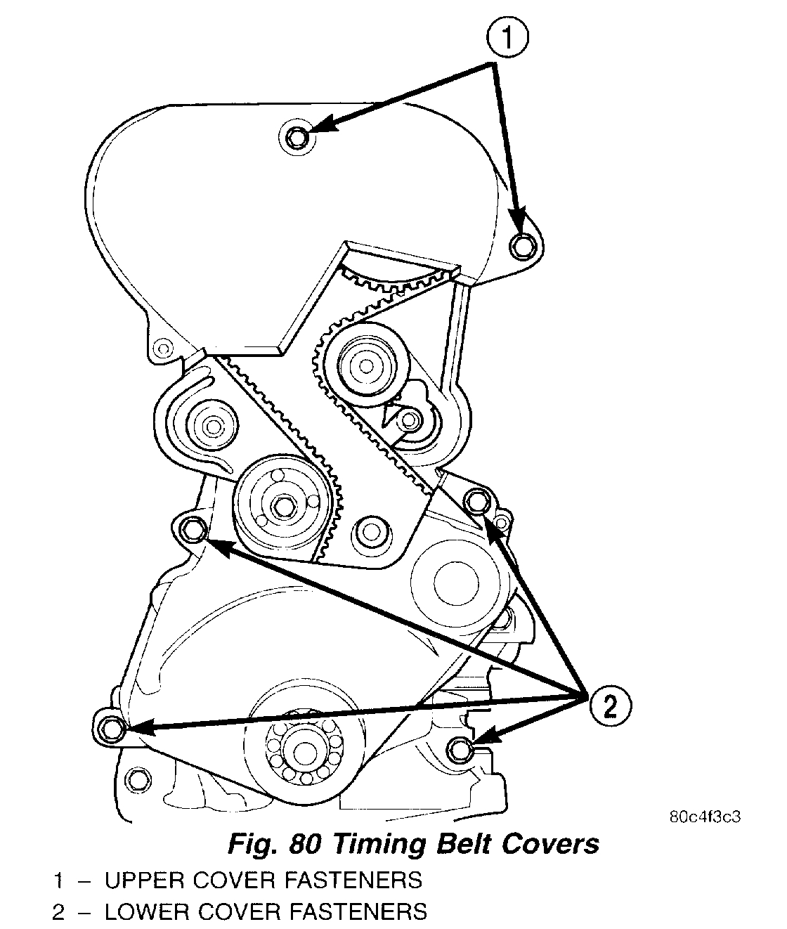

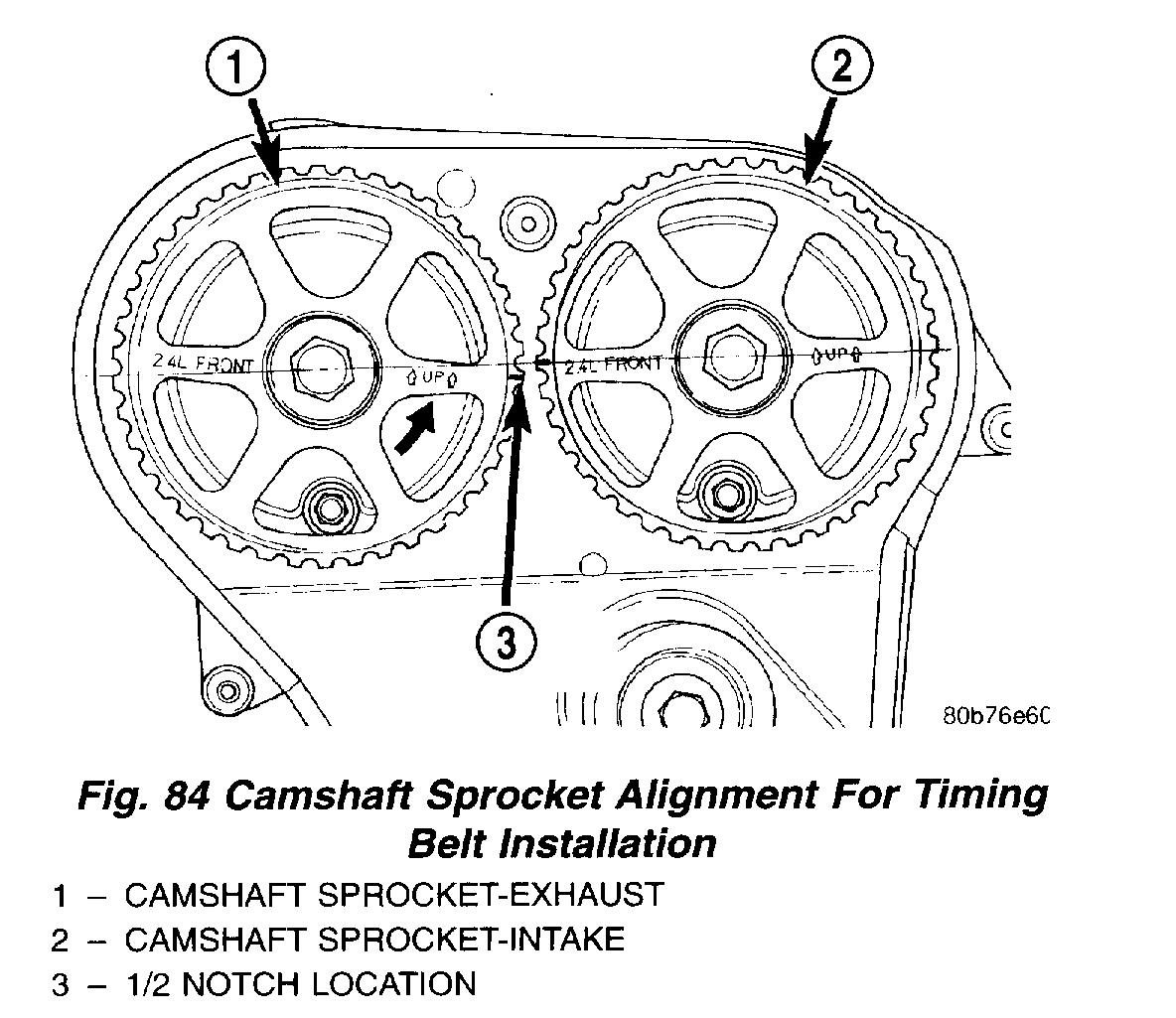

Recheck engine timing and let me know what you find. It sounds like you may have jumped time. One tooth off on the belt can be the issue. Here are the directions for belt replacement. I am providing it all because it shows all timing marks and repair information if needed. The attached pictures correlate with these directions.

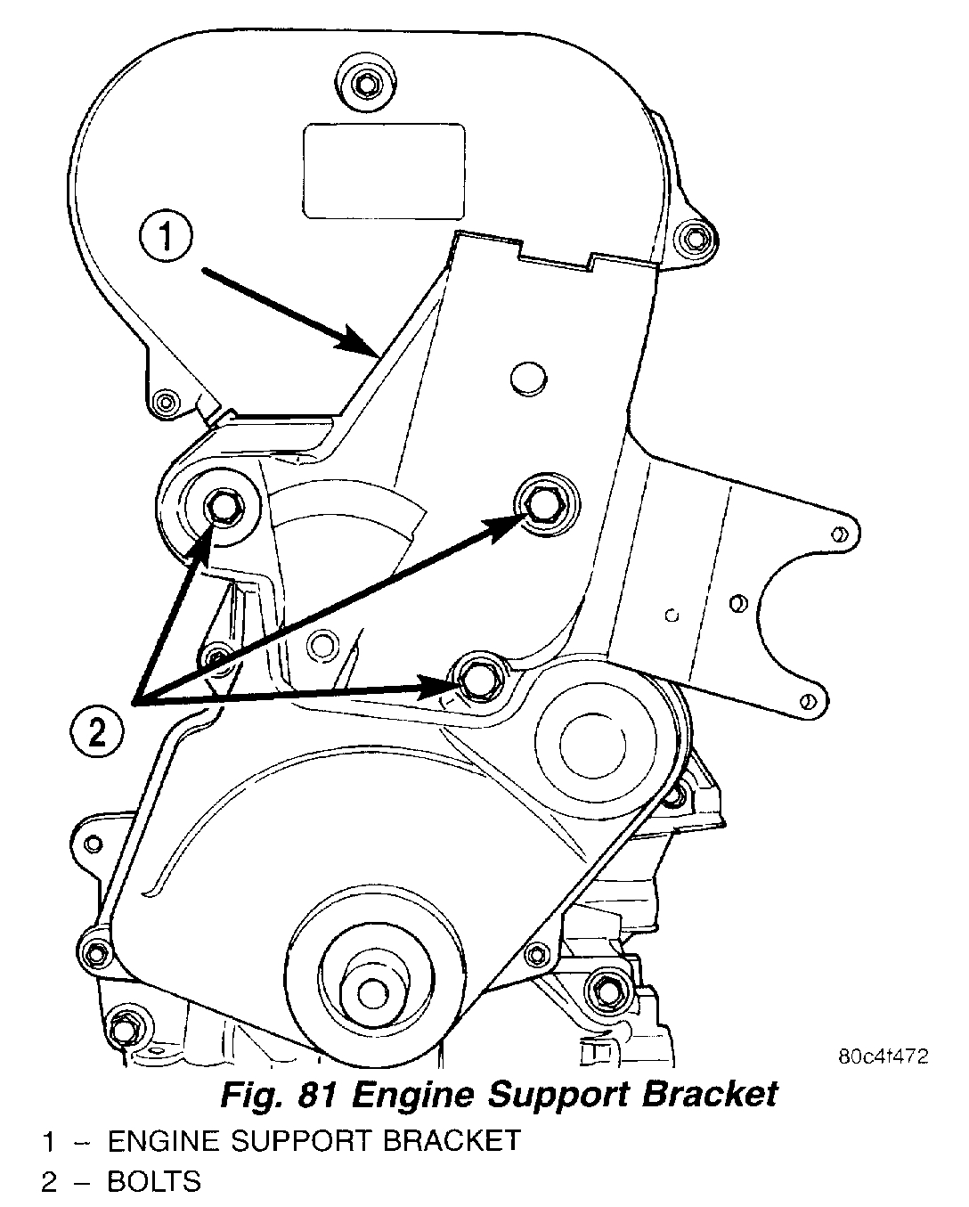

18. Remove support bracket bolts (Fig. 81).
19. Remove support bracket (Fig. 81).

20. Remove upper timing belt cover fasteners and remove cover (Fig. 80).
21. Remove lower timing belt cover fasteners and remove cover (Fig. 80).

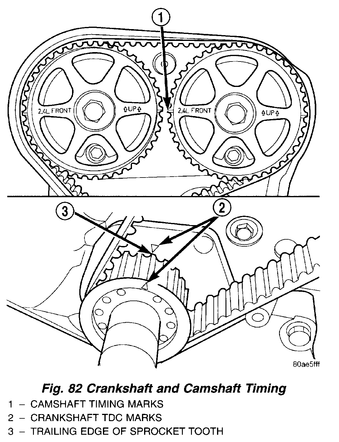

22. Before the removal of the timing belt, rotate crankshaft until the TDC mark on oil pump housing aligns with the TDC mark on crankshaft sprocket (trailing edge of sprocket tooth) (Fig. 82).
NOTE: The crankshaft sprocket TDC mark is located on the trailing edge of the sprocket tooth. Failure to align trailing edge of sprocket tooth to TDC mark on oil pump housing will cause the camshaft timing marks to be misaligned.

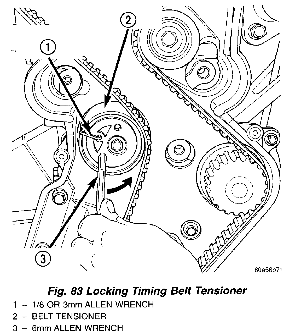

23. Install 6 mm Allen wrench into belt tensioner. Before rotating the tensioner, insert the long end of a 1/8" or 3 mm Allen wrench into the pin hole on the front of the tensioner (Fig. 83). While rotating the tensioner counterclockwise, push in lightly on the 1/8" or 3 mm Allen wrench, until it slides into the locking hole.
24. Remove timing belt.

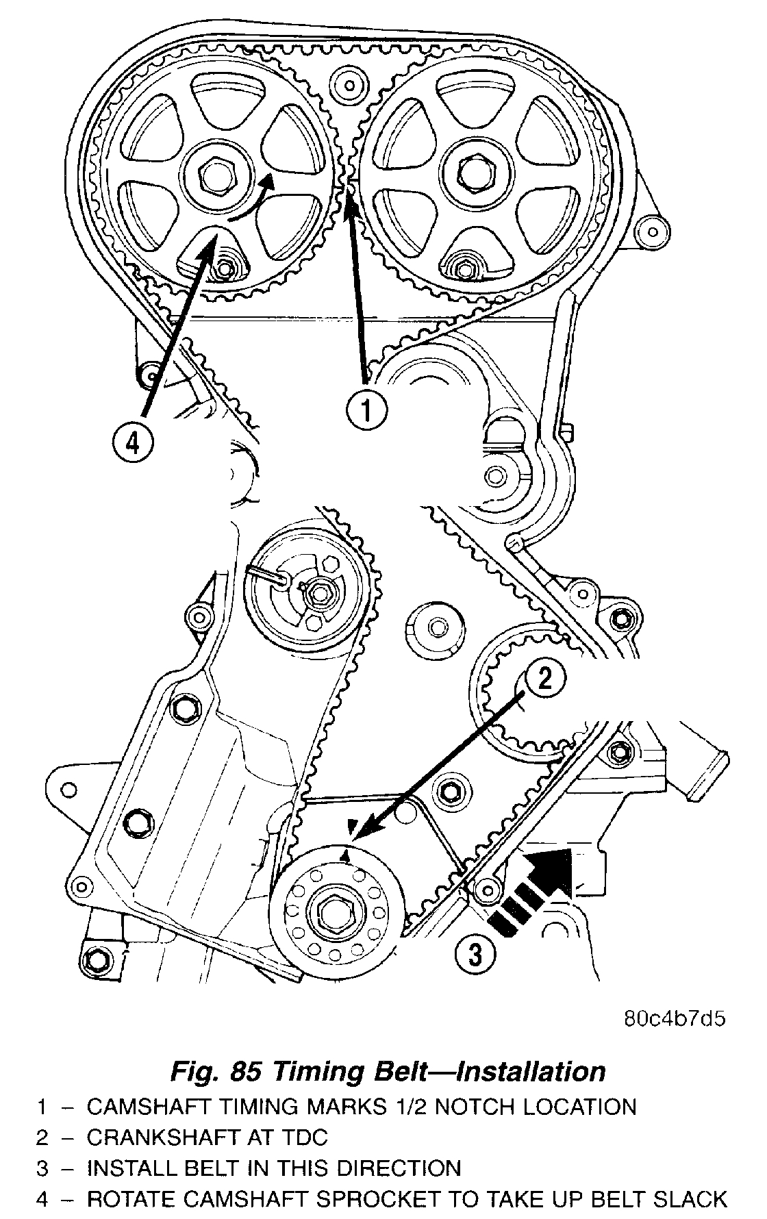

2. Set camshafts timing marks so that the exhaust camshaft sprocket is a 1/2 notch below the intake camshaft sprocket (Fig. 84).
CAUTION: Ensure that the arrows on both camshaft sprockets are facing up.
picture 6
3. Install timing belt. Starting at the crankshaft, go around the water pump sprocket, idler pulley, camshaft sprockets and then around the tensioner (Fig. 85).
4. Move the exhaust camshaft sprocket counterclockwise (Fig. 85) to align marks and take up belt slack.

6. Once the timing belt has been installed and tensioner released, rotate the crankshaft two (2) complete revolutions. Verify that the TDC marks on crankshaft and timing marks on the camshafts are aligned as shown in (Fig. 86).
