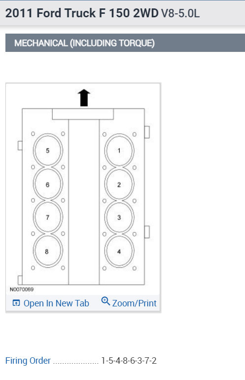

Need a diagram for the truck listed above.
Aug 11, 2023 at 9:13 AM
Experienced Mechanic
55,711 POSTS
Sure, here is the engine firing order for a 5.0 liter engine with the cylinder ID below.
Firing Order .................... 1-5-4-8-6-3-7-2
Check out the images (below). Please let us know if you need anything else to get the problem fixed.
