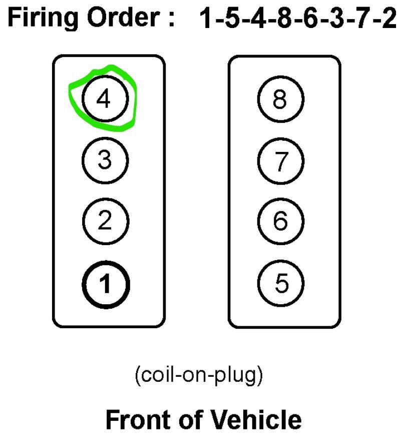

750li Hybrid, standing in front of the car which cylinder is number 4?
Aug 1, 2022 at 12:05 AM
STEVE W.
  • 15,423 POSTS
Standing in front of the car cylinder four is the rear cylinder on the passenger side. If you use the common method of automotive location (IE sitting in the driver's seat and using left and right hand) they count the right bank as 1-2-3-4 and the left side is 5-6-7-8.
