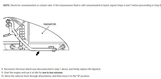

when i start in the morning the transmission works fine until it heats up. At that time when i try to pull off from stop the transmission judders and or slips but when in motion i have full speed no problem. CVT transmission.
Aug 22, 2024 at 12:21 AM
  • 55,433 POSTS

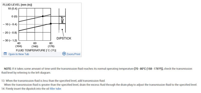

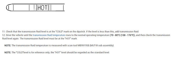

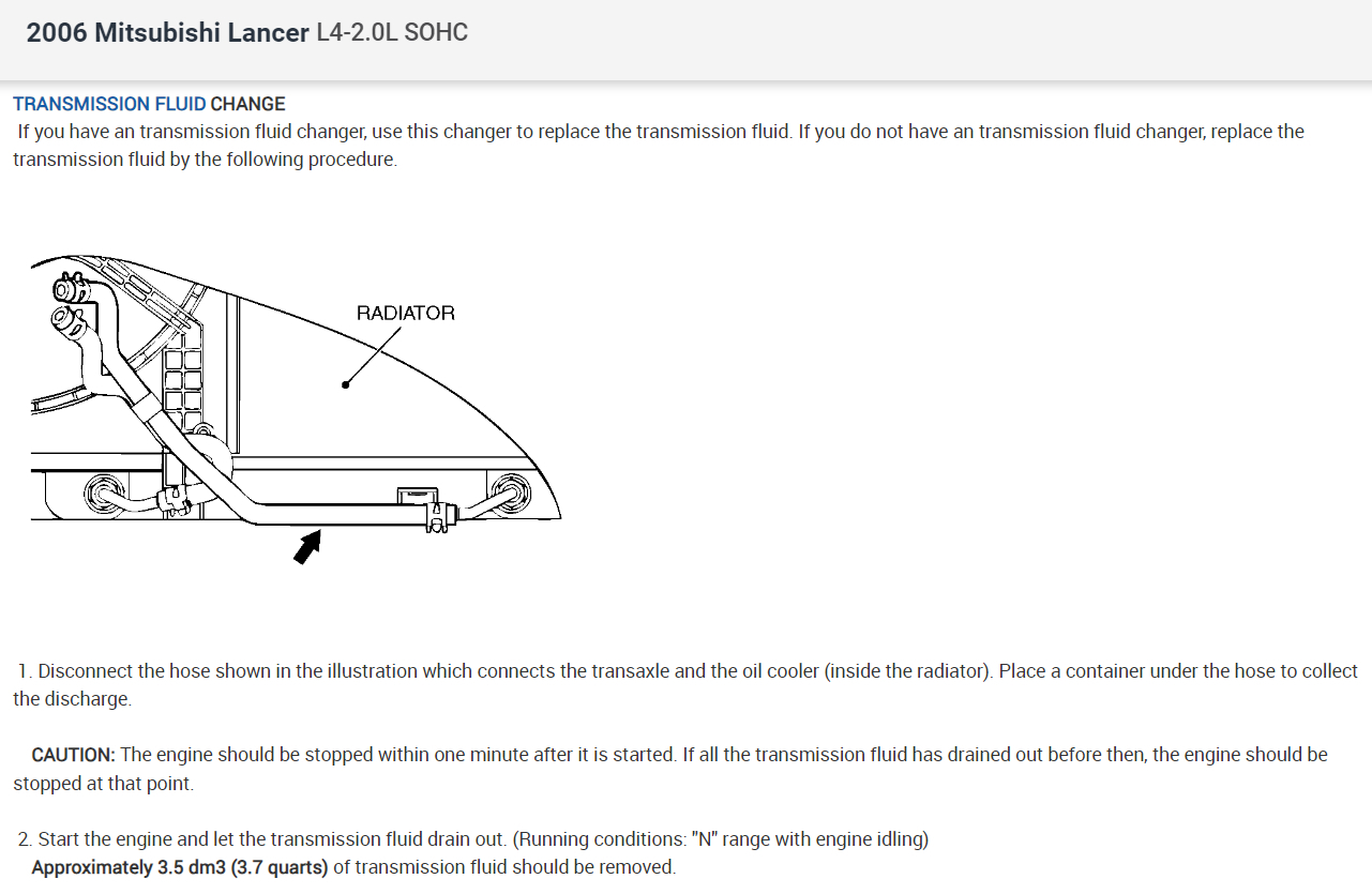

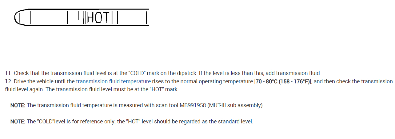

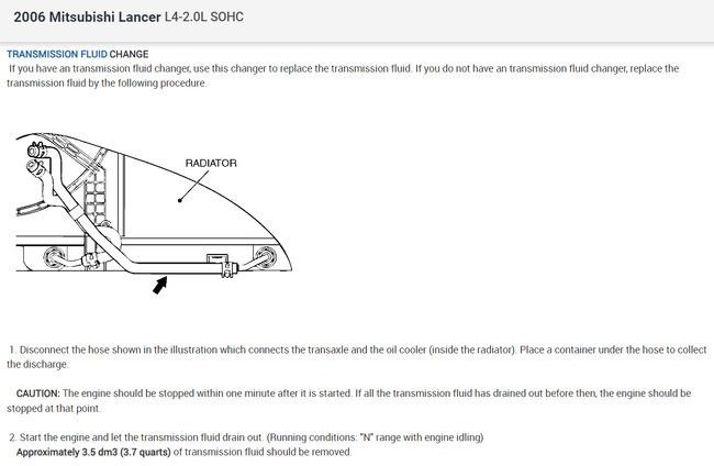

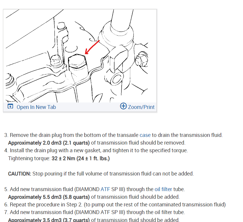

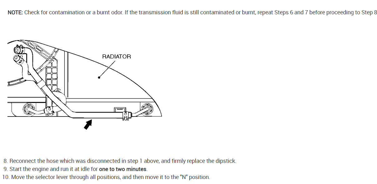

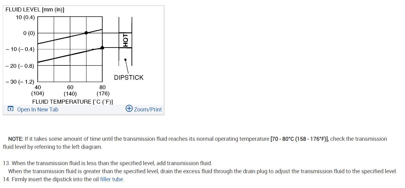

Yep, they had a problem with these transmissions, but you may be able to save it with a fluid change. You must use the CVT transmission fluid which I will list below. Also, is the check engine light on? If so, you may have an input shaft speed sensor that is going bad.
This guide can help:
Fluid Types
Fluid Type .................... MITSUBISHI genuine ATF SP-III
This guide can help walk you through the steps as well:
Check out the images (below). Please upload pictures or videos in your response of any problems so we can see what to help you with.
