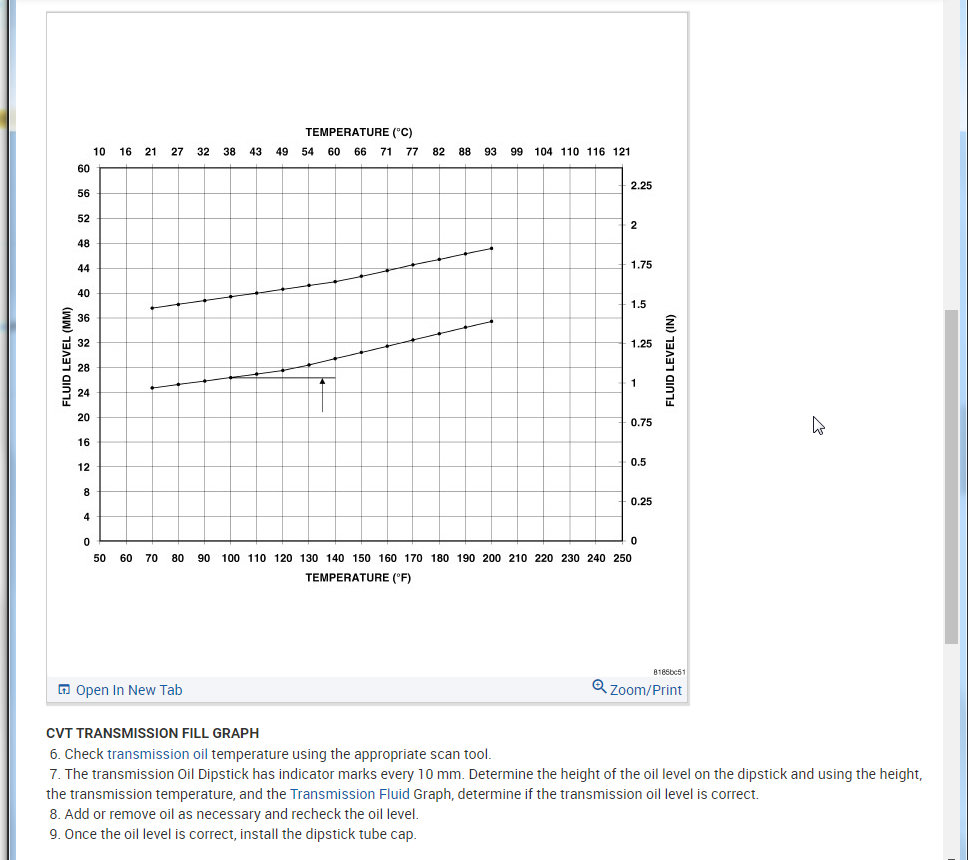

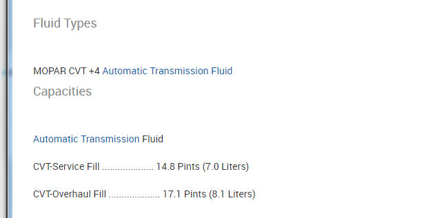

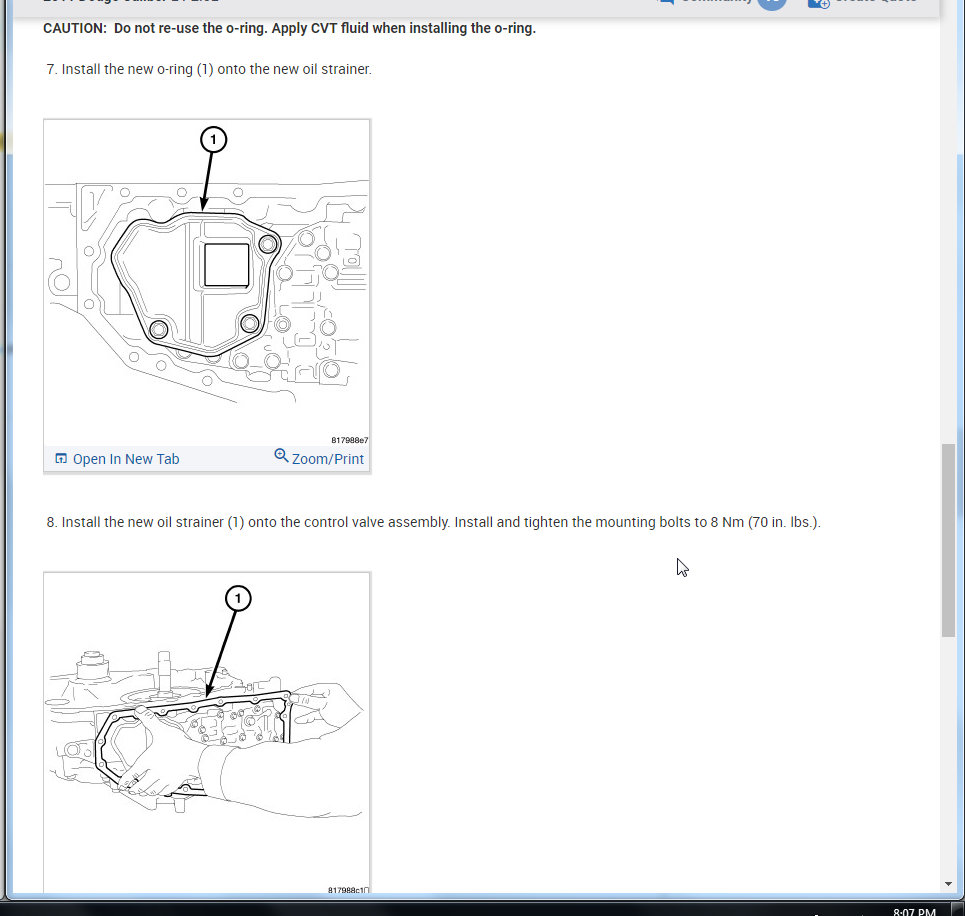

This has obviously the CVT transmission, and they suggest no maintenance by me needed or allowed, but if they sell the pick up filter and cvtf+4 fluid, and pan seal stuff, why can't i just do it myself like i have done for any other cars i have had, not cvt but regular. from all my research it states 7 ltr. any thoughts?
Jun 1, 2021 at 8:48 AM

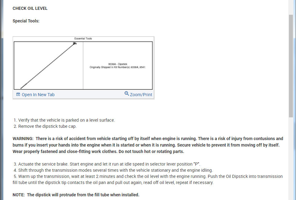

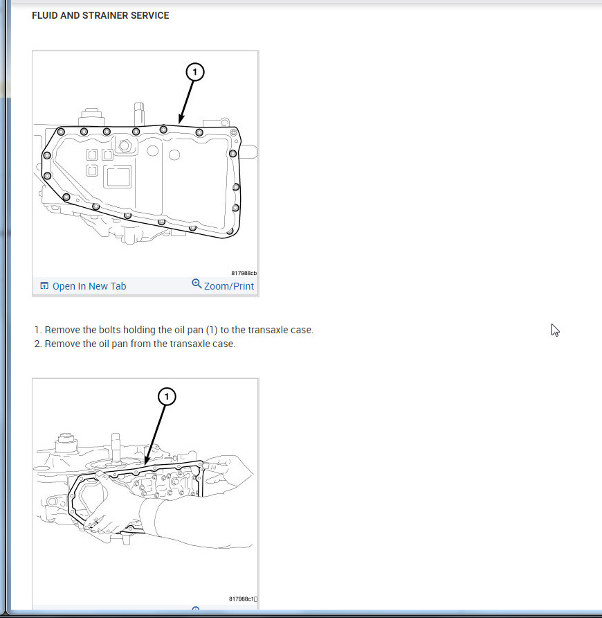

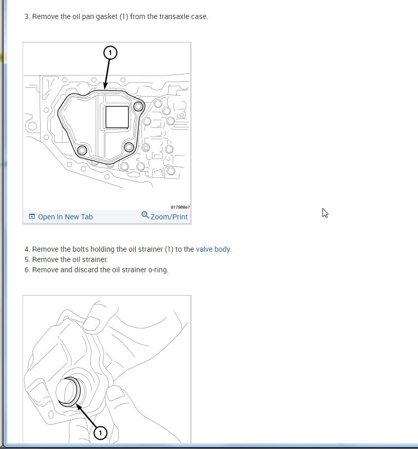

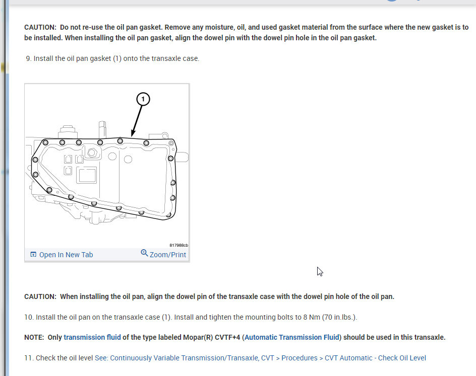

You can service it but it is just not required. However, they sell all the stuff like this because there may be a reason to open the unit to inspect it or replace some parts. If that is the case then you will need to service the unit.
Below is the process from the manual on how to do this including the spec on the oil and amount.
Please let us know if you have other questions. Thanks
Jun 1, 2021 at 10:11 AM
