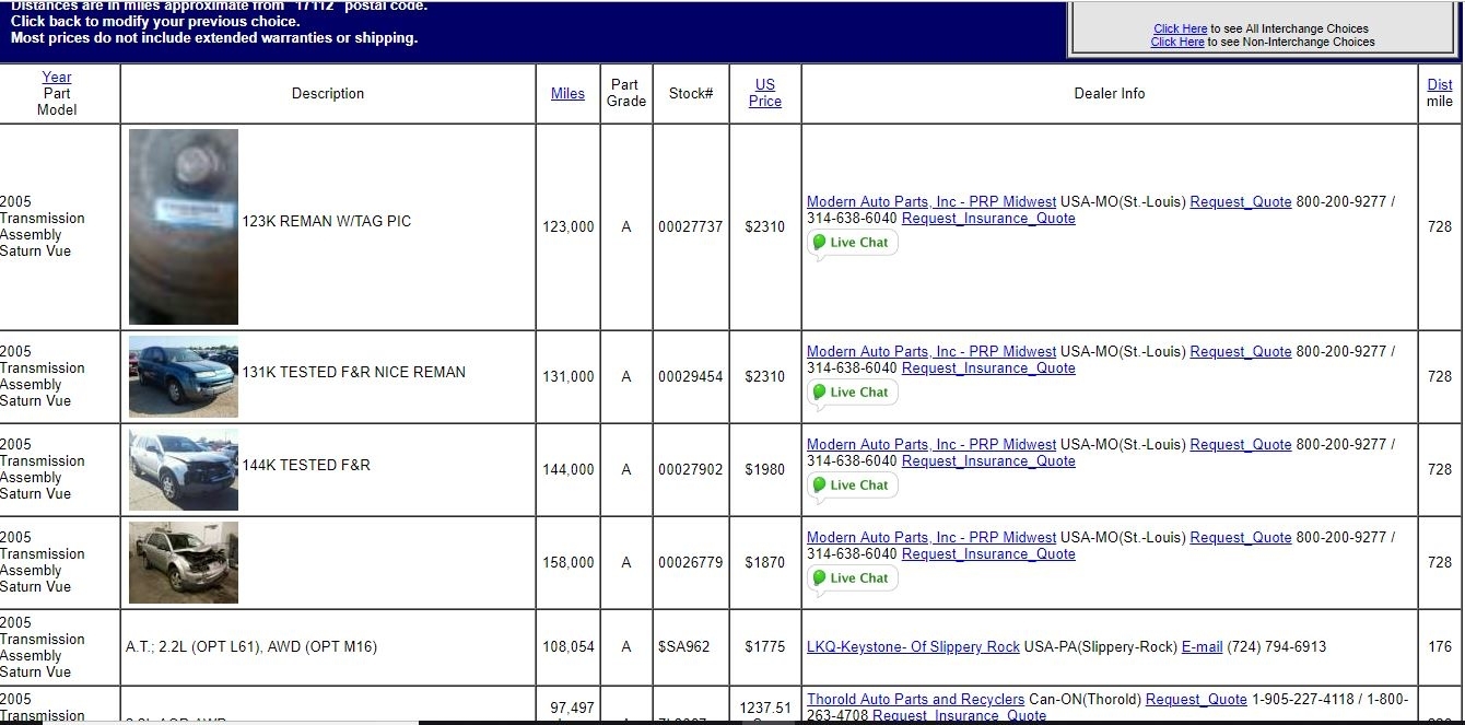

The reason I am asking is I read a reply from Saturn expert and he said he overhauled hundreds when GM was replacing them in the Vue. Also, I do not think there is such a thing as a good used Vue CVT. I know Saturn quit making them for a few months in 2004 so I was wondering if the 2005 was a better CVT?.
Oct 4, 2018 at 10:10 PM
The reason the GM guy was doing it because they had all the equipment and the parts.
Yes, they are out there. You just need to find them.
www.car-part.com is what I used. I bought from LKQ. They warrantied their transmissions. They are pricey but they are good.
