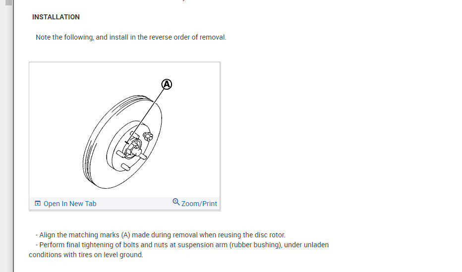

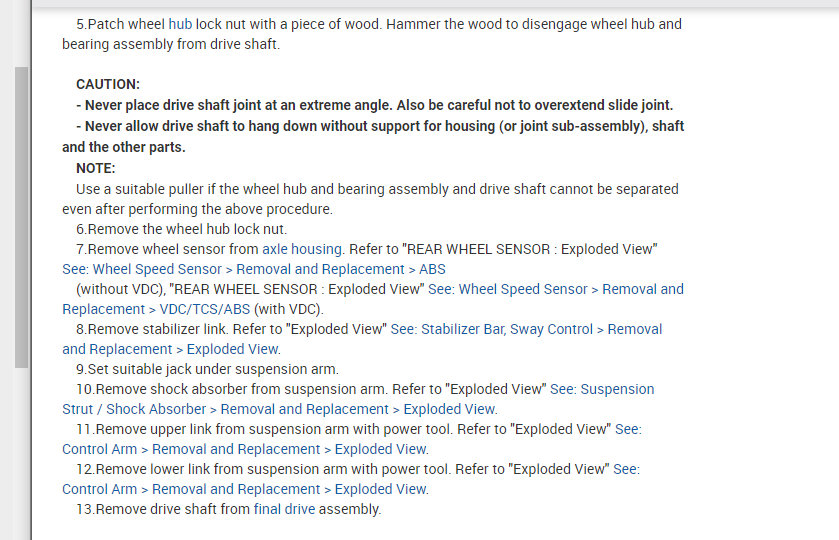

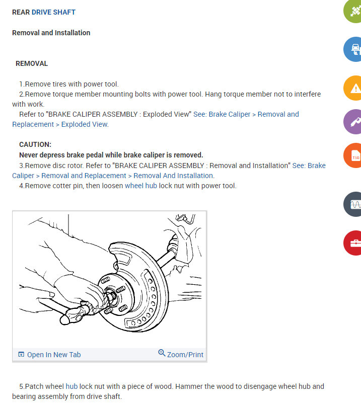

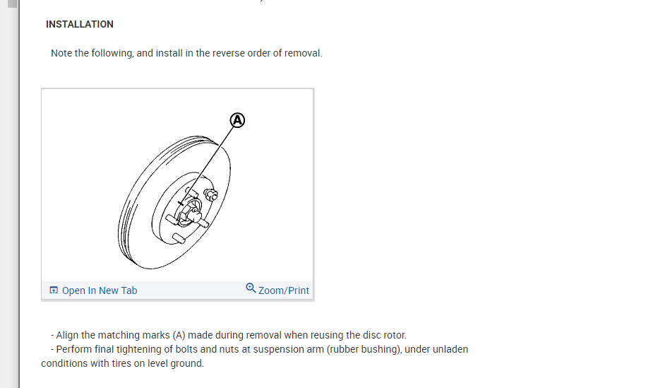

Hi, just wondering when replacing CV joint on the vehicle listed above AWD does the emergency brake cable get disconnected?

Here is a guide that will help replacing this. This is for the front end, but it does have good info with it.
https://www.2carpros.com/articles/replace-cv-axle
I am also attaching the info from the manual below on the rear axles. You need to remove the caliper, but it appears the cable can stay attached.
Please run through this info and let us know what other questions you have. Thanks
