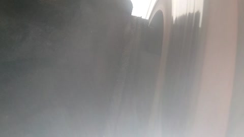

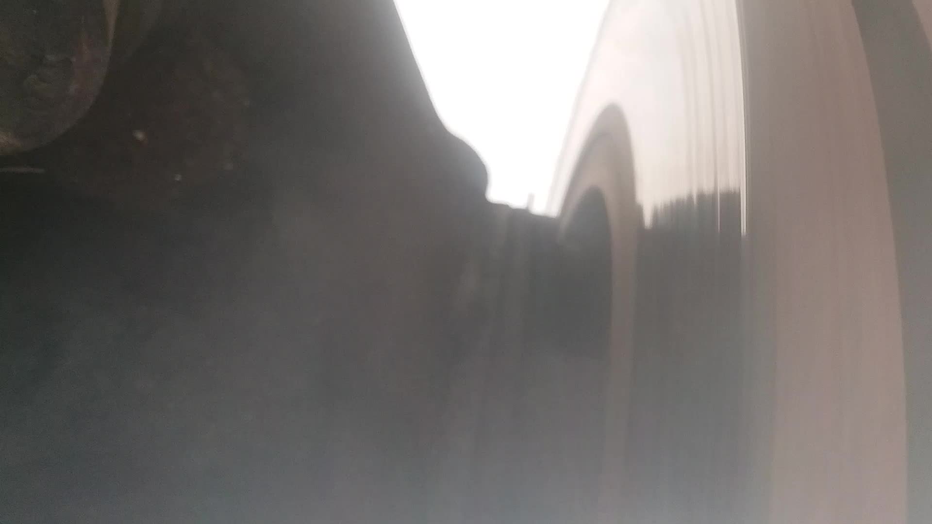

After driving through a flood quite a few things on my car gave me issues, the biggest problem I currently have is that my front driver wheel makes a nasty grinding and squealing sound, even while jacked up and it only going straight. I was told it could be my CV joints but I want to know before I buy anything. Posting a video
Oct 9, 2018 at 9:20 AM
Good evening.
Thank for posting the video. It does sound like a CV joint that got water in it and rust is in the rollers.
I would replace the axle shaft.

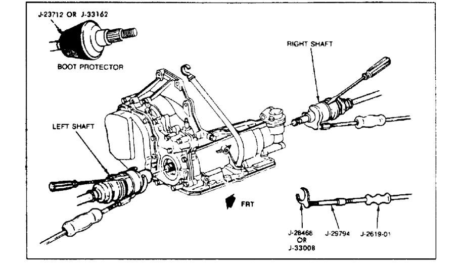

REMOVAL
1. Loosen axle nut and washer one turn.
2. Raise and support vehicle, then remove tire and wheel assembly.
3. Remove brake caliper, bracket assembly and rotor.
4. Loosen four hub/bearing assembly to knuckle attaching bolts.
5. Remove ABS speed sensor mounting bolt, then position sensor aside.
6. Remove hub and bearing mounting bolts.
7. On right side drive axle, separate drive axle from the transaxle using axle shaft remover tool No. J-3308, extension tool No. J-29794 and puller tool No. J-2619-01, or equivalents, Fig. 9 .
8. On left side drive axle, using frame for leverage, separate drive axle from transaxle with a screwdriver or prybar in groove provided on inner joint.
9. On either axle, remove axle with hub and bearing assembly through the knuckle.

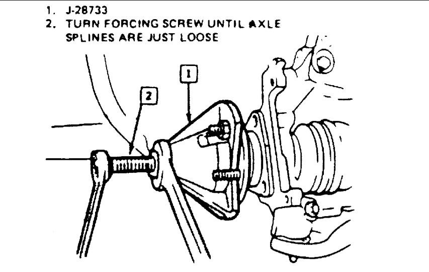

10. Remove axle nut, then separate axle from hub and bearing assembly using separator tool No. J-28733-A, or equivalent, Fig. 8 .
