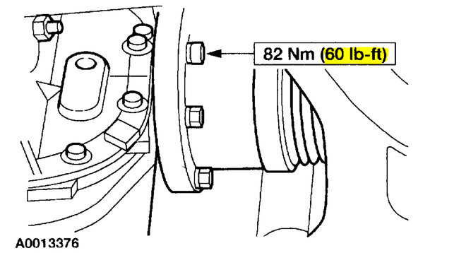

i noticed on my truck listed above Triton that there was quite a bit of play. i looked under the vehicle at the CV joints up front and noticed one was spinning grease out when going down the road because grease splatter was noticeable, but the biggest issue i found is where the CV joints connect to the differential and is bolted on are loose in that area. That side is leaking grease more than the other. is it normal to be loose in that area and what has happened to make it loose? it's where it bolts on to the front differential. I have the truck listed above with a Triton engine 4.1L. I noticed a lot of play from the front and a little noise, so after looking I saw the inner CV joint housing was loose on the driver side. I saw some grease had come out to the housing was very loose. I checked the passenger side and the housing was just a hair loose no grease. So, I took it to a mechanic to get it looked at he said, he didn't see anything wrong with the axles, just said don't let the one that had grease coming out to go dry and he said the play and the noise was part of the differential, and that he doesn't work on differentials. So, I was assuming id need a new differential. I'm not sure well got to pricing them, yeah, outrageously high and most of the mechanic I go to prefer to get their own parts, so it would be new. I'm not sure if it's just the housing where the CV joint bolts on to the differential. Then do I need a new differential? Never the less I spoke to another mechanic I know and assuming the whole differential needed to be replaced I asked him can I just turn this 4 wheel drive into a 2 wheel drive he said, yes, it would be easy that was going on the assumption I needed a whole new differential. So, the question is, do I need a whole new differential or would it be cheaper for the time being to convert it into a 2 wheel drive I'm assuming again by taking the CV axle in the front out and taking the shafts out I don't know any input on this?

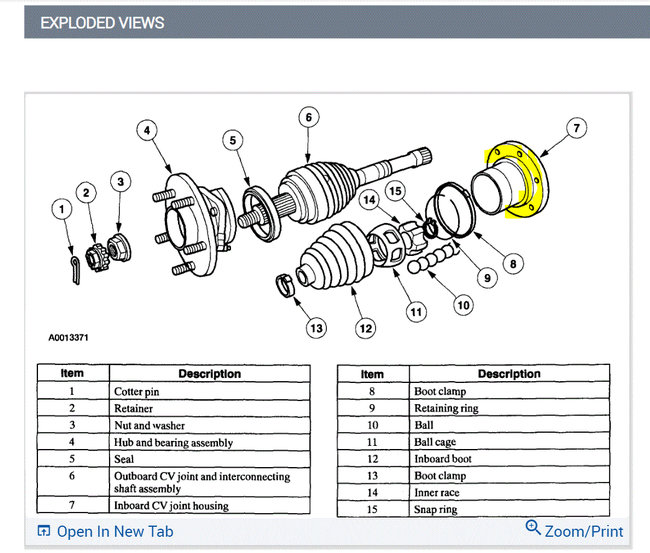

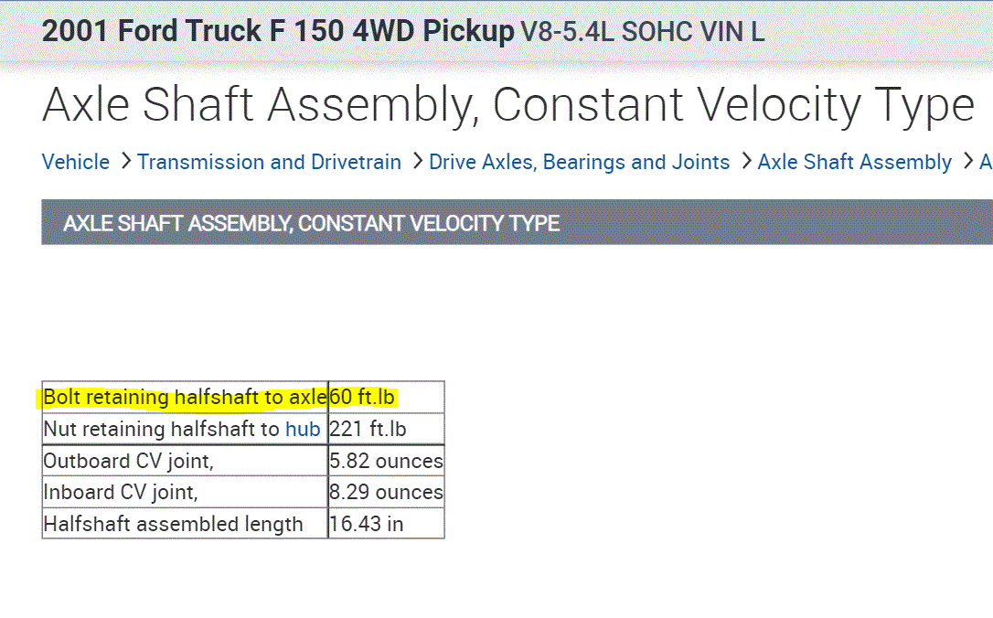

Is it the component that is bolted in place? See pic 1 below. Is the highlighted area where it is loose? If so, you really need to tighten the bolts on it. I attached the torque specs in pic 2.
If that isn't where you are noticing play, see if you can find the part in pic 1, and let me know what it is. Also, if you can record what is loose and upload it for me to see, it will be helpful.

It is part number 7 that's highlighted in yellow its loose on one side and losing grease the other side is just a little loose but no grease coming out of the axel. The side that is very loose would be the driver's side. i can get under it and push up and down on it and it moves. What part is that? i can also hear it when i put in gear or hit a bump, i can feel it kind of bumps under the wheel where it's loose at.

Number 7 is the inner CV joint housing. If that is where the play is coming from, the joint is likely faulty or the six bolts holding it onto the differential are loose. Is it possible for you to record the play and upload it for me to see? Also, make sure the 6 bolts are tight. (See pic below). You don't want the drive axle coming off the vehicle.
See pic below.

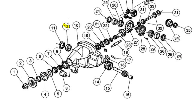

I'm not sure what to say. They told you the play was from the differential. Did they mention anything about the axle shaft bearing?
See pic below.

No Joe, and that's the thing about it all they basically didn't do a whole lot to help me and then charged $78.00. but by talking to you i have been able to better identify the part with the issue, of course the guy was trying to work me in the schedule so i got another guy lined up this morning. i know this guy better only took it to the first guy cause he said he could go ahead and get me in and the number 7 part the inner CV joint housing is more less a chunk it has gears inside of it and its loose those gears are probably worn by now i was pricing them they are pretty expensive that's why i was thinking for the time being if i didn't have all the money just to make it safe maybe temporarily convert it to 2 wheel drive as a last resort it wouldn't hurt it i don't think but I'm hoping to get it fixed right today.
